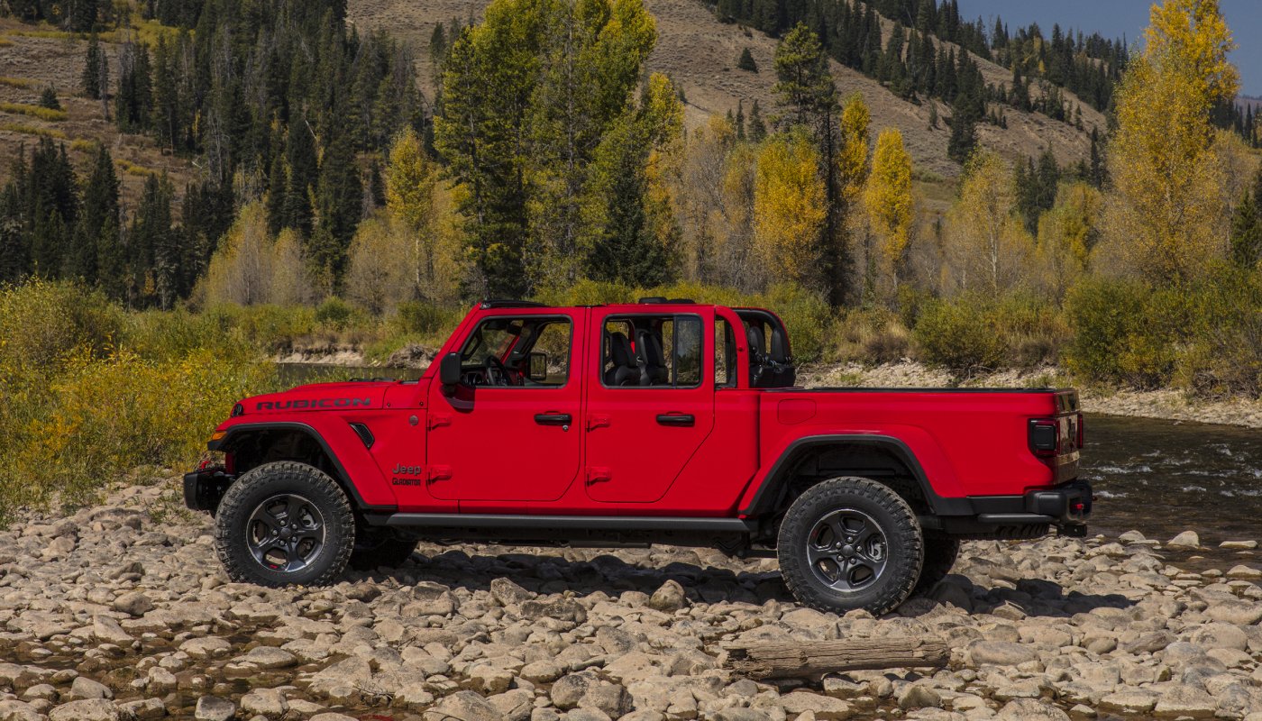

The Gladiator seems to just be a Wrangler Unlimited, but with a tiny box on the back. The only one that remotely interests me is the standard cab model, but I already have a Wrangler. I don't see anything about it that makes it some kind of fantastic breakthrough that we all have been waiting for. It's a slightly altered Wrangler and it is only 44" inches between the wheel wells. Good for bringing a can of paint or some groceries home, or taking a bicycle to the trail on Saturday morning. For four wheeling the departure angle look bad. Another thing is funny: the towing capacity of a JK Wrangler Unlimited is 3500 lbs and this Gladiator is rated at, I think, 7,650 lbs. Hmmm. Where did twice the capacity come from? And towing that kind of weight with a Pentastar would not be very much fun.

the rear suspension is pulled from a Ram 1500, and 19" more wheel base
