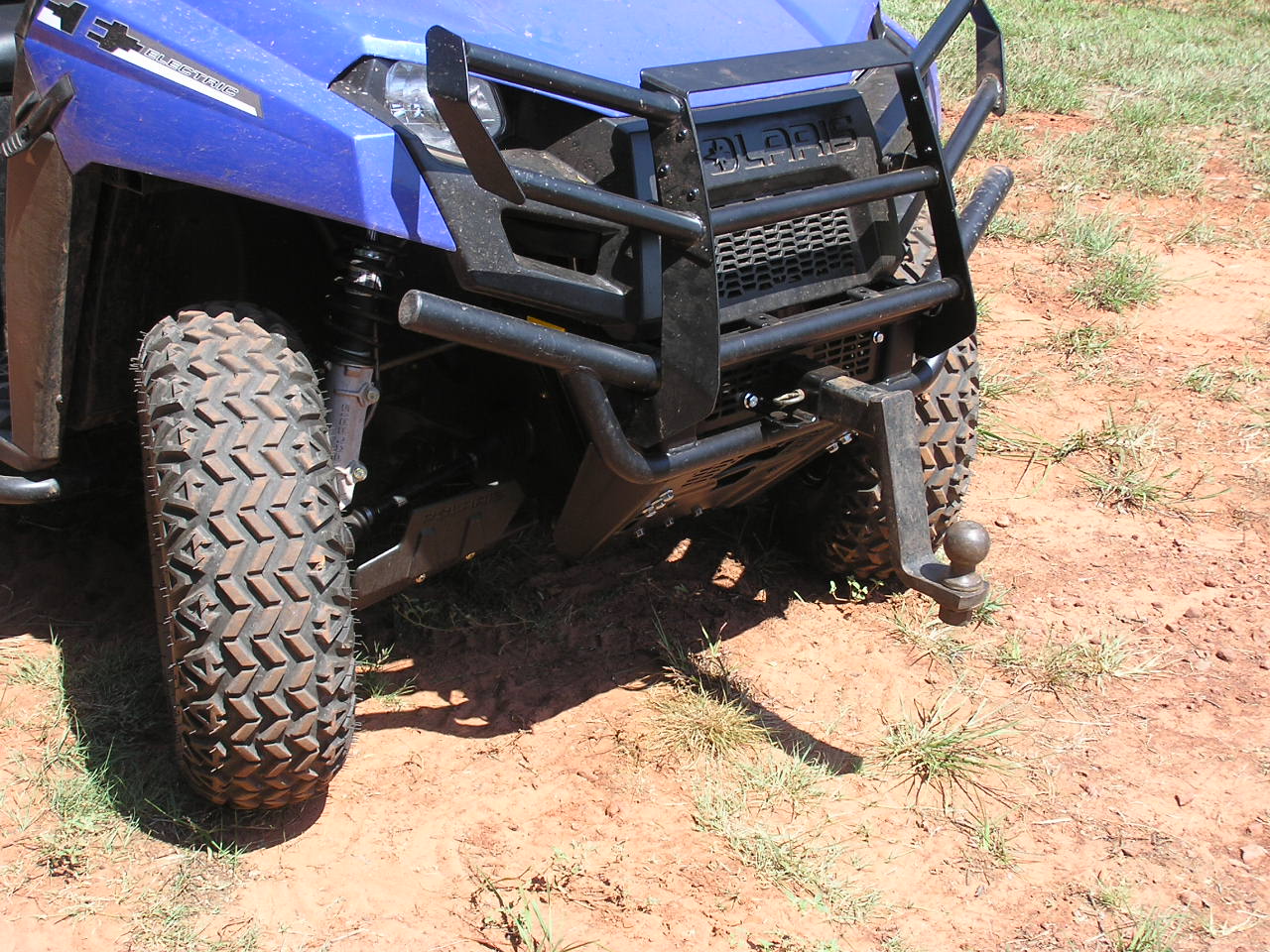

Been having trouble lately with a rear tire on a Ferris IS500Z mower. Slimed it but it still keeps going down. Never cared for the traction anyway. Anyone have a source for a bar or chevron type tread in 20X10.00-10? Haven't found much on Google yet.

The way to read the tire size is: Tire Diameter x Tire Width - Wheel Diameter.
You have 10" wheels, and the tires you listed are for an 8" wheel.
Here's a link to a place that has some 20x11-10 tires with a more aggressive tread. They are mostly 'knobby' type tires as opposed to tractor tread but should give you a lot better traction than standard turfs.
Discount UTV Tires ATV Tires and Wheels - Search Results for "20x11x10" - ATV UTV Tires
Being 1" wider should not pose a problem unless your tires have almost no clearance now.

Well, the Carlisle ALL TRAIL II's are mounted and on the Ferris. Now all that remains is for the grass to dry enough to give them a try.
Thanks to OB for the idea of trying an ATV/UTV type tread.
   / 20x10.00-10 Bar Tread #8
They have good traction, but I hope you don't have to drive across any gravel. I have the same tread on our Ranger EV and it picks up gravel like a magnet picks up steel.
