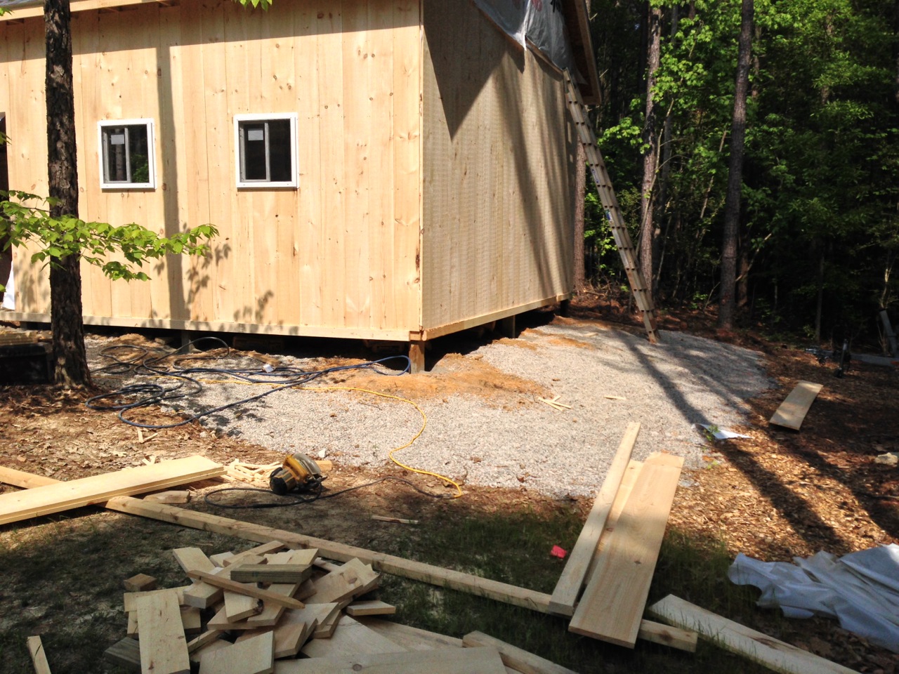

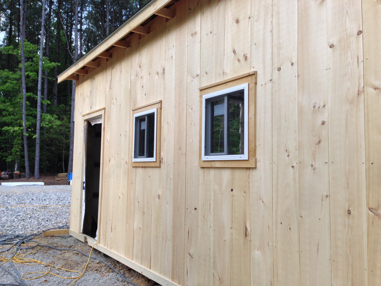

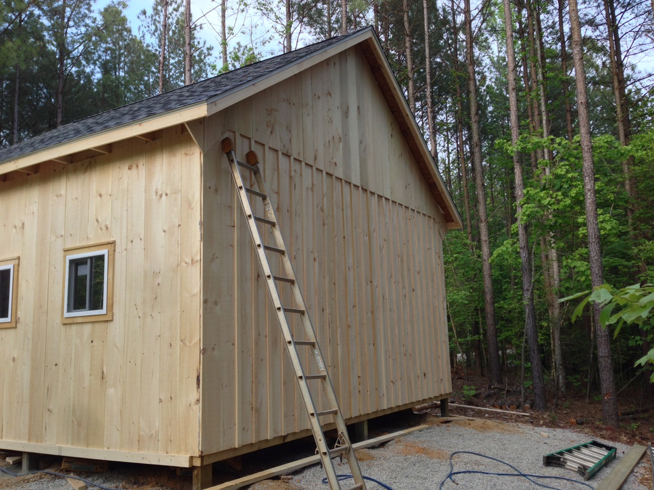

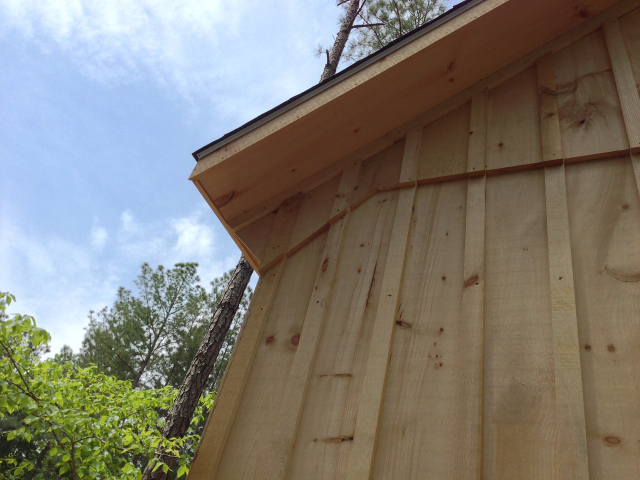

I added 1-2 rows of 2x6 lumber below the main skirt to fill any gaps, then cleaned up the grading around the barn, raking material just up to the bottom edge of the skirt boards. I ended up quitting early, since the biting flies were out in force, but was able to finish up before we got deluged by rain later in the day, which is good.
When we pour the floor slab, we plan to also pour down behind the skirts (from inside). This will contain the fill bed under the slab without putting direct pressure on the skirts (I'm told that for tall skirts, settling fill could otherwise bow the skirts and wall out over time).

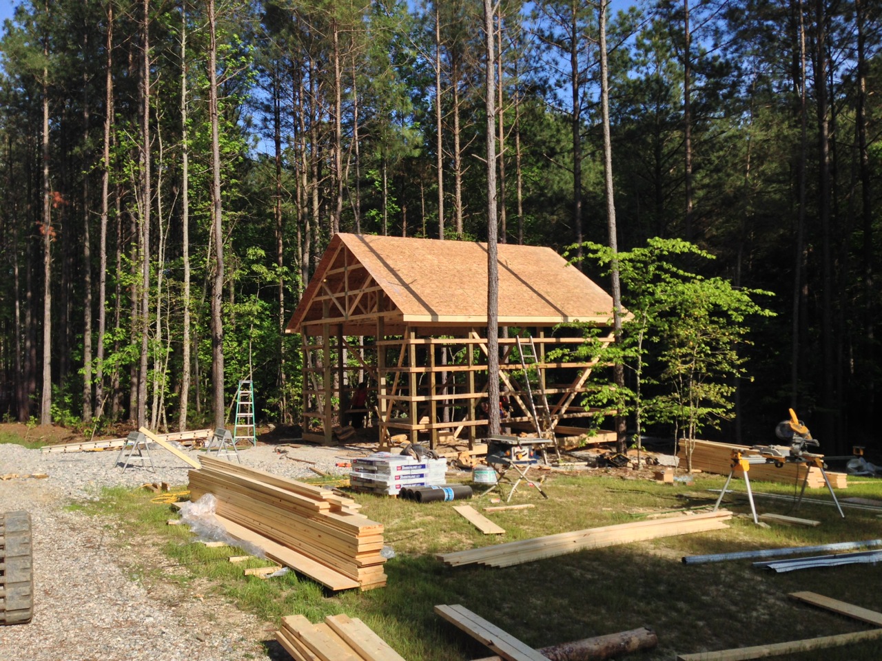

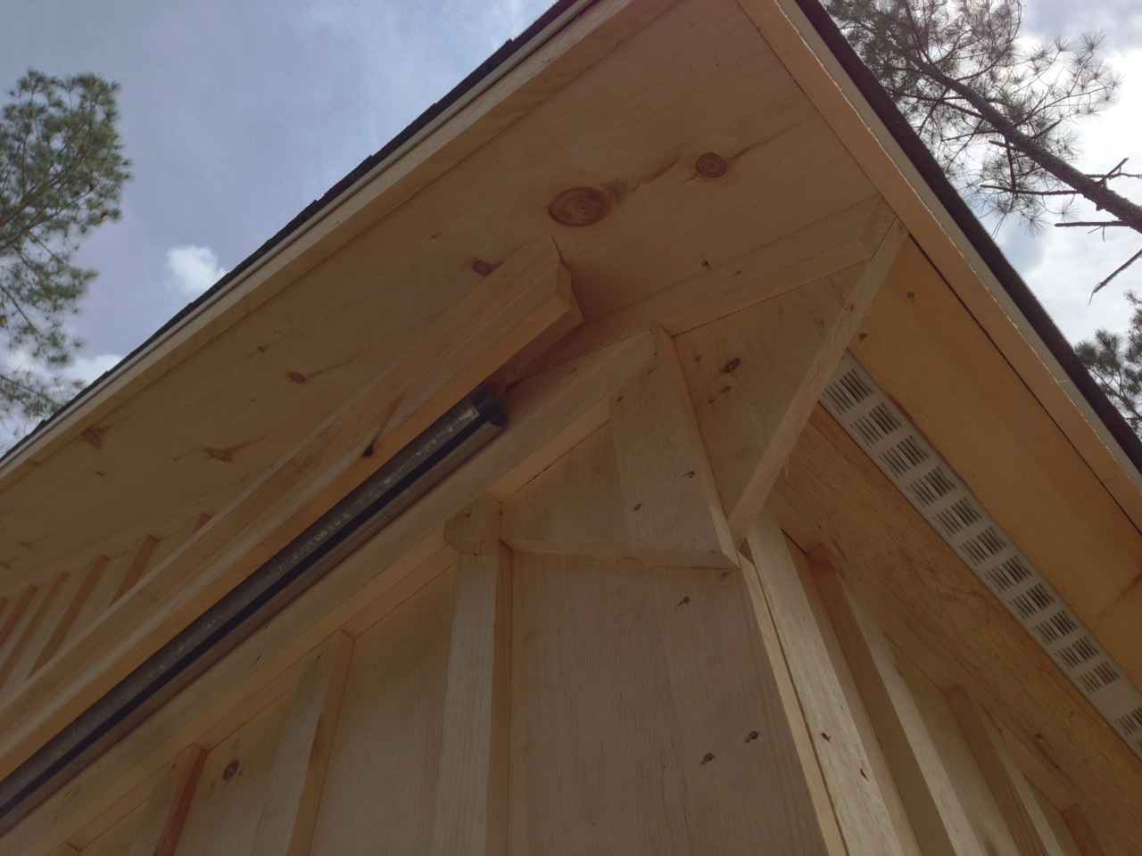

Here are a couple pics of the finished barn, minus doors and floor:

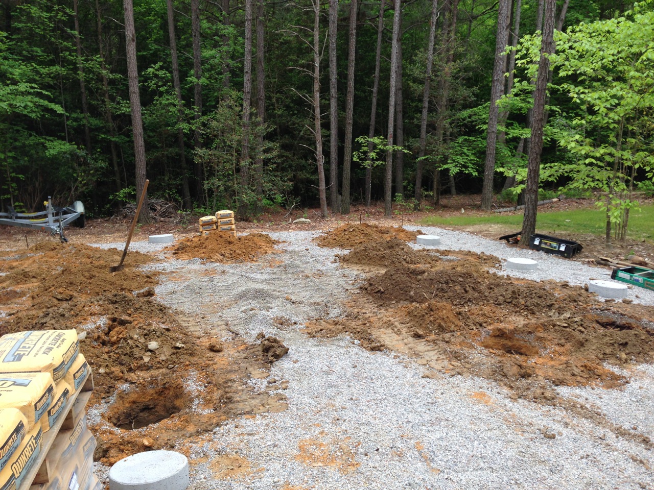

I plan to level the dirt inside the barn tomorrow -- there are 12 piles of spoils from drilling posts, and they need to be knocked down and spread out. Then the soil will be compacted with a plate compacter, and additional gravel will be brought in to get up to floor level minus 4".

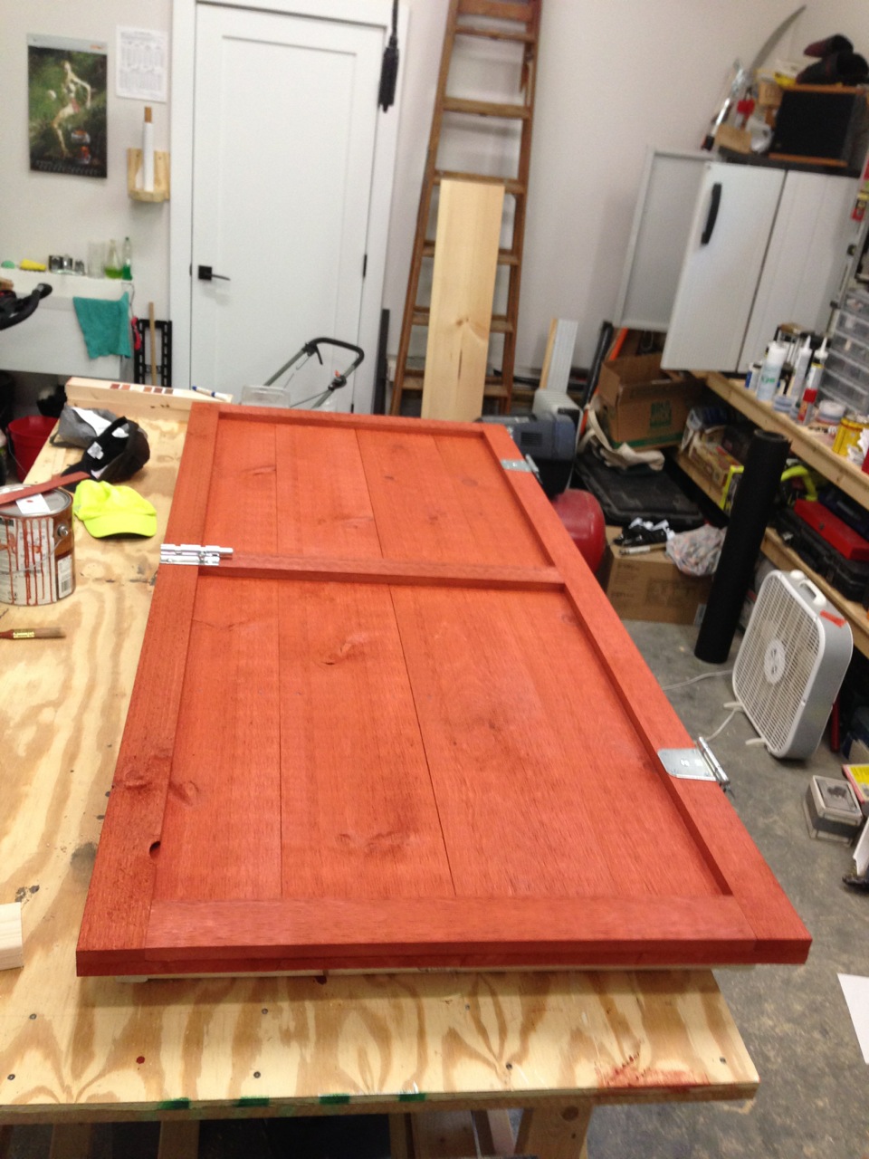

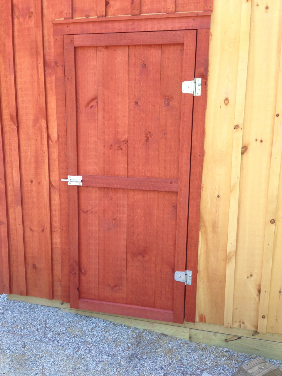

Progress has been slow but sure. I got the entry door built, fit, and stained. Will be installed tomorrow (mainly to free up my workbench for the sliding doors). Will stain the barn siding as time allows over the summer, using Sherwin Williams "Woodscapes" stain, Redwood color, two coats.

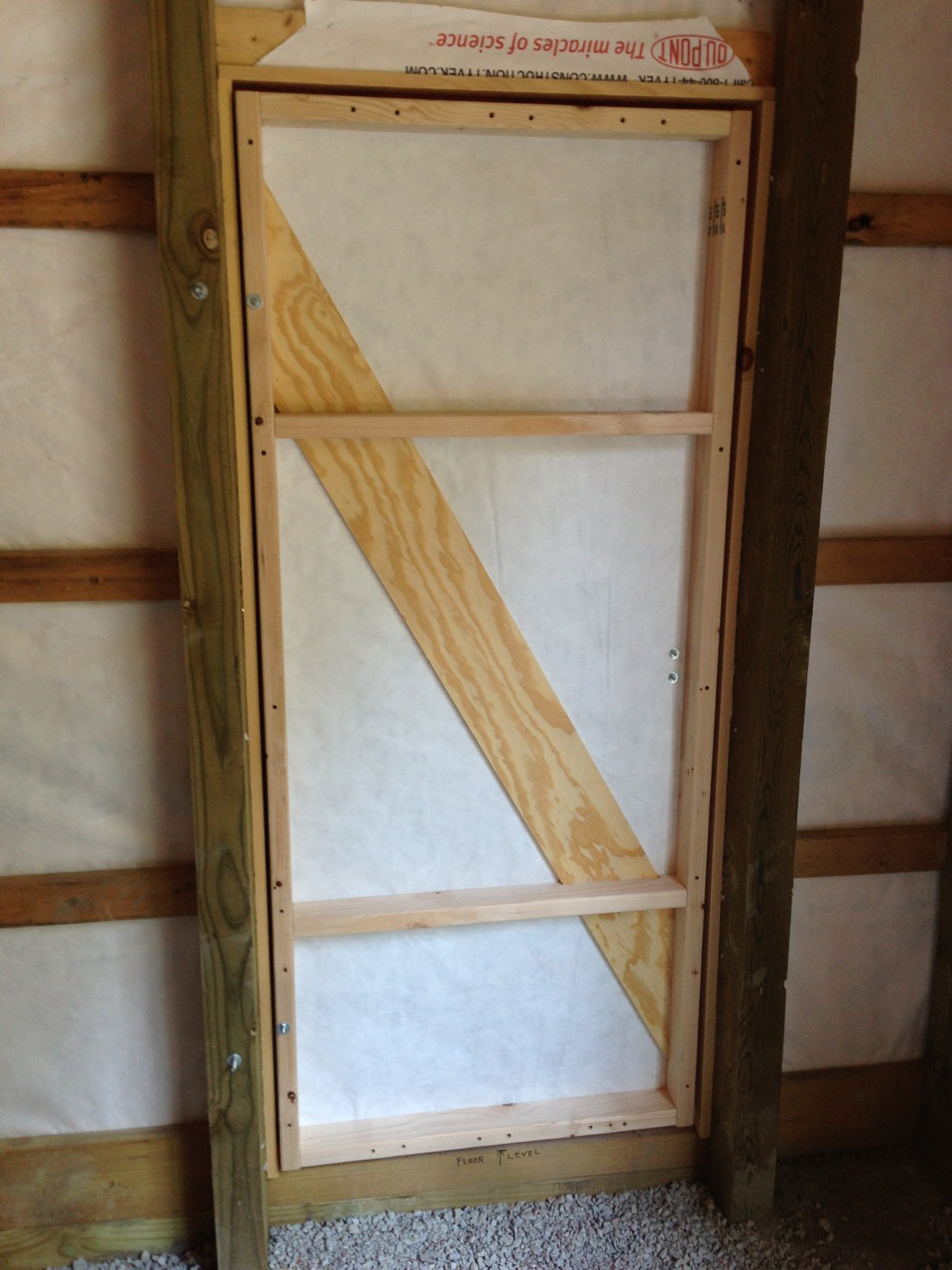

I lap jointed the door's siding boards, screwed in trim pieces from behind, and then attached the door panel to a 2x4 backing frame with plywood diagonal. That should prevent all forms of warping, twisting, and sagging. Feels like a vault door! If a tornado ever strikes, I imagine the door will be the last piece standing....

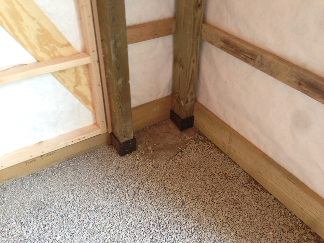

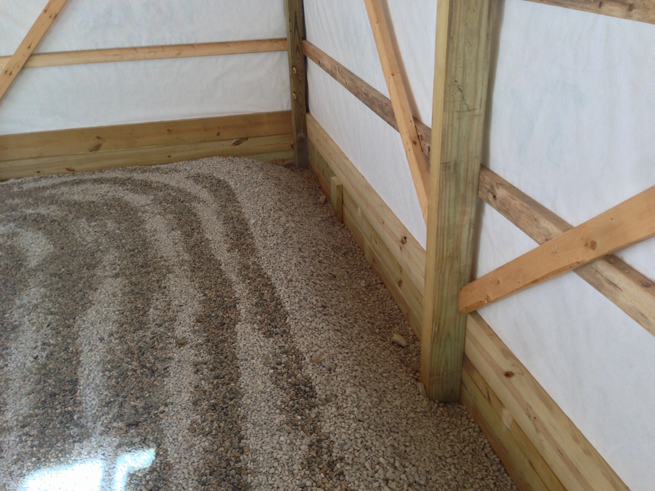

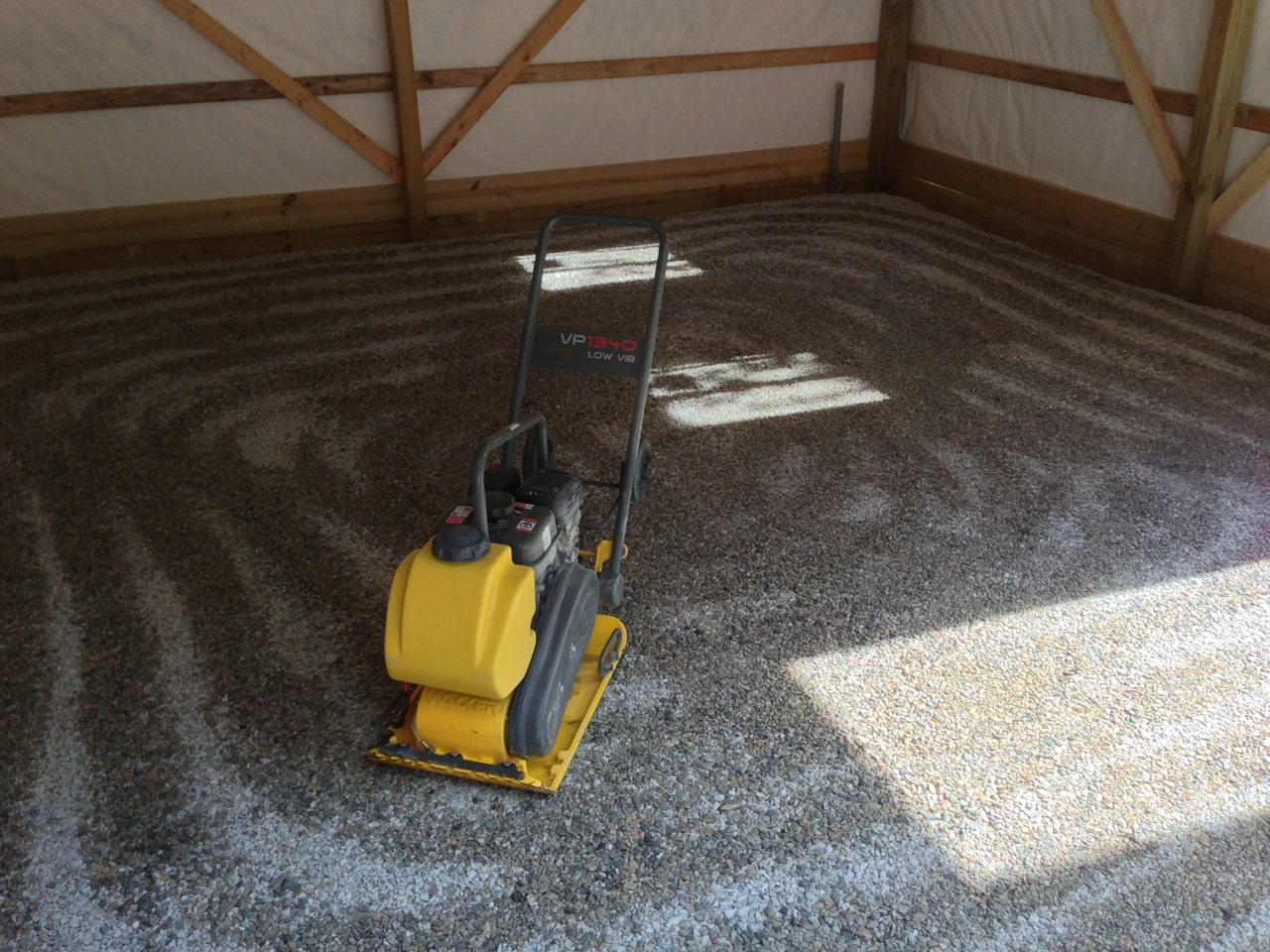

The gravel fill bed has been layered and compacted several times. Today I tweaked the grade to allow a 2" slope back to front, and compacted again. Next I will dig out and form up for the thickened edge at the front door, put down some poly for vapor barrier, then chairs and re-bar at that thickened area. Concrete should be coming next week.

Door is up and swings real nice. Very rigid.
(That's one coat of stain on the siding and two coats on the door in that second picture).

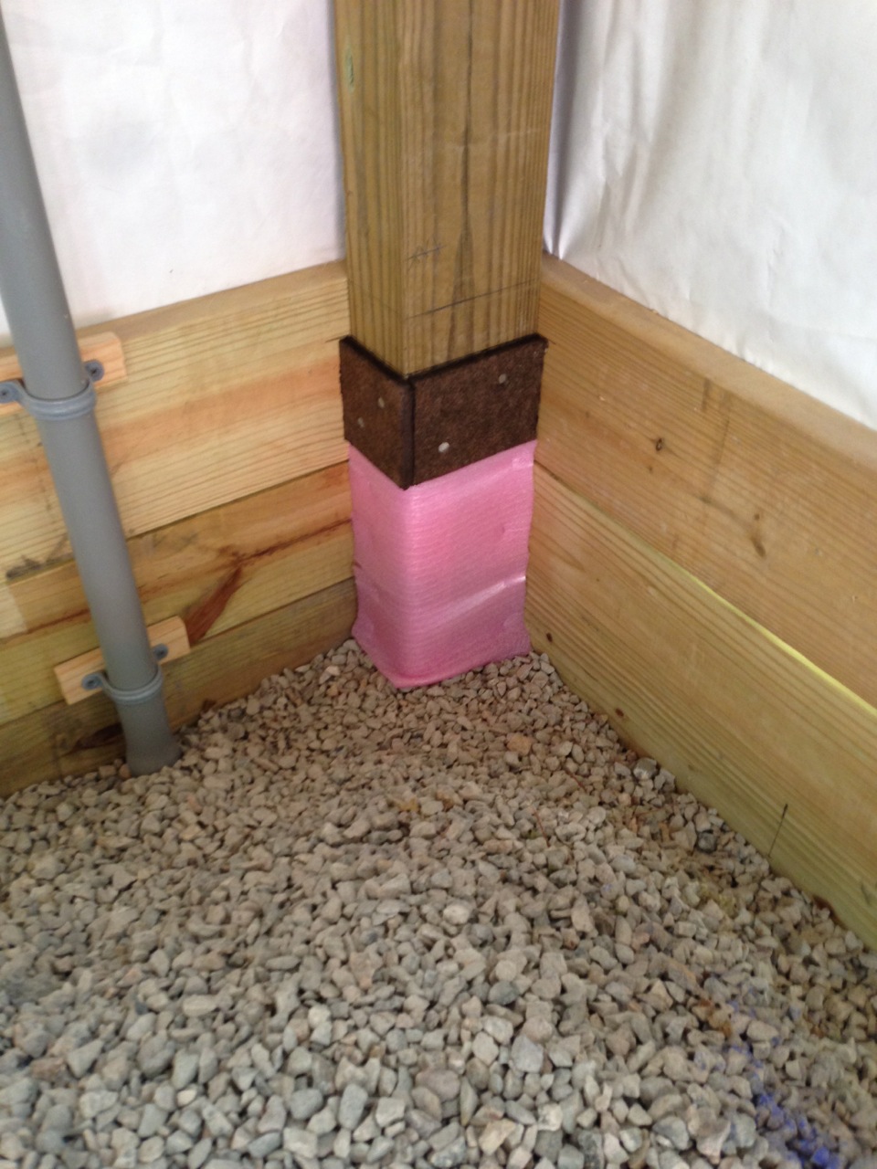

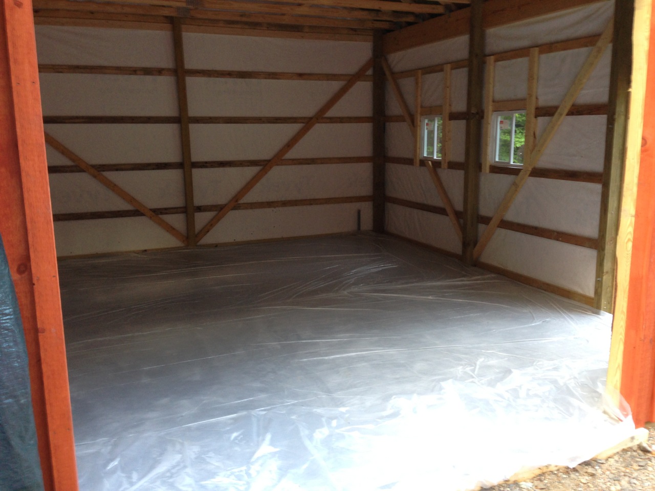

I put in expansion strip around posts, using standard felt/tar strip on top and a couple wraps of foam sill plate insulation below:
And put in bracing along the back and sides to keep the skirt boards from bowing when we pour the concrete:

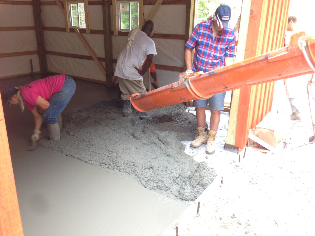

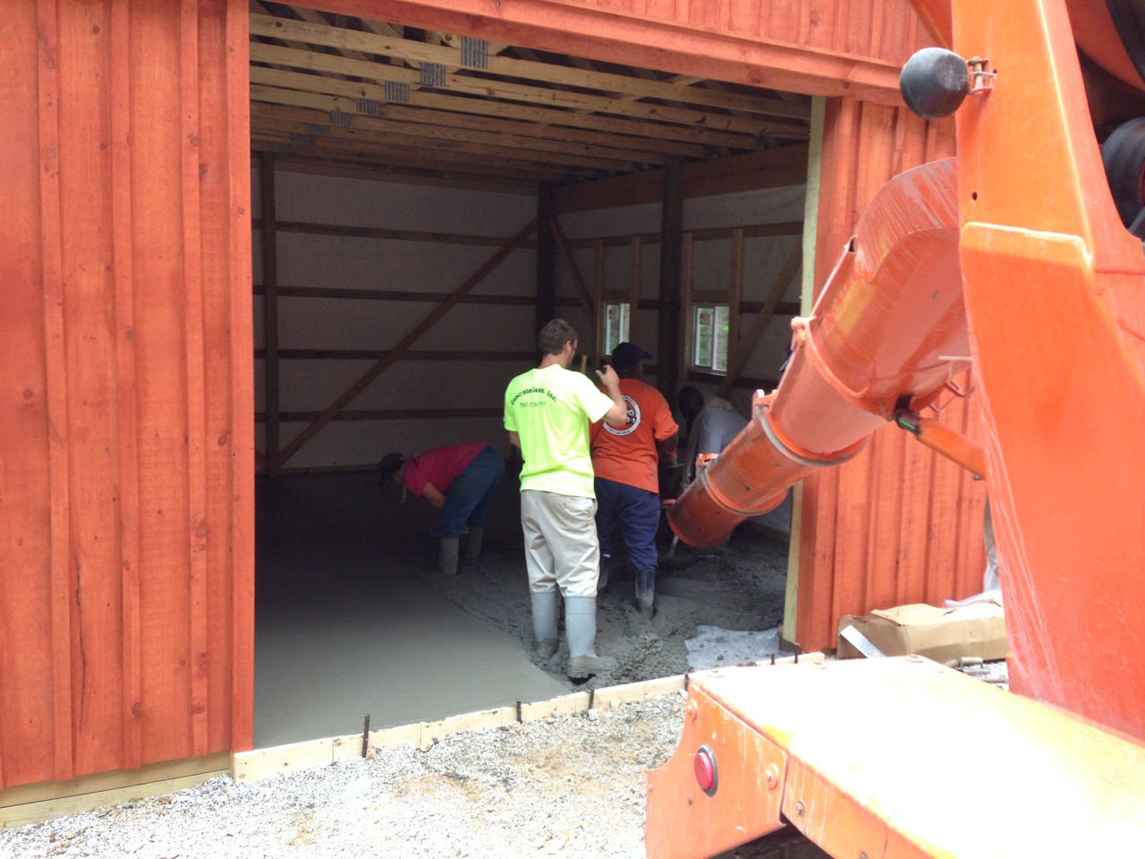

Concrete floor was poured last Wednesday. After going through a lot of trouble to line up a concrete guy, he bailed a couple days beforehand with a real weak excuse. Luckily, another contractor on my list had a cancellation and worked me in on short notice. They were a little pricier, but did real nice work.

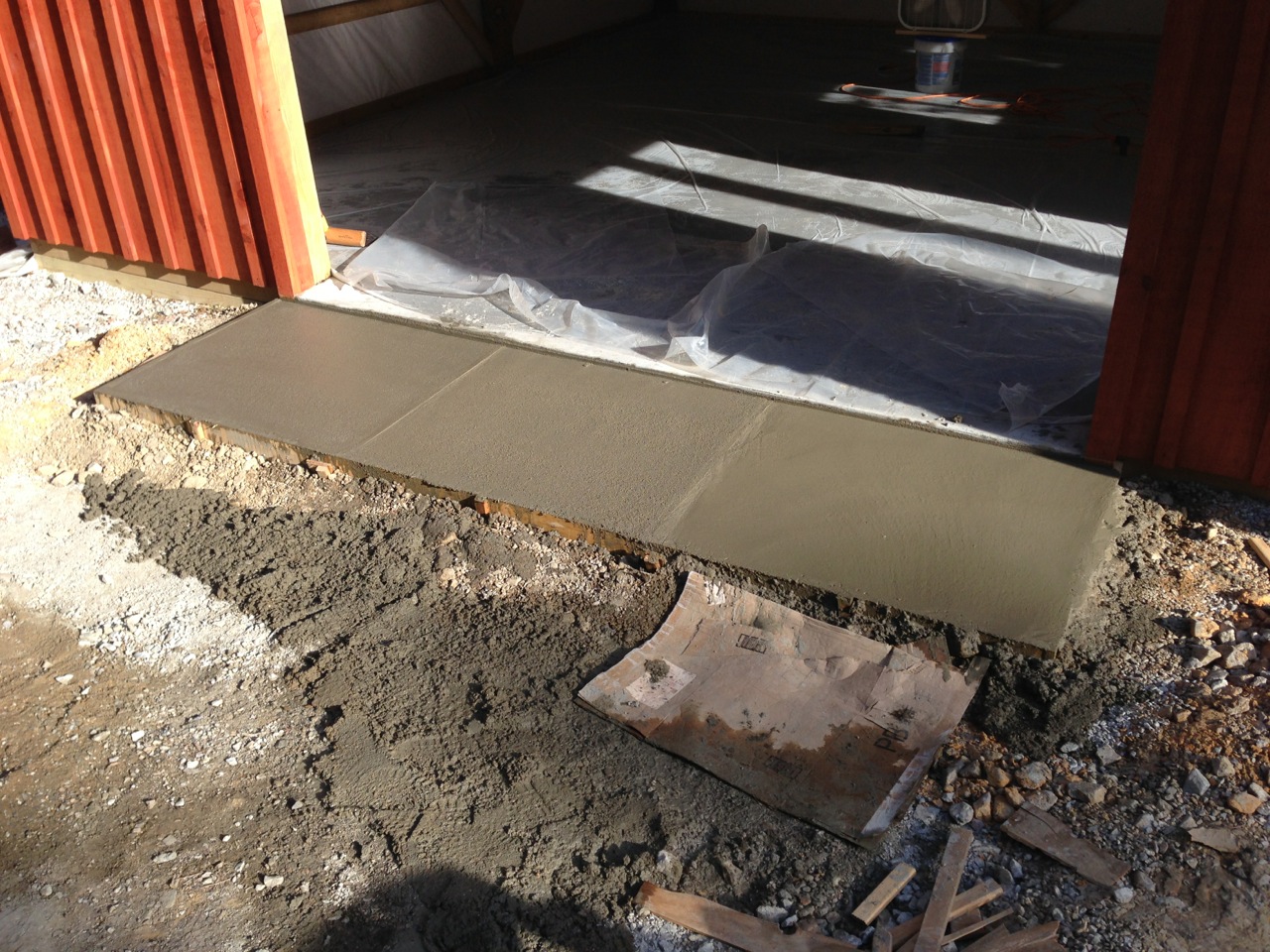

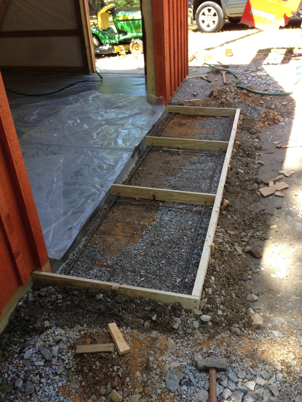

Yesterday, I did the apron outside the opening, to use up about 20 sacks of quick-crete leftover from setting the posts. Boy did it get old mixing that much concrete manually, but the finishing work went well.
That last shot shows a broom finish on the first two sections on the left, while waiting for the last section on the right to setup after troweling. In the middle section of the apron, I embedded two short pieces of PEX pipe close to the center, which will accept sliding pins from the bottom of the barn doors to secure them
I'll pull the plastic off the floor tomorrow and resume work inside the barn. I'll give the apron another 4-5 days to setup before I start fitting the slider doors.

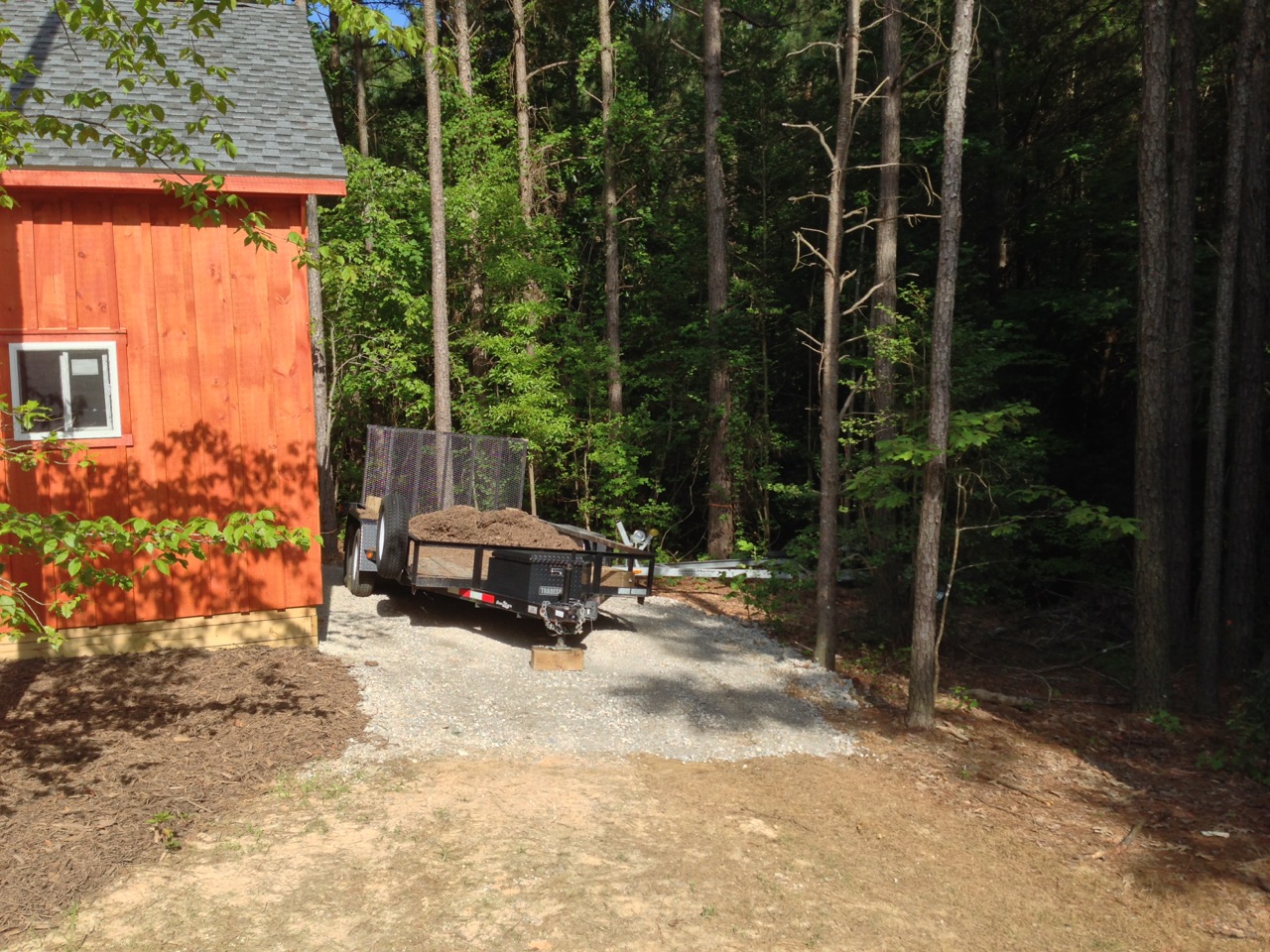

Some updates -- got the area behind the barn built up, graded, and topped with crusher run so I could park my 7x16 trailer back there.
Having this hidden parking area was one reason I went with a shorter barn, but I had been second-guessing that decision. Now seeing how much room I have inside the barn and how well the trailer tucks away in back, I am pleased with the arrangement.

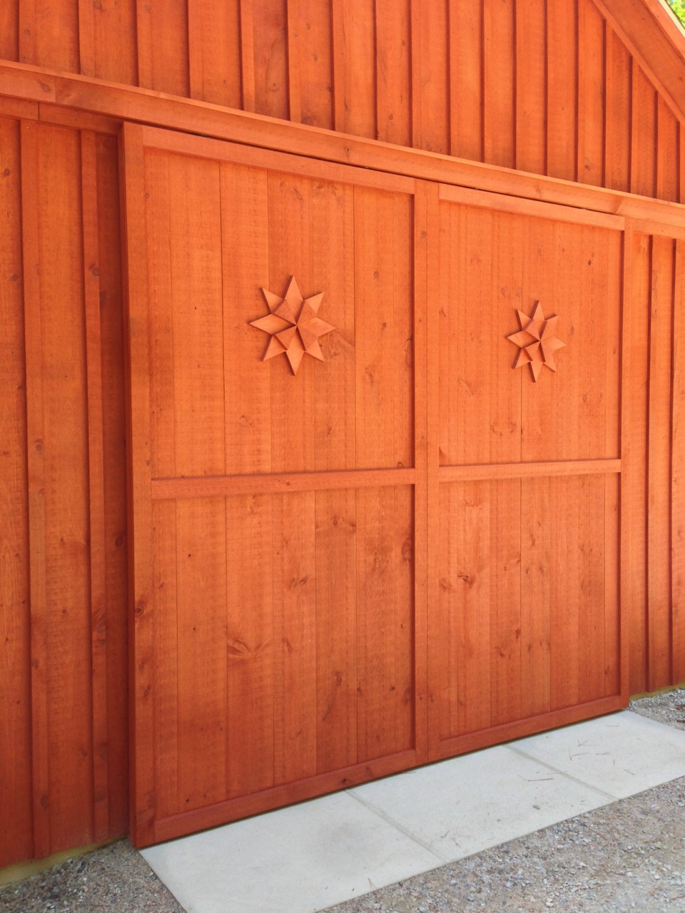

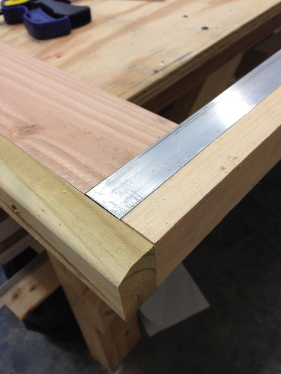

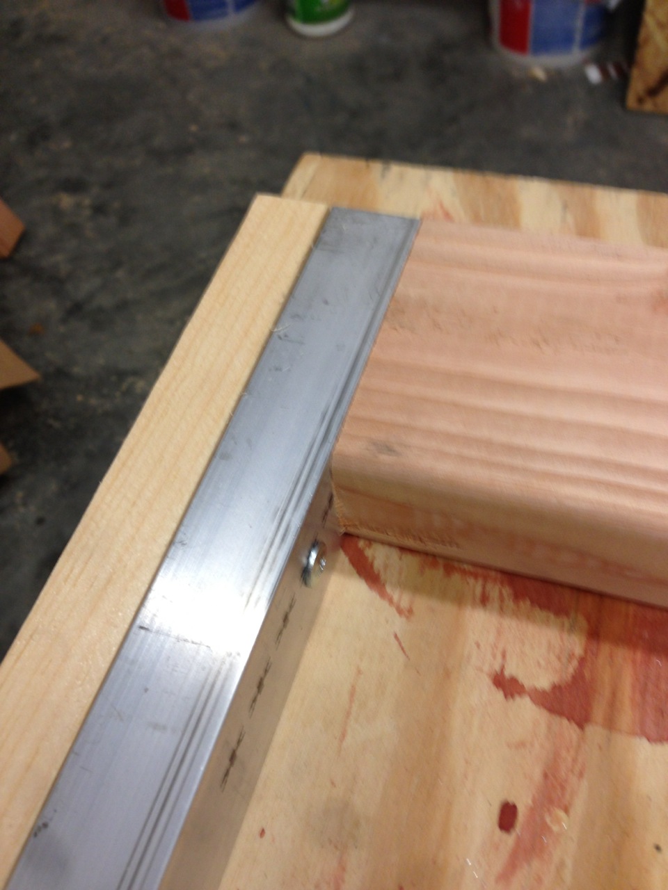

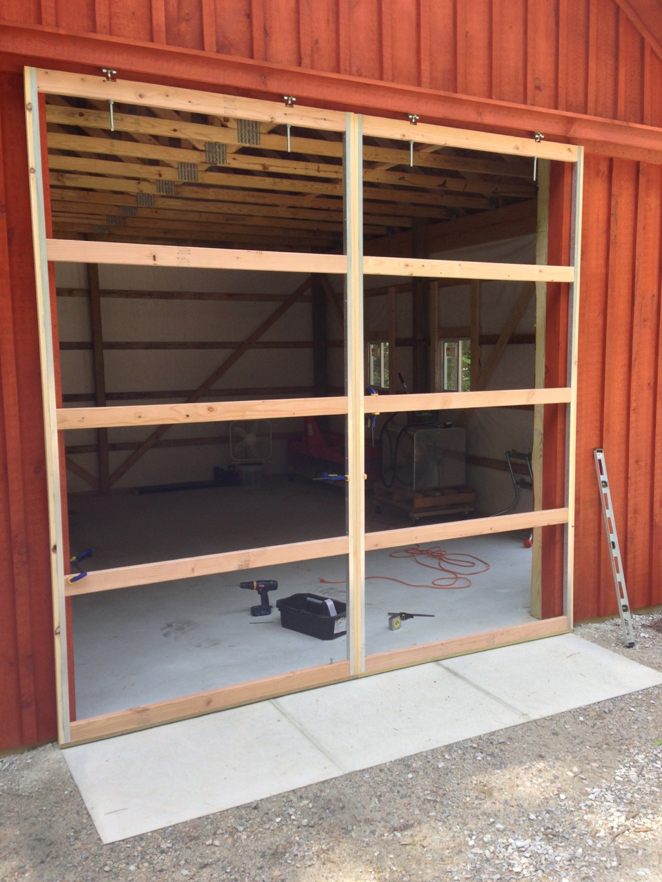

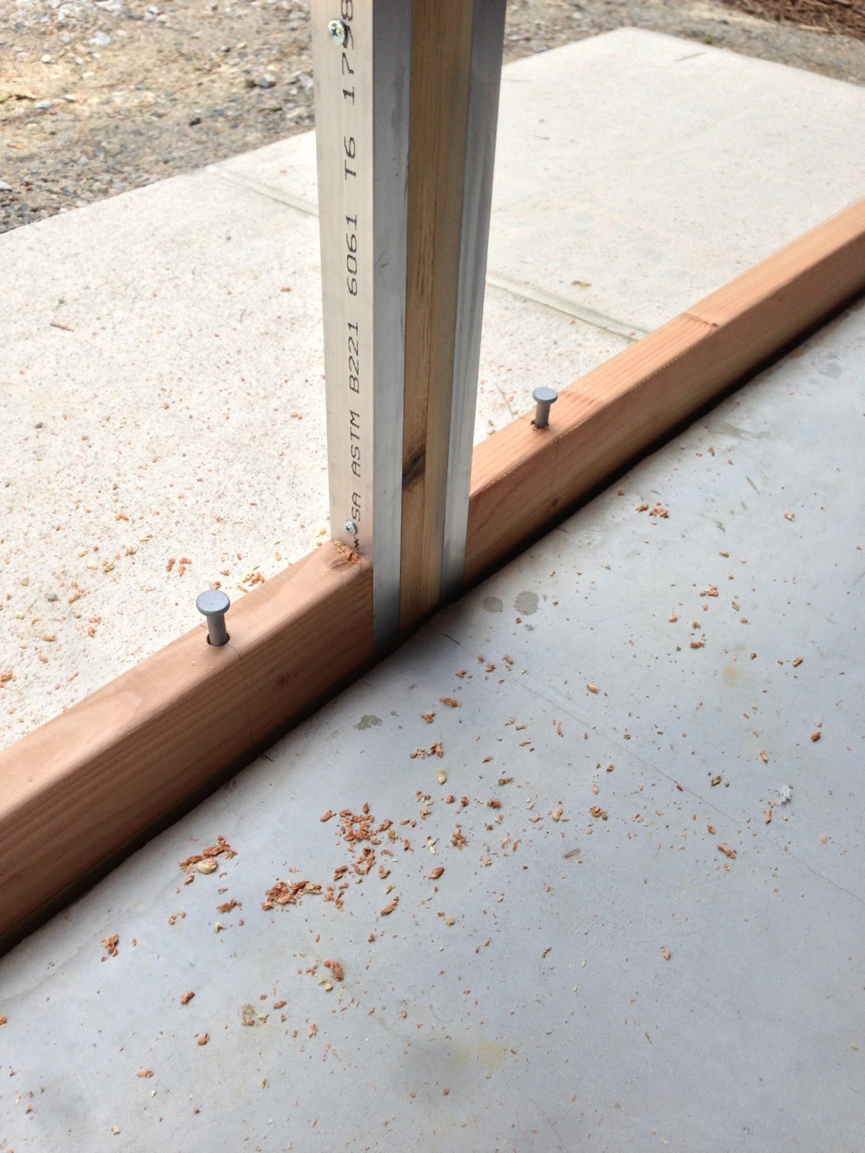

I have the front slider doors finished, each 5'x10' in size. It was quite a project, but I took extra care to make sure the doors would be flat and secure. Having looked at a lot of barn doors over the last few months and seeing problems with warping, poor tolerances, and misalignment, and having issues buying straight wood that stays straight in long lengths, I decided to make the vertical sides of the door frame out of 1"x1.5" aluminum tube. It's strong, light, and will not warp or twist. Five fir 2x4 pieces form the laterals, and then various trim pieces cap off the bottom and sides. Here are a couple shots of the construction:
That second shot shows the bottom with pressure-treated cap in the area where the door will sit against the floor slab.
Here are some shots of the test fit of the frames:

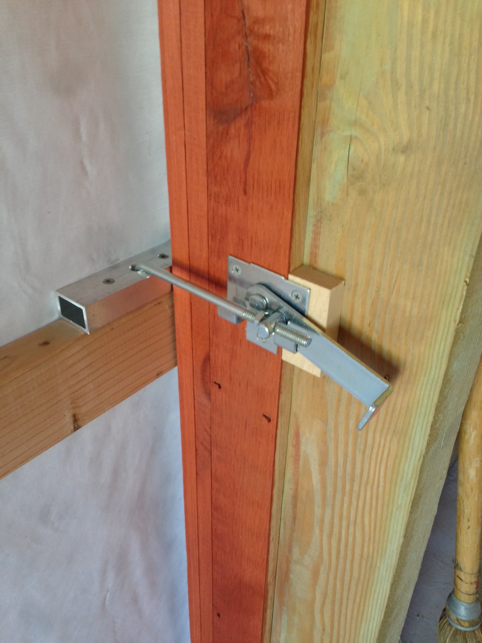

At bottom, you can see how I secure the doors using pins that drop into pipes embedded into the concrete apron. Right now I am using timber nails, but will eventually use a piece of rod with a welded-on handle.
Here are the finished doors, hung and adjusted. To keep the weight manageable while putting the doors on the tracks, I attached the siding boards and trim after the frames were up and squared. Didn't want to have painted hex signs but wanted some ornamental rosettes, so I made them out of wood and gave them a little 3D effect. Cam locks on each door jamb complete the arrangement.
With the center pins down low and cam locks midway up each jamb, these doors come together to be very flat, stiff, and secure when closed up. Combined with the aluminum framing, that ought to help the doors stay very straight over time.
