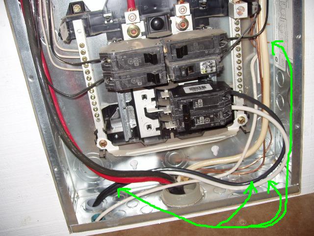

Today I tore out the four wire wiring as seen in my opening post and replaced it with three wire 6AWG 600 volt black, white and bare copper ground. The run was only around two feet so the expense was minimal.
The old white wire was as suspected just clipped off above the oultet's wall box with no wire nut.
I have sure learned a lot about 230V circuits since I started this thread but by no means will I venture any further into the relm of "electricianism" without consulting the forum as I did here.
Nothing on the horizon but that can always change, thanks all.

You were fine before you did all that. And you're good to go now.
   / 220A welding circuit question #63
Always glad to confuse you. Happy welding, enjoy making sparks.
   / 220A welding circuit question #64
Unless I misunderstood, please wrap the ends of you new white wire with red tape. You are using it as a hot leg and you don't want anybody ever thinking that it's a neutral.
I'm sure getting good at opening up and buttoning up a sub panel!:)
