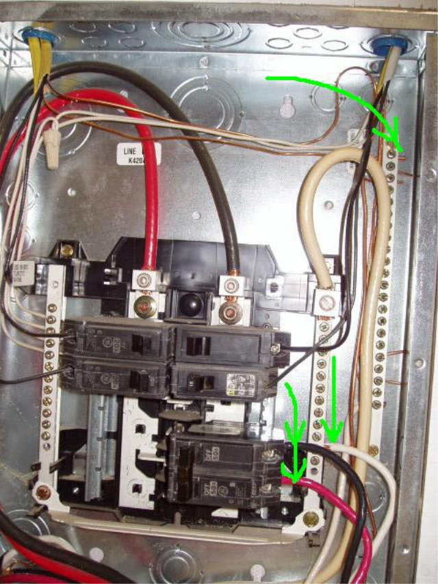

I will be taking a beginning MIG welding class at our local JC in about a month . My question is after looking into the single 220A dedicated circuit in my garage at the 50A-250V 6-50R three prong receptical which is a foot below the garage sub panel and #6 wired to a 50A curcuit breaker in the sub panel, there are four wires in the sub panel and only three wires in the outlet receptical box??
The sub panel is fed via a 100A circuit breaker from the main panel at the house-less than 70 feet away.
The 50A outlet has a black wire at the smaller of the two vertical rectangular inlet prongs and a red wire at the larger rectangular inlet prong that feed from a 50A circuit breaker in the sub panel. The ground inlet prong has a bare copper wire. Match that to the photo (green arrows) of the subpanel and you will see a (4th) white wire from the same outlet loom attached to what I think is a neutral connection but not in the outlet box?? Is this o.k.? Possible abandoned white wire to create a three wire 220A circuit? I'm looking at a Hobart Handler 210MVP as my plug-in.

is the bare wire going down to plug the same gauge as the white?
you said those are 6 gauge going down to the plug? or is it 6 gauge feeding the pictured box?
you can abandon the white beings this is a 240 volt circuit.
3 wire plug for 240 volt requires 2 hots and a ground, ground can I believe be white, would be better to put some green tape on the ends, or it can be bare.
white/neutral in your box is same as ground as is case in most applications
your 2 buss bars are tied together at the bottom.
modular/mobile homes have 4 wire service with separate ground I'm not up on it.
I am not an electrician, few eras ago worked as a helper but have done fair amount of wiring and pretty much do it by the book
take care and have a great safe cone!
Paul
PS #12=20 amps; #10 =30; #8 = 40; #6 =50;

The bare copper wire going down to the plug looks to be of the same size as the other three with the exception that it is solid and the red, black and white are braided. The bare copper is in the same wire jacket as the rest.
The 240 circuit is #6 wire from the 50A breaker to the plug below. The larger three red, black and white wires at the upper part of the box is the feed from the 100A main over at the house.
Since the #6 white seems to be only attached at the neutral, I know it isn't inside the plug box, should I just leave it alone?
Thanks for responding.
CORRECTION: The solid bare copper ground wire is about or more than half the diameter of the other three braided wires, compaired copper to copper.

Insulated wires carry voltage [ black, red, blue, white]. The bare, in your case copper wire is the ground safety lead. The two black lines in the panel are hot, the voltage measured will be 240v line to line. Any of the two black lines to white will measure 120v. Who ever wired the panel made a slight goof, one of the black lines should have been red or marked with a piece of red tape to identify that line as a the second line of a 240v circuit.
What ever plug/receptacles you choose, you will need only to connect what you use, two hots, black and black-red, then ground. Some wielders use 120v and in that case you need the white. Do you have a volt meter?

H e L L no! Never equate common/neutral with ground. Common/neutral carries the return current for 120v circuits were as the ground will carry the fault current to trip the breaker. Sometimes equipment will have a slight leakage current, not enough for a full fault and the ground keeps the case at zero v so you do not get blown out of your socks.
If you want the ground lead insulated it must be marked as a ground lead, Green or green-yellow or green tape as per code.

On this 220 circuit, red and black are hot and white is neutral. If they have the bare wire hooked up in place of the white down at the receptacle, it should be changed. It will be handling the return and you don't want that bare wire arcing to whatever it happens to touch en route. The bare wire should be attached to the ground screw on the outlet box if it's metal and folded back out of the way if it isn't.

To the OP, your outlet is correctly wired using only black, red and bare. The white wire that is attached to the neutral/common bus in the panel is probably cut off at the point it enters the outlet box. While this is not going to break your outlet, I would not leave it that way. It should be capped off at one or both ends.

Thanks for all of the responses but as a non-electrician I can't decipher all of what is being said. Is it o.k. to use it the way it is for my soon to be new MIG welder?

wstf2, you've gotten both good and bad information, as usual when it comes to electric. But from your picture and your description, your 50A 240V receptacle is wired correctly. If a grounded conductor (sometimes called the neutral) was needed, it would be a 50A 120/240V 4 wire receptacle.

This may or may not make a difference but the wire from the house main panel to the garage sub panel is 4-wire red, black, white and bare copper, all of which are attached in the sub panel.
/ 220A welding circuit question #18
That would be the correct wiring for a sub-panel.

The white neutral isn't hanging loose in the outlet box. It must be higher up above the outlet box and below the sub panel in the wall cavity.
#20
1. For peace of mind and since it appears to be doing nothing, should I detach the white wire at the neutral bar and cap it off?
2. Should I pull the existing complete #6 four wire out (it's only about three feet long) and replace it with #6 hot black, hot white and ground green, following the exact sub panel connection path as the existing hot red, hot black and bare copper ground?
3. Leave it as is?
Again, thanks all, just want it to be safe and right for the three pronged connection welder.
