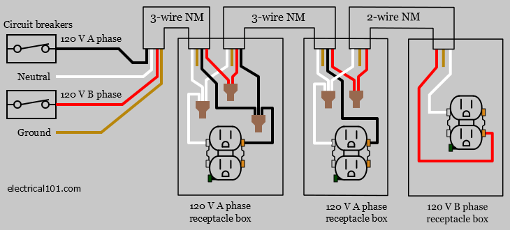

OK, so reading up on it, it's a multi-wire branch circuit. Circuit as in singular, not circuits, plural. It's one circuit, not two. Correct?

no, there 2 separate circuits. They share a neutral. The reason you use 2 pole breaker is the necessity to kill both circuits in the box if working on it. E02CE4AA-1FC7-416A-9373-6E2A10AF4D9E.png

no, there 2 separate circuits. They share a neutral. The reason you use 2 pole breaker is the necessity to kill both circuits in the box if working on it. View attachment 669015
Yes, I see the same circuit example all over the place. All of them refer to it as a circuit, not circuits. Anyhow, looks nightmarish. Thanks for the info.

OK, I'm confused (nothing new there). You can't put 2 circuits on a 2-pole breaker.
Me personally, the only thing I know about electricity is which wire to use with which breaker, stuff along those lines. I know enough to keep from blowing stuff up lol, but as far as actual electrical theory, I'm fairly ignorant. I only learned about this edison circuit by googling shared neutral wire circuits.
