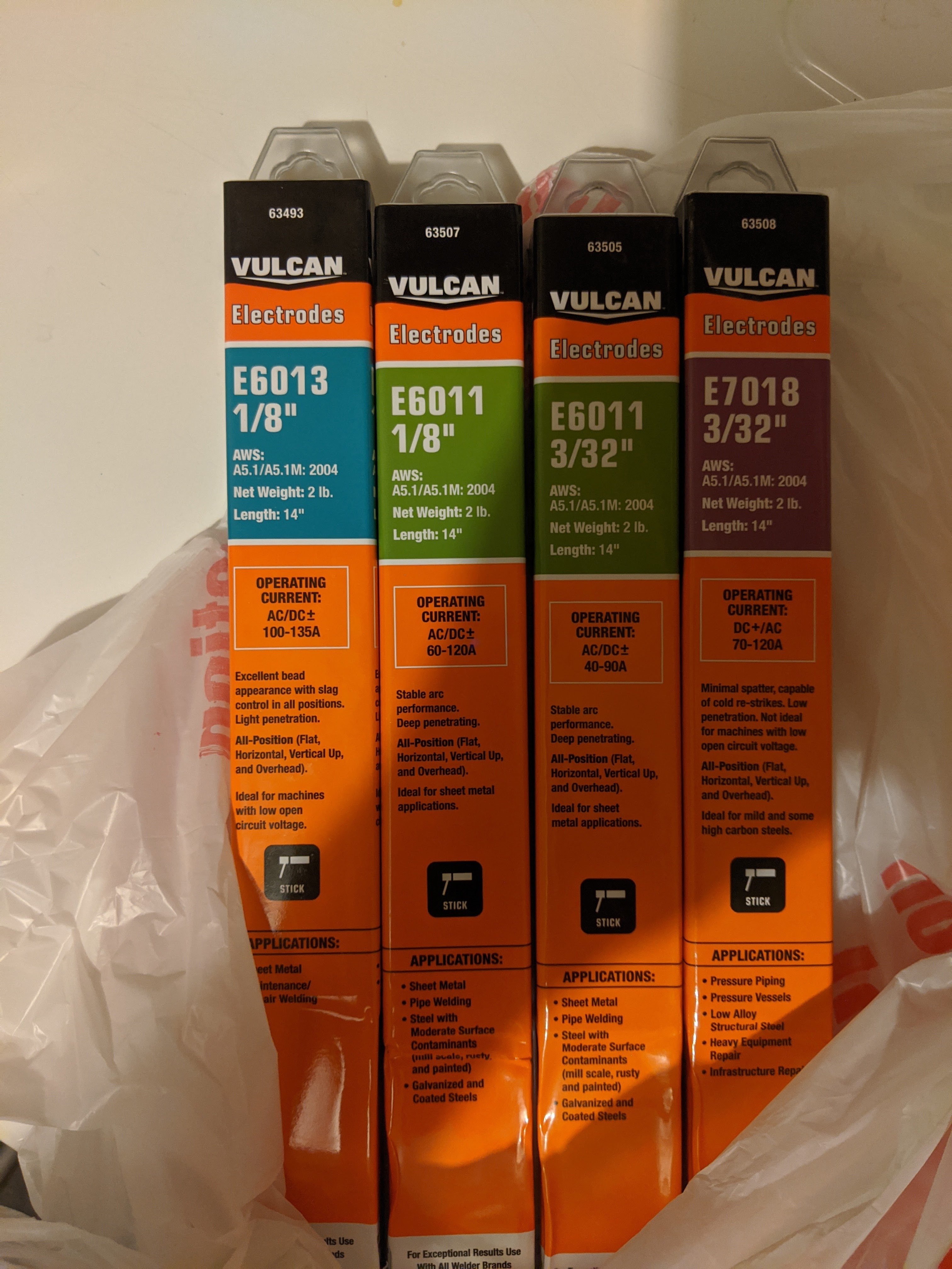

Ha yeh, that's what happened exactly, actually. At first I ran it on the garage circuit, did ok until I cranked up the heat, then it popped the breaker. My fault, I had the wireless speaker playing and probably the other stuff plugged into outlets has a little draw. Anyways, I installed a 20 amp outlet on that other unused circuit, it ran great on that.
I only burned the 4 rods that came with the welder, but I really like using this welder a lot. I used the settings from the link k0ua posted to me, started somewhere midrange and cranked it higher if I couldn't get a spark w/o it sticking. Even 1/8" rod did on 110v, but I don't know if it's just for those J422 rods (aka E4303).
Then, ran out to harbor freight and bought all these:

Some 1/16 E6013 can be handy for tacking up light parts.

Good to know, thanks!

Gene, good for you getting some rod burning time frying some bacon.

Oh yeh, I don't mess around KC. I really loving stick welding! I'm taking to it much better compared to my flux core welder I been using.
I didn't open the 7018 yet, I want to first get one of those airtight containers you guys use. The 6011 was running best when I was up in heat range of popping the breaker, but man they ain't kidding that rod absolutely digs! It was digging to china on the 1/4" flat bar I was practicing on.
Loved welding with the 1613! The slag was peeling off on it's own as it was cooling, that was fun.
But, I popped that 110v/20amp breaker a few times, that was getting old. Today I'm gonna pick up supplies to get the 220v outlet ghetto-rigged into the garage.
