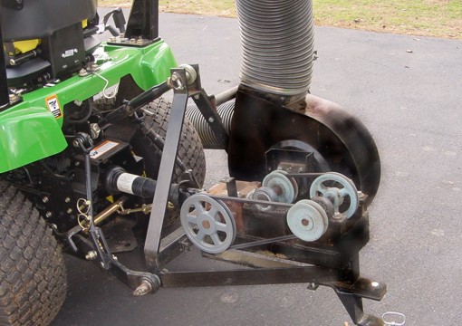

Here are the pictures of the PTO TRAC VAC on the 2210. I’m pulling the mower & Vac off tomorrow to put the snow blower on, so it was now or next year for the pictures. The TRAC VAC worked great, chops the leaves up so fine that the cart supposedly holds 52 bushels of leaves. At lest that what’s in the owners manual. I figure I was vaccuming a cart load of heavy leaves per acre.

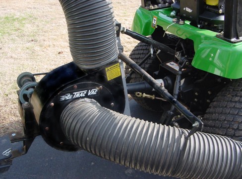

HERE'S 2

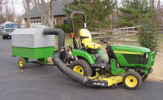

HERE'S 3
