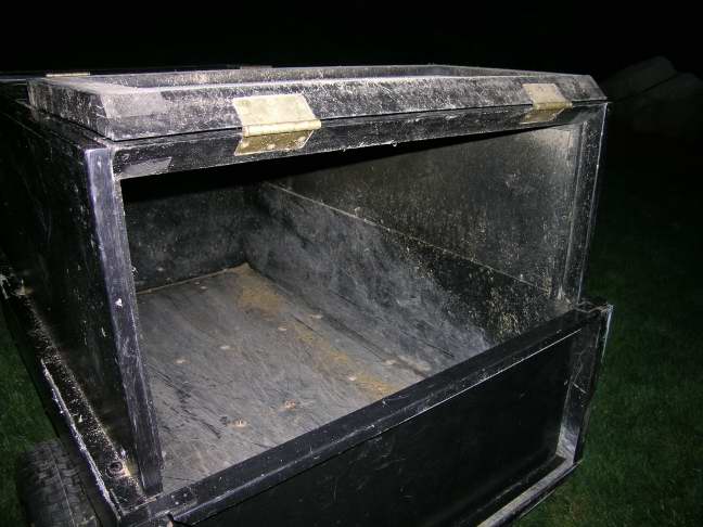

here is another look at the tail gate and the outside look of the plywood panel. Note that outside of the door jam is rabbited to accept the plywood. You also can see how the bracket fastens to the steel lip of the cart.

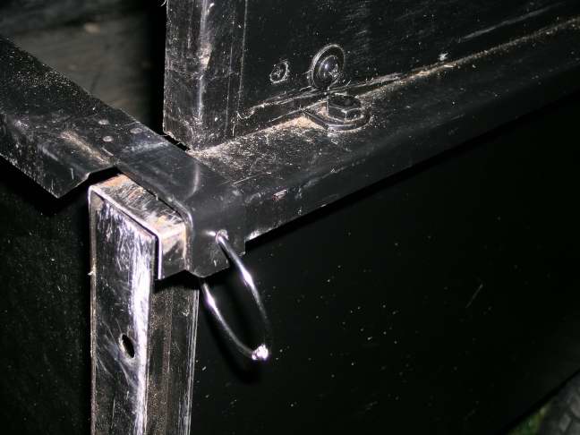

close up of the plastic flange. It came with a slight angle down to accept the hose angling up to it. In my design there is a horizontal connection so I had to trim a a little off the connector to square it up.

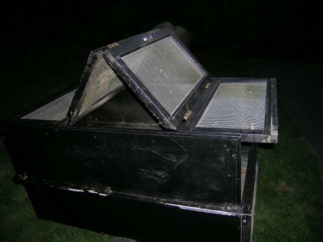

Again, this shows some of the angles involved in getting it to fold up and the orientation of the hinges.

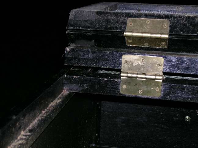

one more look from the back with just the last frame folded up. The hinges are rabbited out as well so everything fits together tightly.
