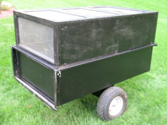

Ordered the power flow unit on Saturday. One more question, how did you setup your cart for collecting from the power flow the unit?

cool. Give me a day or so to take some pics of the cart...
Here are some tips which will give you good performance.
Use as little duct as possible and keep the duct horizontal. See the 2nd pict that I posted. I have the base of the duct anchored via bungee cord to the very bottom of the ROPS. The duct then connects directly horizontally to a plastic flange that is mounted to the cart. I bought the flange through Deere. All of the duct is 7 inch. I recommend T-7 thermoplastic duct. The duct is very flexible and great for this application. I made the duct short enough so that it stretches a bit when the cart swings away from the power flow.
Air venting is a very important feature of the cart. If I am picking up grass, I brush off the screens after each dump to ensure good venting. Leaves don't gum up the screens as much but keep an eye on it.
Use the highest lift blades available for the deck. I think the only choice is the standard blade.

Great the pictures would really help. You wouldn't happen to know the part number for the flange or what model it was made for?
   / 2210 bagger, Mat'l Collection Systm, ballast rack!
#20
Re: 2210 bagger, Mat\'l Collection Systm, ballast rack!
here is an overall pict of the cart. Materials used:
3/8" plywood
door casing
2x3 for frame
1/4 " screen
door hinges
small angle brackets
plastic flange to attach hose
the plastic flange is a part from the 3 bag material collection system for 50 & 55 series tractors. I dont have the part number but the part is shown in the owner's manual OM-M77710 issue May 88
