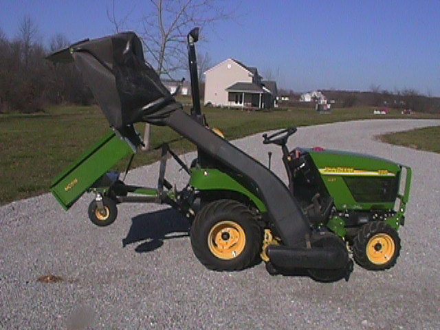

HSwan, I had a 445 with the 54"mmm and a Powerflow head with the MC519 collection cart. I used this setup at our previous home where we had a lot of mature trees. It worked wonderfully. I have since upgraded to a 2210 with the 62c mmm and I purchased another MC519 cart and PowerFlow head from the X-series. I then made a 3pt hitch to adapt the cart to the I-match. I can now carry the cart behind me or let it ride on its casters. When I go to dump the clippings, I can raise the cart ~40" off the ground and dump them on top of existing piles. I think the advantage of the MC519 type cart is that it casters behind the tractor so you don't have to worry about jack knifing a trailored collection system. I'm sure the other systems with the pony motors have a lot of power, but I've never had a problem with the PowerFlow head and MC519 cart. It works well and you don't have the additional noise of a pony motor and fan.
I had posted on this previously here http://www.tractorbynet.com/forums/showthread.php?t=57270
I'll try to post another photo for you.
