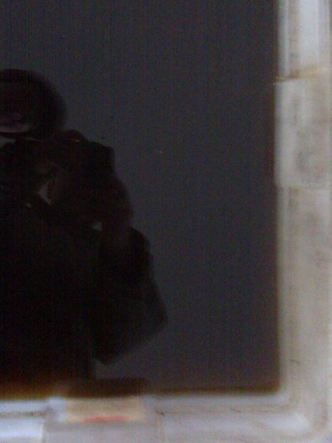

The last oil change was at 400 hours and the transmission at 200 hours. I had always thought that not much goes on in the transmission and the oil should be fine but not the case the fluid was quite dark, but no metal pieces on the magnets which was nice.

I change the engine oil annually on my 2210, we usually put on 60-80 hours a year, and it is always very black when I change it. Trans oil for mine at 50 hrs and again at 250 hrs, and yes, that nice clean trans oil does not look very clean when it comes out. I assume it's from the hydro clutches, I grew up with gear farm tractors where the hyd. oil only handled non-friction work and it usually looked (and smelled) much cleaner over time.
