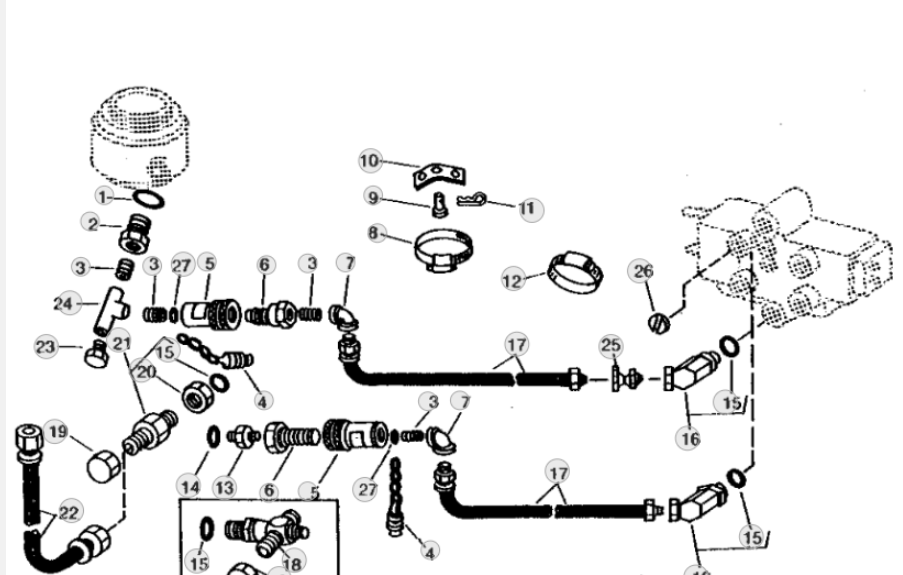

/ 2240 Aftermarket Loader install #4
I agree with Harry. JD 2240 has closed-center hyd system which requires 2 hoses to operate FEL control valve. FEL control valve will need a closed center conversion plug with inner seal installed. Pressure hose should be attached behind pressure control valve on RH side of tractor just behind ported hyd filter cover.

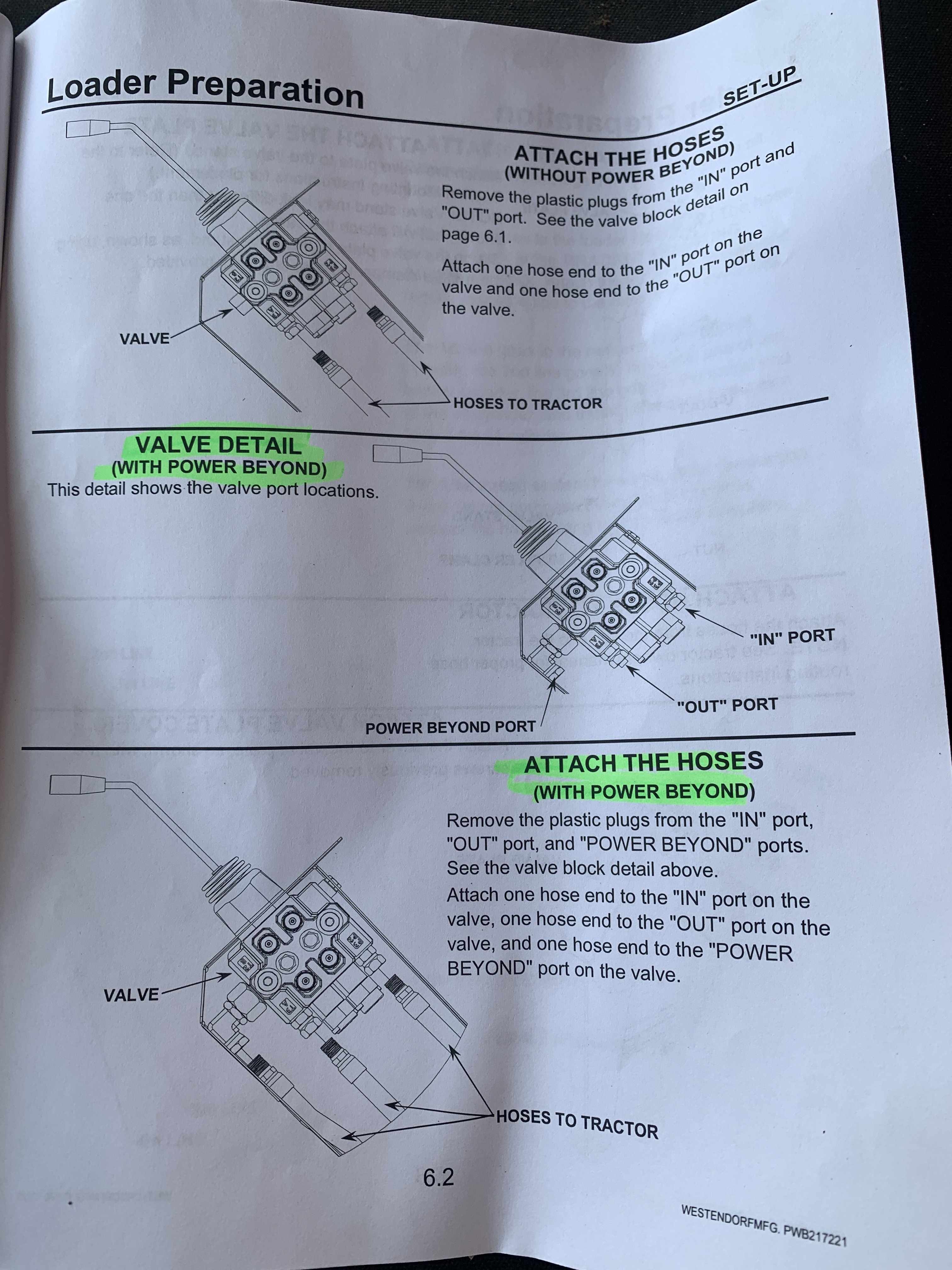

/ 2240 Aftermarket Loader install #5
If the loader valve supplied has the power beyond feature just cap the power beyond port off. That would be the same as converting to closed center.
/ 2240 Aftermarket Loader install #6
I disagree to convert open center valve with PBY feature then a closed center conversion plug needs to be installed & tank line hose removed & orifice capped. Only capping PBY orifice & not installing a closed center conversion plug with inner seal will cause closed center hyd pump to cavitate from lack of sufficient amount of oil being supplied to front hyd pump.
/ 2240 Aftermarket Loader install #7
How is installing the power beyond plug different than just leaving power beyond sleeve in place and then capping or plugging the power beyond port where you would typically connect the power beyond line. There is no flow with power beyond port plugged same as installing the “factory” power beyond plug in the valve.
Yes you still require the tank or return line connection.
/ 2240 Aftermarket Loader install #8
Thanks for correcting me. After some thought I agree you're correct in that there's not any difference between capping PBY adapter plug & installing a CC conversion plug. I was taught many yrs ago to install CC plug.
/ 2240 Aftermarket Loader install #9
Tx Jim
Installing the CC plug is the normal accepted procedure but in this case he has the valve so tried to provide a “simple” alternative solution vs trying to find CC plug.
And if you’re like me it can challenging to teach an old dog a new trick..

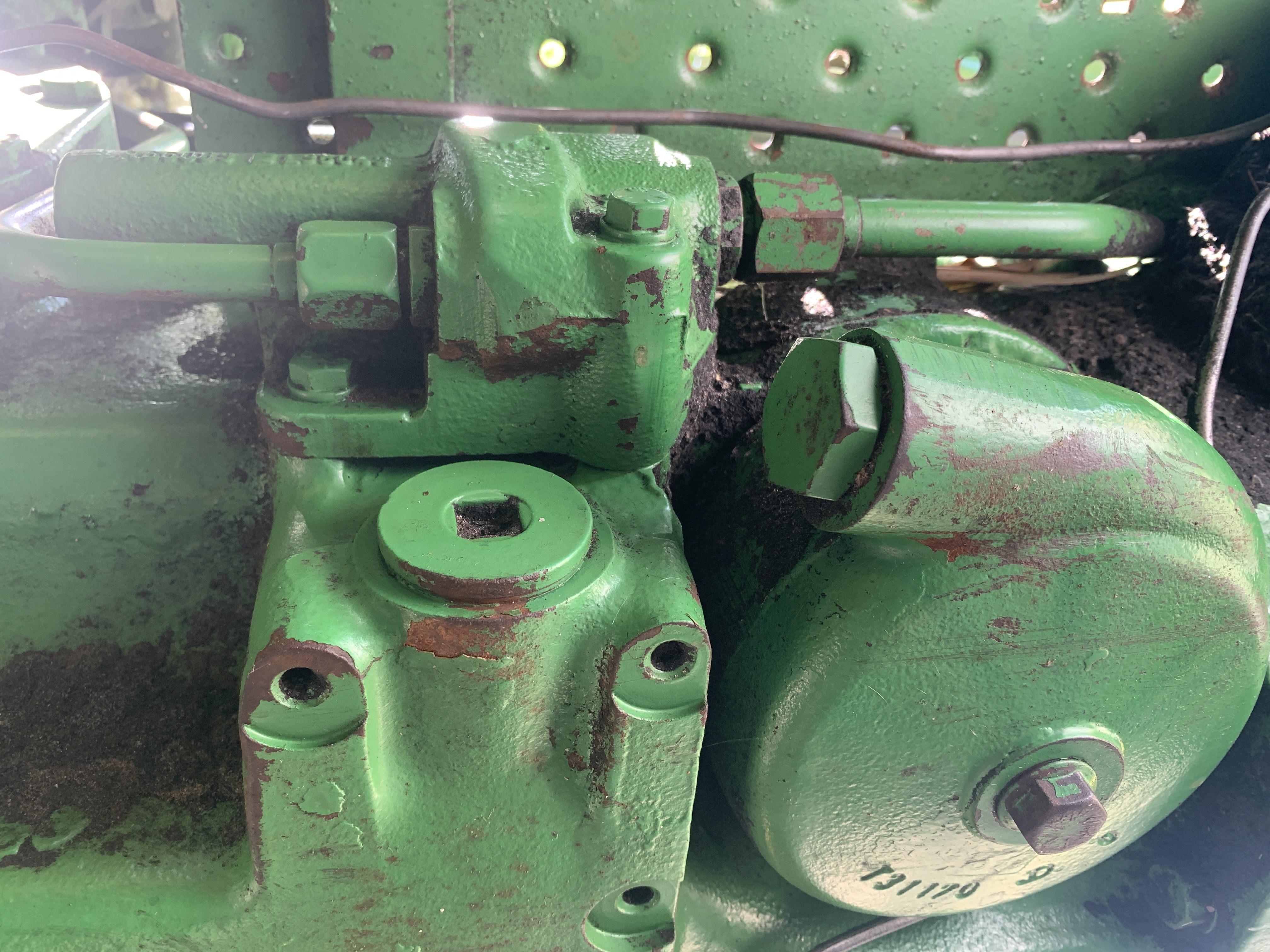

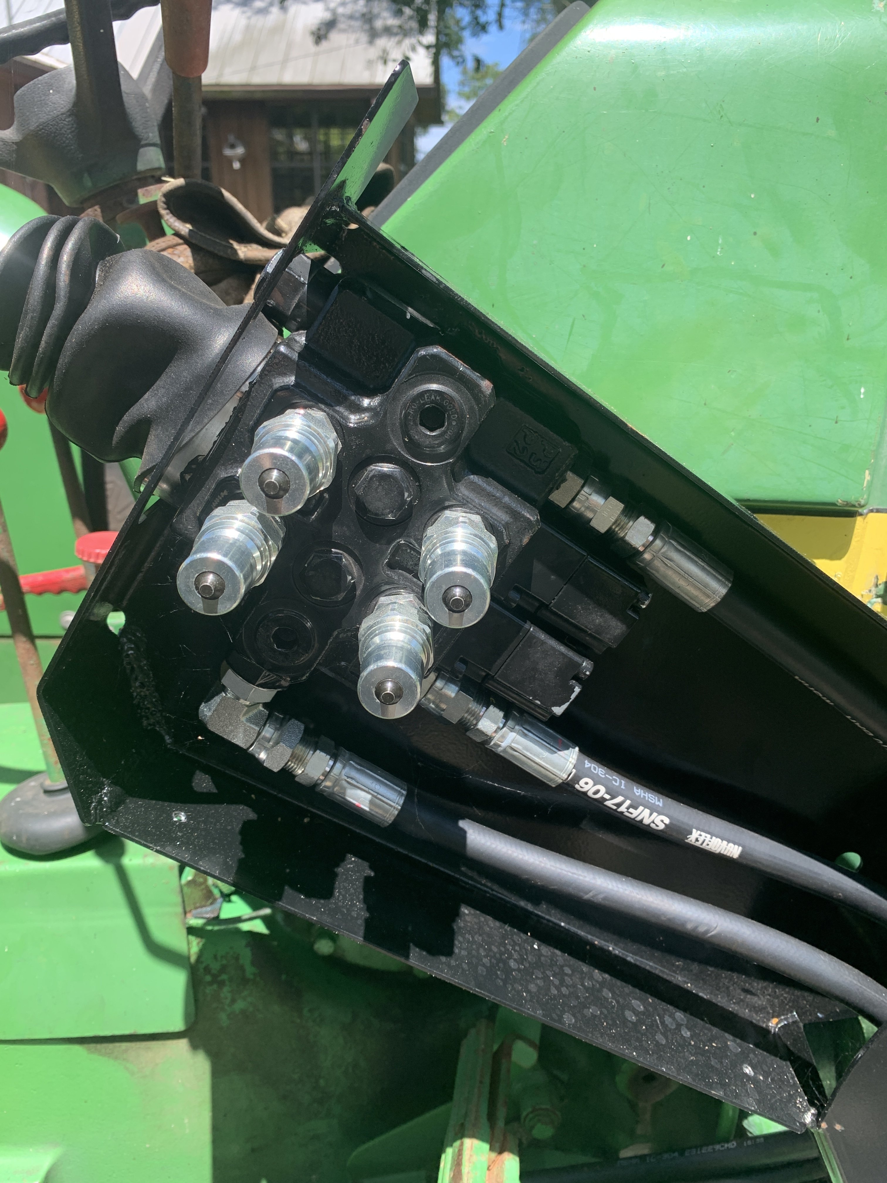

So, if I am understanding you correctly… Return line from FEL valve to the ported filter cover, the pressure line from the port behind the filter cover to the FEL valve, and cap off the PB at the valve port? I have seen some illustrations where they Tee at the filter cover and run another hose to the SCV side port (with a kit). Is that to increase overall flow to the SCV?

/ 2240 Aftermarket Loader install #11
Option of routing scv return oil to ported filter cover gets scv return oil back into hyd system faster than returning oil to sump(trans case) therefore aiding with speed of operation of total hyd system
