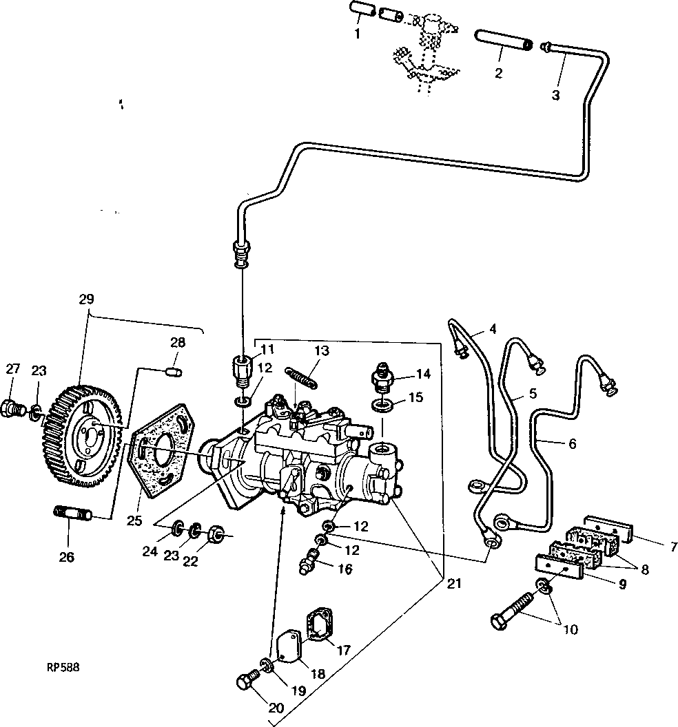

hi. I just replaced the fuel filter on my JD 2240. I bled it at the filter. When bleeding at the fuel injection pump I get fuel out of the bottom bleed screw. After I close that and open the upper bleed screw I can pump all day and get nothing. I know the hand primer pump is working. Any suggestions out there? thanks in advance.

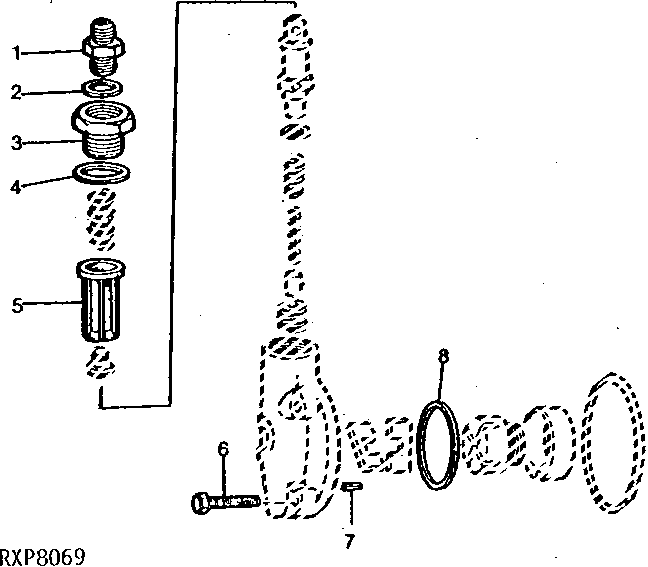

There is a bleed screw that you can loosen on inj pump body below top cover that isn't numbered in 1st photo. There's also a small filter(parts key #5) in pump inlet that may need cleaned. You do have fuel cutoff cable pushed in to "run position"???
