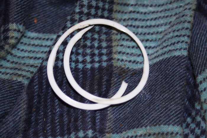

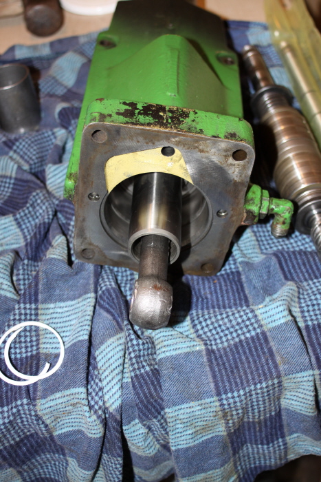

Picked up my parts Monday night after work. The new shaft is straight where the upper seals rides on the shaft and confirms my suspicion that it had excessive wear.
I replaced all the O-rings and back up rings and began putting the steering piston back into the steering housing. I apparantly did not have the back-up ring which seals the top of the steering piston installed correctly in the bottom of the housing, because when I installed the piston, it cut three slices off the inside of the back-up ring.
I removed the piston, O-ring and damaged back-up ring (and the loose pieces). The lower seal for the piston uses the same O-ring and back-up ring so I substituted that back-up ring and reinstalled the seals into the bottom of the steering housing. I double checked the fit and then reinstalled the steering piston. Success. No pieces this time.
I've ordered a new back-up ring from the John Deere dealer ($1.45) and they have it in stock. I should pick it up Thursday or Friday.
Once I have the new back-up ring, I'll be able to install the cap on the bottom of the steering piston and reinstall the steering housing onto the tractor, reconnect the mechanical linkage, and not have the open holes in the transmission. The steering shaft can be installed after the housing is already installed.

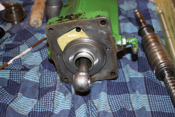

Got the new back-up ring and got the steering piston installed. I got the steering assembly reinstalled on the tractor yesterday and got the mechanical linkage reattached. Now I'm waiting on the dealer to call and say the parts for the steering valve assembly are in.:)

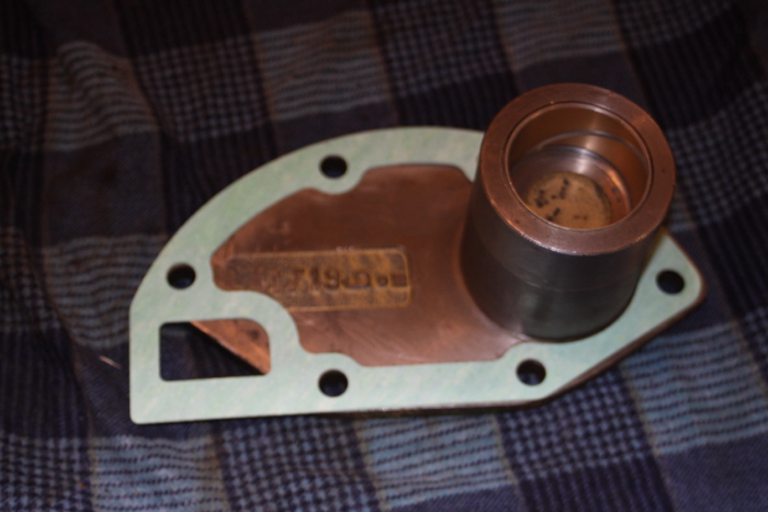

I got the parts for the steering valve assembly and got it reassembled. I installed it in the tractor today. No pix of this. The gasket for the steering shaft cover was the wrong gasket and doesn't match the cover. I had the dealer look up the gasket, and he came up with the same one that I ordered. I don't feel so bad about getting it wrong. The two options for gaskets are noted as: 1-(C)Hi/LO or 2-(A)Reverser; (D)less Hi/Lo. As my tractor doesn't have either Hi/Lo or Reverser, we both chose option 2. Upon further investigation, I discovered that the covers have the same choices available and my cover has the part # L41719JD on the inside of it (see picture). The cover listed for option (C)Hi/Lo, also has a note stating "(C) (SUB FOR AL30173) (SUB L41719 AND L64255)". Although I don't have a Hi/Lo transmission, I think I'll check the Hi/Lo gasket since my cover part # is listed for that unit. I see another trip to Deere in my near future.

I was right, it was the other gasket. I'll get the cover on this weekend and see if I can fire it up and test the steering. I currenly have the cowl which contains the batteries and all the ignition wiring removed to rebuild it while the tractor is down. The bottom of it was rusted out. Because of this, I'll have to get creative for hooking up wiring to start it. I want to move it outside the shop to pressure wash the area under and in front of the cowl while its off. Should make for some interesting pix with the wiring piled up infront of the steering housing.
