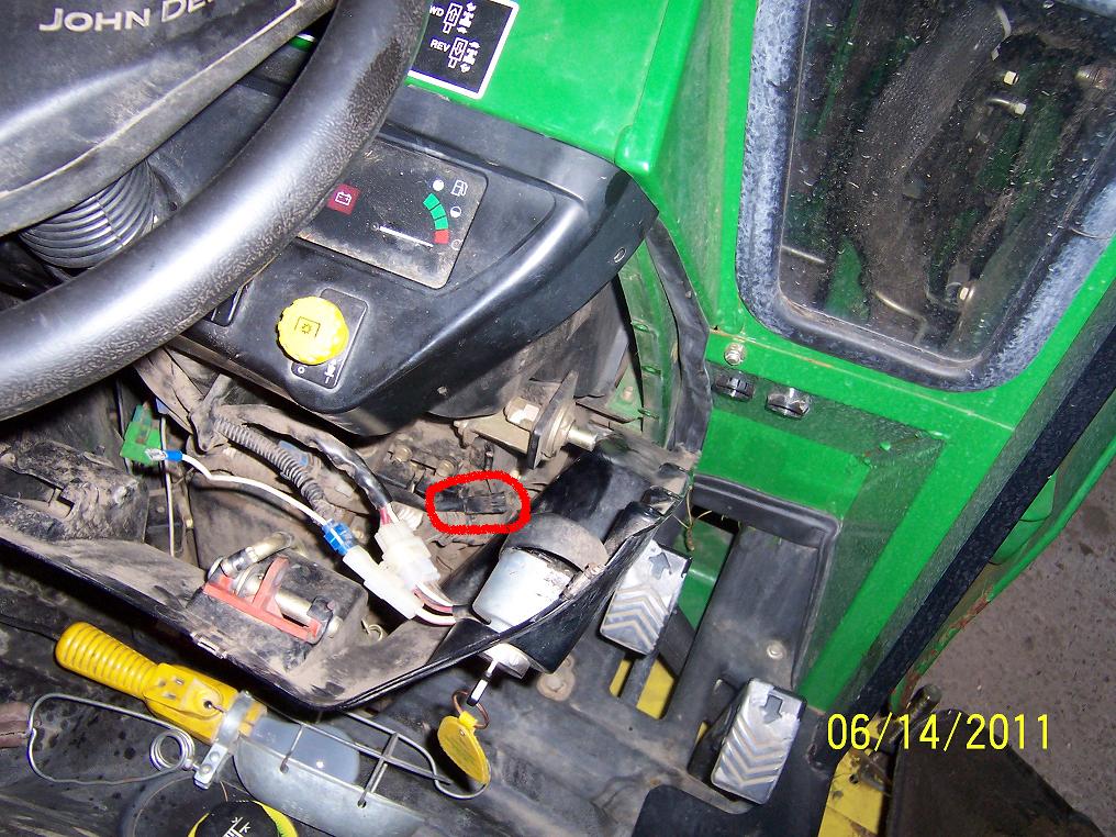

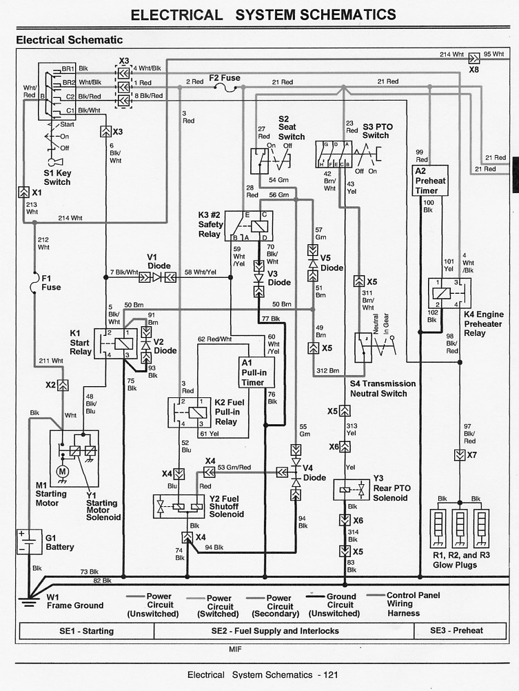

Anyways, I found the prints to his tractor and I'm curious if anyone knows exactly what diodes are the suspect ones shown in the prints. There are 8 diodes in the Electrical Schematic. Studying the prints I'm guessing the V4 & V8 diodes may be cause of concern if the reverse bias broke down on both of those diodes and possibly even V3. Yet I don't see any one particular set of diodes related to the flasher/turn signal ckt.

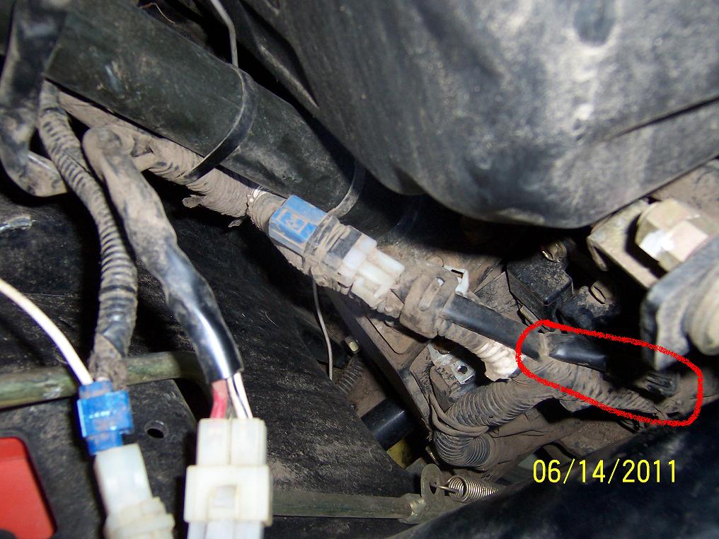

I saw the pictures showing the location of the failing diodes but was trying to find the equivalent in the print to see what wires they should be tied to.

Thanks for your help locating the diode , I found it and replaced it . Tried the flasher switch and turn signals and all worked fine . But when the engine was running and I turned on flashers (because I was in road) it shut down engine almost immediately. I blew a 15A fuse in the main fuse block on right side ,under hood. But replacing the fuse would not let it start. So I towed it to the garage , and took it apart to see what else might have blown , and it looked like it had melted the plug to some degree that the diode plugged into. I pulled new diode out and cleaned plug w/o-ring pick , and put in old diode and tractor ran and everything worked but flashers , just like before I started. What would have caused the diode not to trip, and blow a 15A fuse. Is there something else I should be looking for. For now it is running and snow blowing without the flashers , The way the snow keeps coming I am not going to experiment any more till spring. THANKS

Your wording cause the diode not to trip I do not understand as it is not a fuse or a circuit breaker. You indicated that it melted the plug, which could have caused the diode to burn up the diode allowing the current to flow in the wrong direction and blow the fuse. Many volt meters have a setting to test diodes.
I have attached a wiring diagram for the 2305 that I found in another post. Also look at thread 12 in this post for a diagram. As you can see from the wiring diagram there are several diodes, which diode are you having problems with?
I have included a link, which does a better job of explaining how a diode works, than I can do. One thing to learn from the link is how the symbol shows which direction it allows current to flow.
