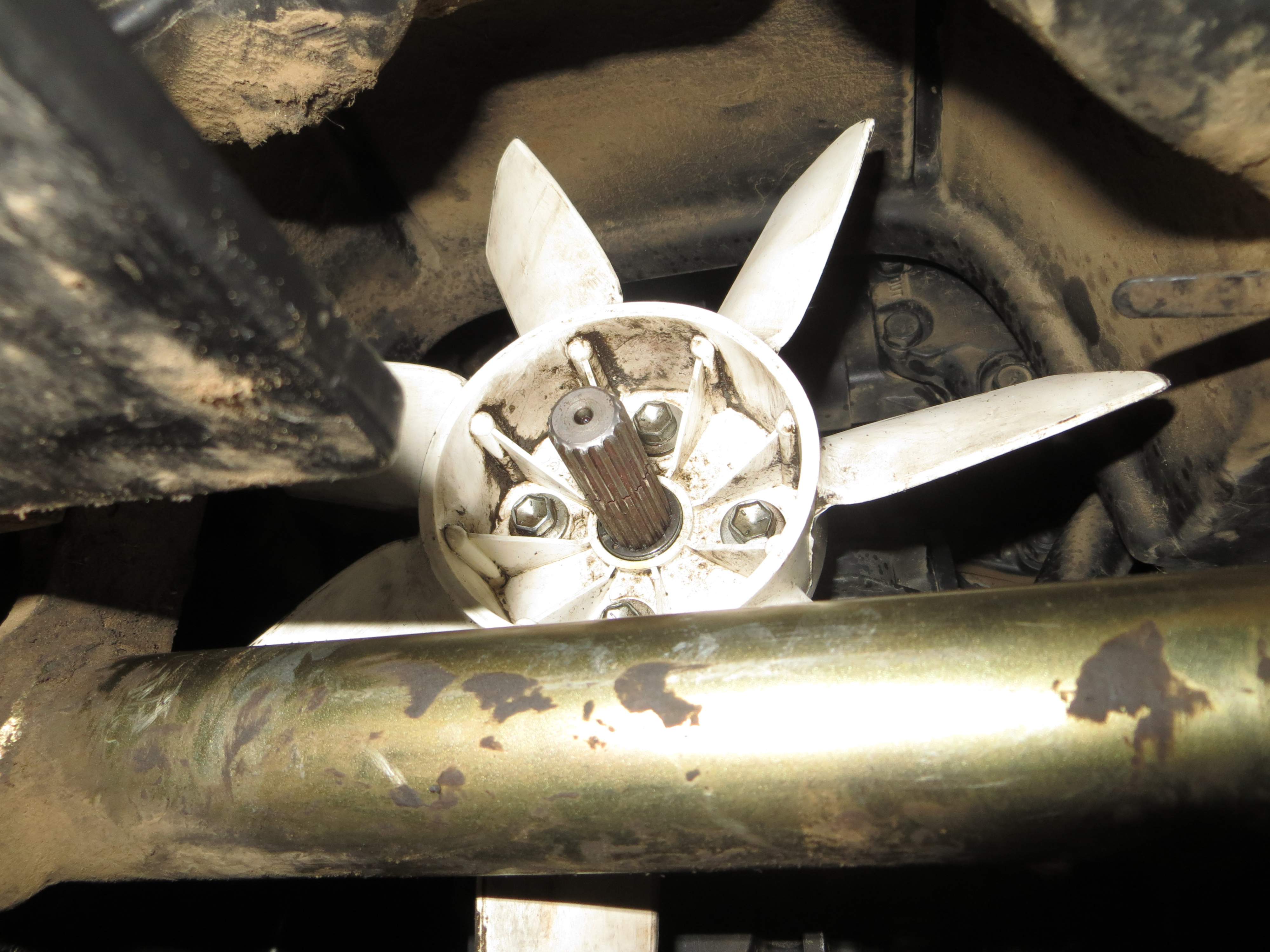

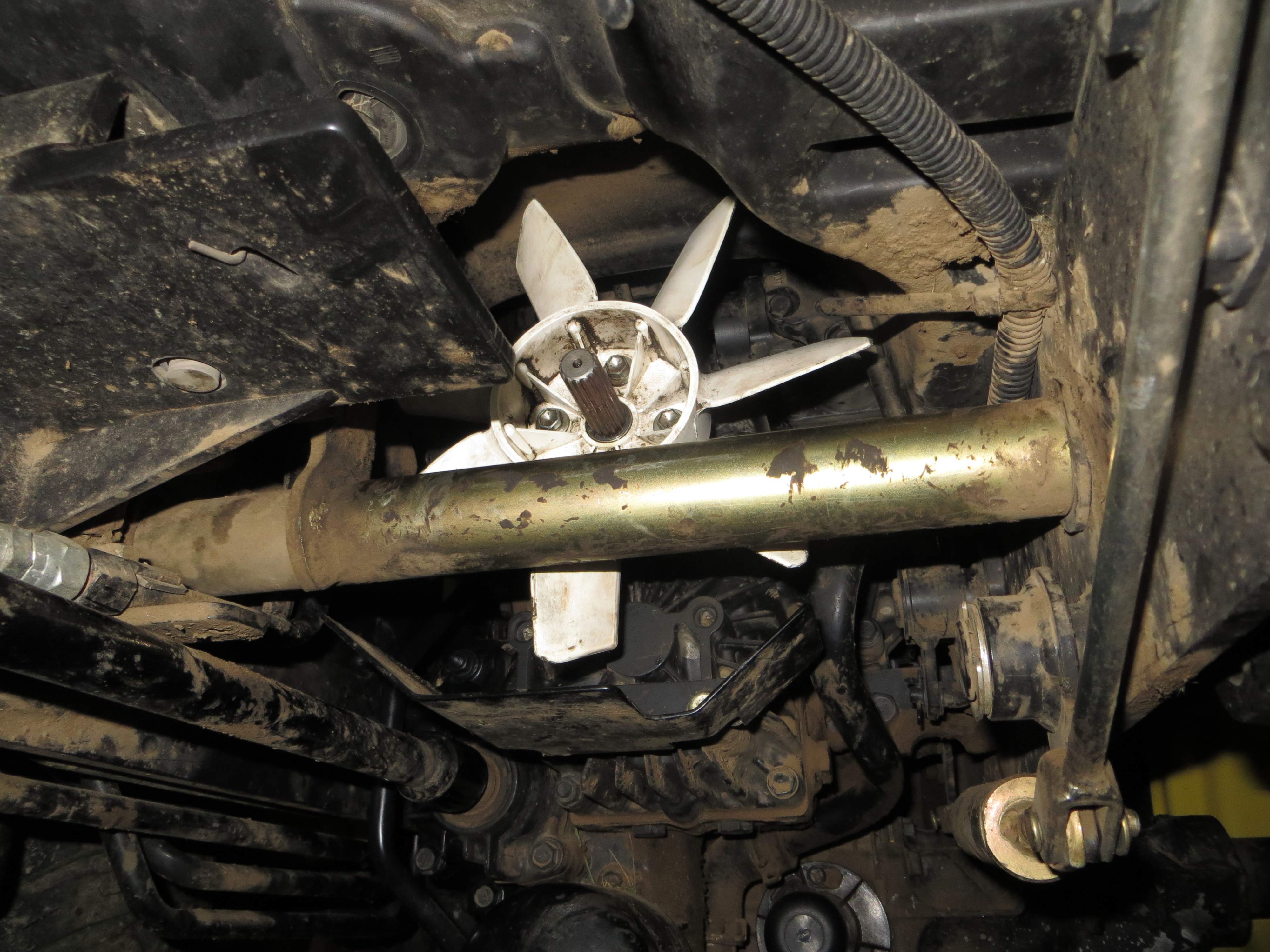

I really hate to bump such an old post topic on my first post... but after 4 hours of trying to replace this fan, I have to ask - how the heck can you even get a new fan in w/o taking the transmission out? The cross-shaft for the 3point simply will not allow a fan to be installed - it occupies the space the fan needs to be manipulated into position.
Am I missing something?
Thanks

First step in the manual, per TriGreen (who were kind enough to humor me with my pestering questions) is "remove transaxle." Which explains why it's a 5 hour job at the dealer.
Yet there are all these posts (not just this thread) of replacing this fan in < 60 minutes.
   / 2305 drive shaft fan repair/replacement #30

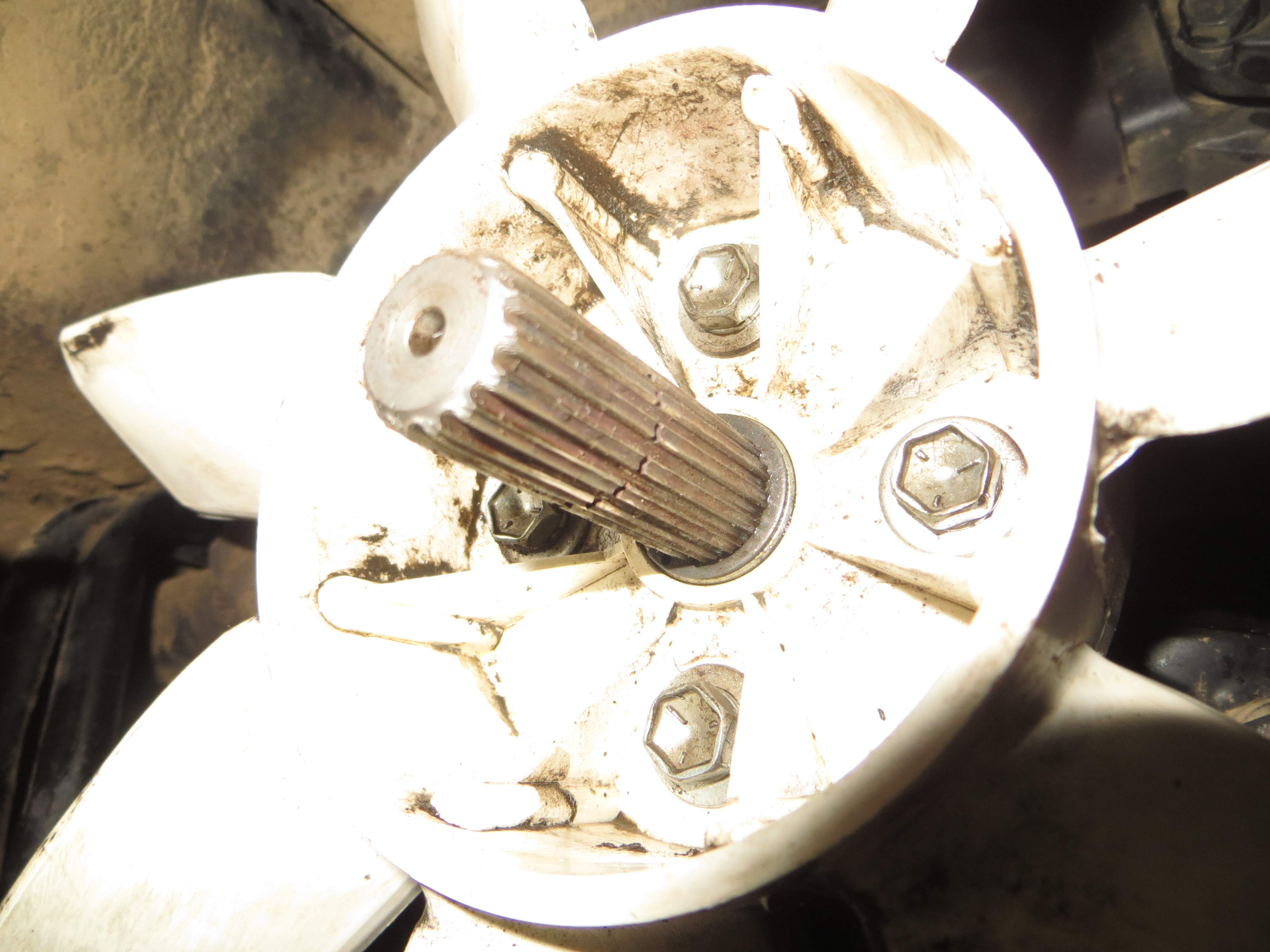

Are you talking about this cross-shaft? I've never had the fan off but I did remove the shaft and it look like and easy step from there to remove the fan but like I said, I never did removed it.
