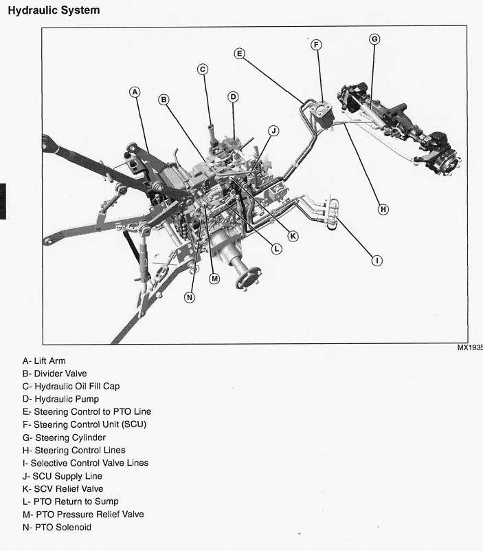

My guess is a bad solenoid. Could also be a wire rubbed through or pinched somewhere between the switch and solenoid. I would remove shields ans right wheel if necessary to visually check entire length of the harness between(should be a yellow wire).You also could unhook the wire at the solenoid and then turn on the pto switch. If tractor stays running and doesn't blow the fuse, replace the solenoid.
   / 2305 not cooperating, need help #22
You can probably remove the coil from the valve. It probably has just a couple ohms resistance, but it shouldn't be a dead short. If your dealer has one in stock, they probably could measure it to compare.
It may still short internally when it heats up.

Well I found the solenoid. It looks like the last thing that the wires go to which makes sense. I looked for debris around it but what I saw was some kind of goop around the bottom left side of it. It amost looked like something that used to be a liquid but now it's cold and it is hardened. No idea what that is.
I've never changed or removed a solenoid before, is it very involved or do you pretty much unscrew the existing one and screw a new one in? I'm not very handy but the more I attempt on this tractor that more I'm learning. One thing I'm realizing is that I need to order the service manual(CD).

I haven't looked at it, so some of this is speculation. The valve is operated by a coil that turns the electric current into an electromagnetic force that pulls the valve mechanism open. It is usually closed by a spring. Usually they have a non magnetic Stainless Steel tube that separates the coil from the valve core. The coil is usually potted (encapsulated) with an insulating compound. The coil should be removable without disturbing the rest of the valve. One of the drawings I attached previously shows what looks like a hex nut on the very end of the coil which should allow you to remove it.
If the coil overheats, it's possible for the potting compound to melt and run out.
Assuming only the coil is bad, it looks like J.D. only sells the complete valve, which may by pricey! Any chance it's still under warranty?
Good Luck

Got a price on the solenoid-$115
Davkir, does the manual have anything about how to remove the solenoid and install the new one? I can wing it but if the manual has any guidance that could help me avoid messing something up. Thanks!

Changed the pto solenoid tonight. The original coil was split open and the insulation had spilled out. It also smelled pretty bad which was the burning smell I was smelling when it would blow the fuse. So I know that I needed a new solenoid but I don't know that the problem is solved. Whatever caused it to go bad in the first place may or may not be fixed. The old solenoid would still work for several minutes at a time until it got too hot and blew the fuse so simply firing up the pto tonight didn't tell me anything. I'll know for sure once I put the deck on and mow for the first time. Crossing my fingers.
