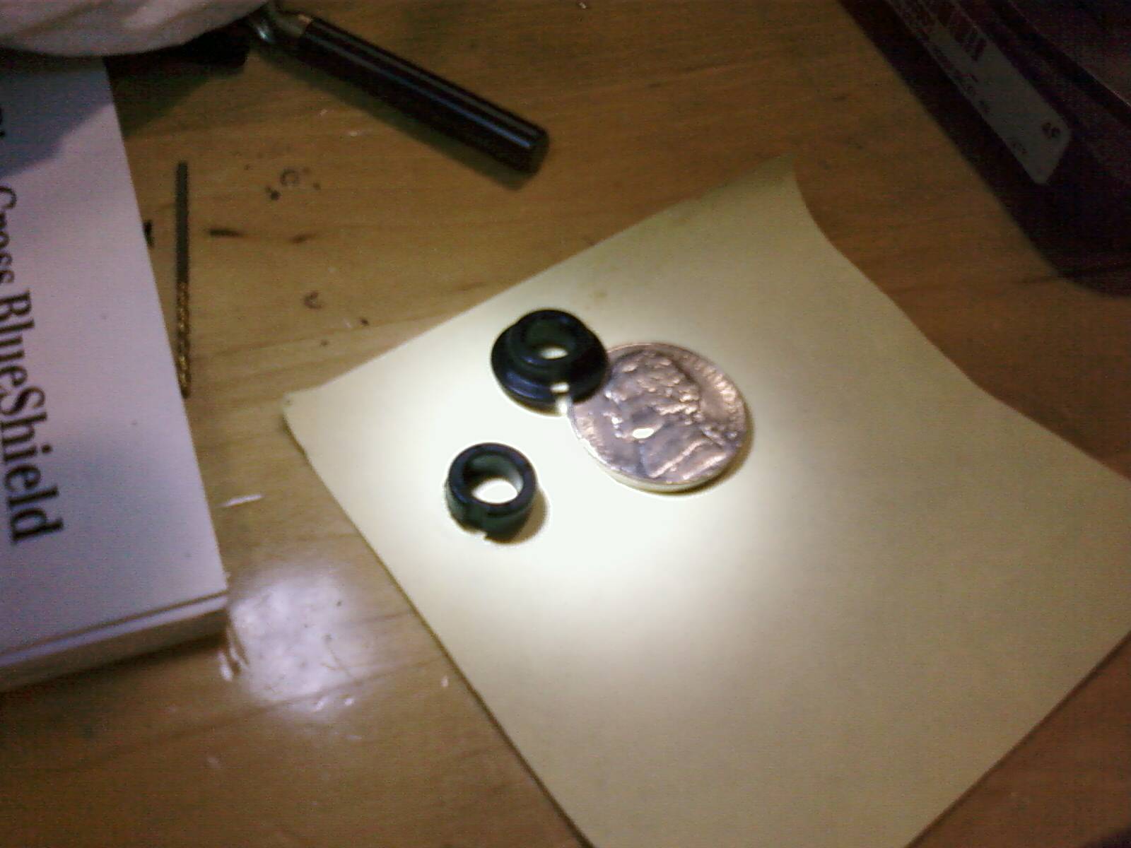

Ok it's fixed, but it wasn't easy as we had to make some small plastic parts to replace the ones that broke. These are internal on the solenoid valve. They basically encapsulate a spring to return the internal stem to its native position. Deere doesn't sell these parts except with the whole solenoid which is a Kanzaki (sp?). I guess if someone needed some, they could take the broken pieces to a shop and have them make them some. We used a high end plastic called PEEK which would be expensive to use but since we had some laying around, we used it. Plus, I guess I should have said that I work in a machine shop to start with. I guess if anyone needed some, I could maybe make them some for a small fee plus shipping.
Old broken piece and 1 good piece.
Any chance of getting two of those little spring retainers? That appears to be the only thing wrong with my solenoid, and to replace the whole solenoid nowadays is over $400.

Sounds like you have the solenoid apart.. post a pic or two of the retainers pls.

I don't have any handy, but I should be able to get some posted. I was also curious if anyone had a picture of the correct reassembly. The plastic came out in pieces so we really couldn't tell how it all went together.
If your not in a super hurry, I will try to make some in the next 10 days. I'm super busy at work right now. Wish you would have broke down when I'm slow. I will have to find the files I made them with first. Will keep you posted.

Can you tell me if it takes 2 of the little rings and are they the same? I can't find my files, but I found the 2 parts in the picture.
   / 2305 PTO not engaging #19
Glad to hear it.
Yes sir, it has two little black plastic matching rings to hold the spring in place.

So did your BIL find a decent used one?
When I get caught up at work, I will make some of them and have them available.
