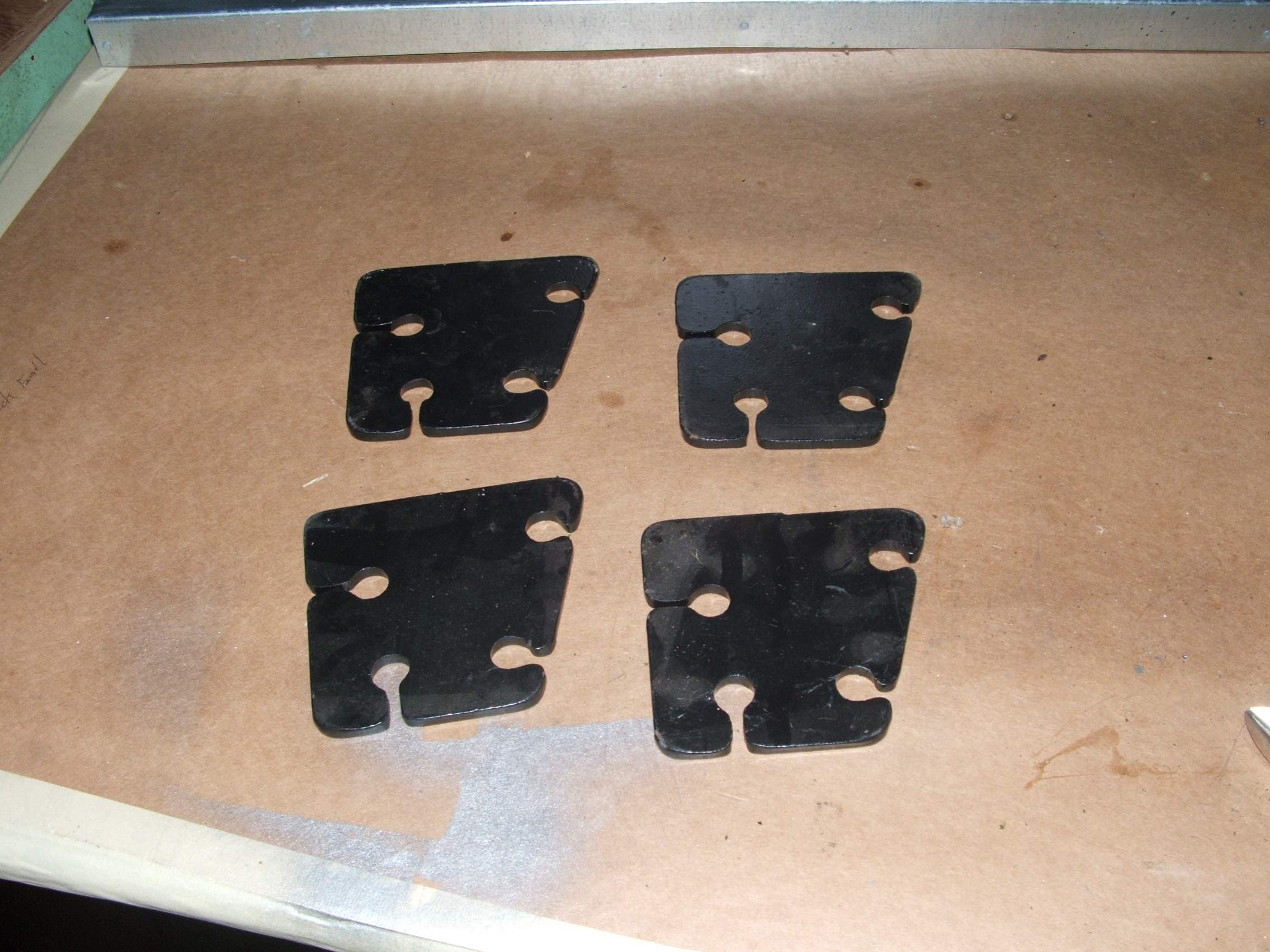

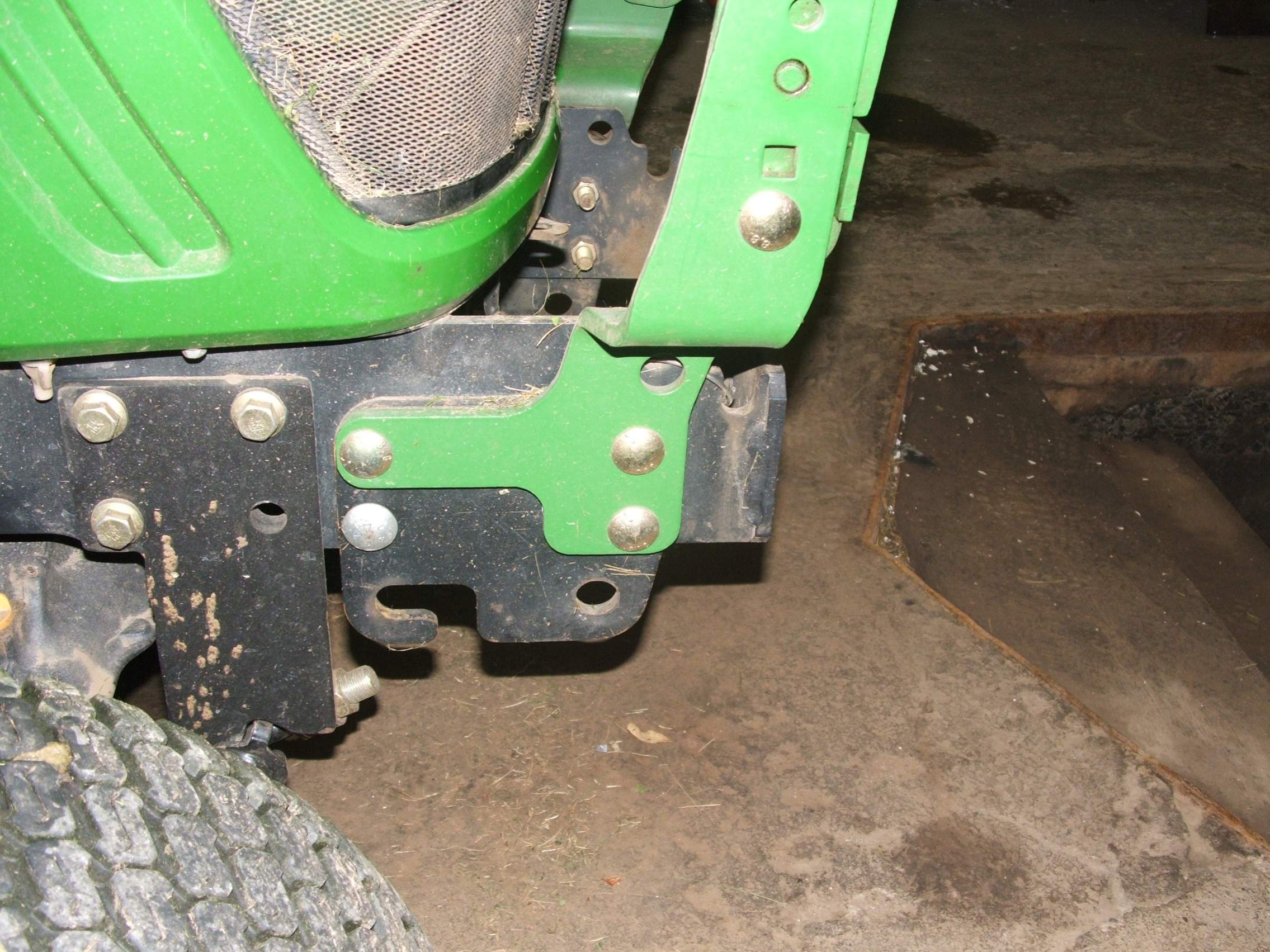

/ 2305 Quick Hitch #3
Here's a few pics. that shows my set-up. When I received my 2305 the hood guard was already install and if I recall right I had to remove the plates that you see in the pics and replace them with the front attaching support kit that came with the quick hitch. Hope the pics help.:thumbsup:

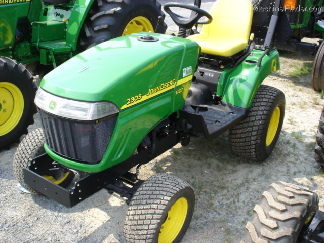

/ 2305 Quick Hitch #5

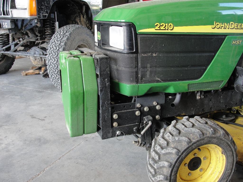

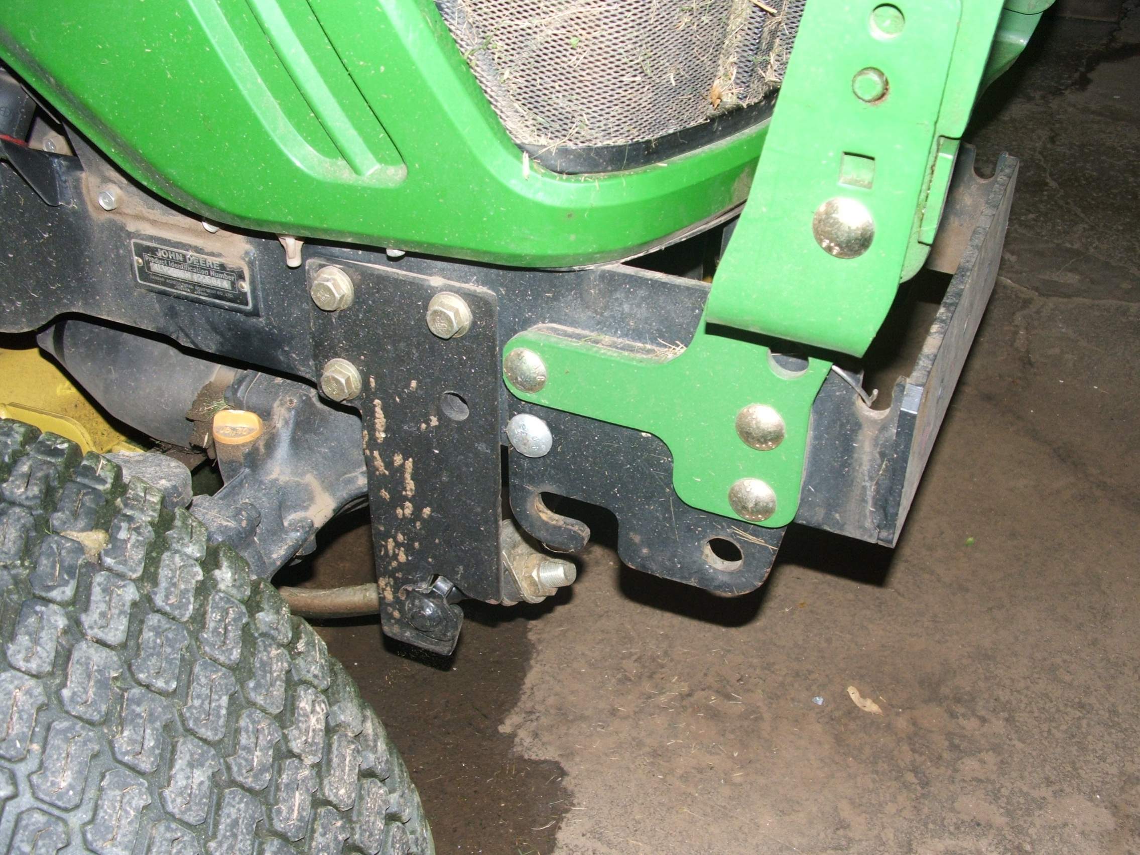

I bought my JD2210 used with a mmm only. then I bought a front blade. I had to buy a separate accessory kit to add to the tractor before the front blade quick attach would hook up. The kit included the two side plates in Henri's pics that are shown in the first two pics. The black plates with the J shaped slots in them. They were necessary to allow the blade attachment to hook to the tractor. I'm thinking that's what you are missing?? They would be in the Attachment Support Kit.
Kinda disappointed me that John Deere would sell me a blade assembly that I couldn't hook up to the tractor without buying a separate kit...... :mad:
If you look at the first pic I've attached you'll see a 2305 (same frame as 2210) with no attachment brackets on the front.
Second pic shows a 2305 with the brackets you need.
Third pic shows my 2210 using those brackets to hold my front bumper/weight rack. They also hold my quick attachment for the front blade.

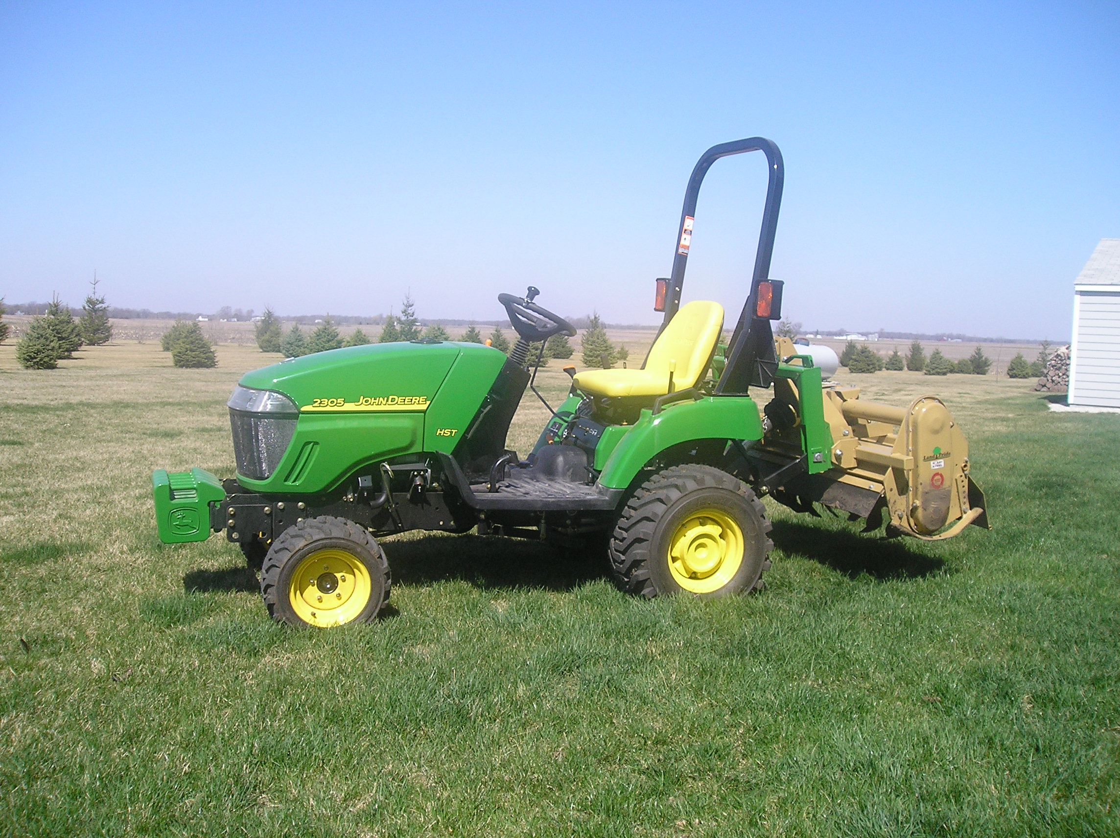

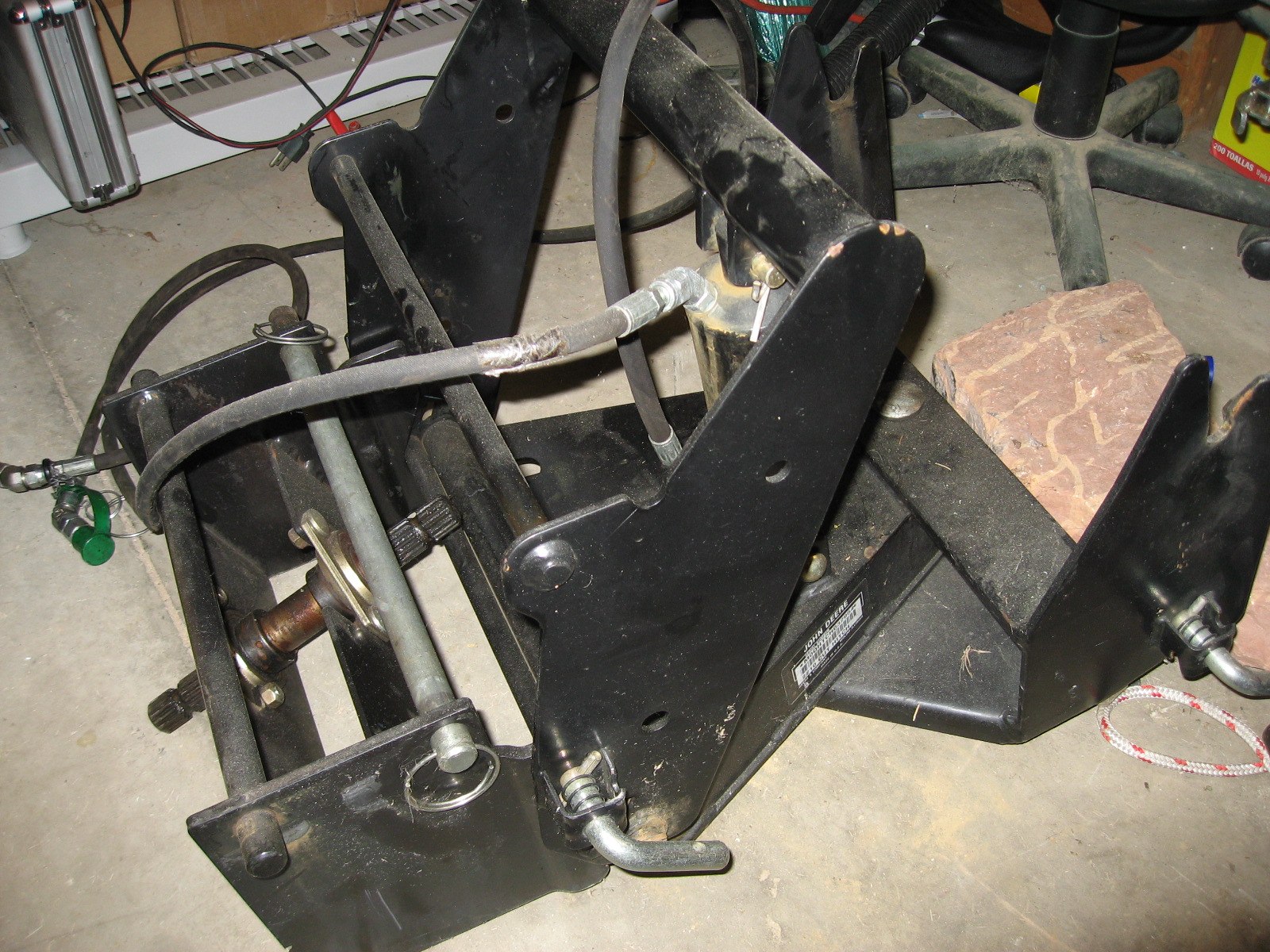

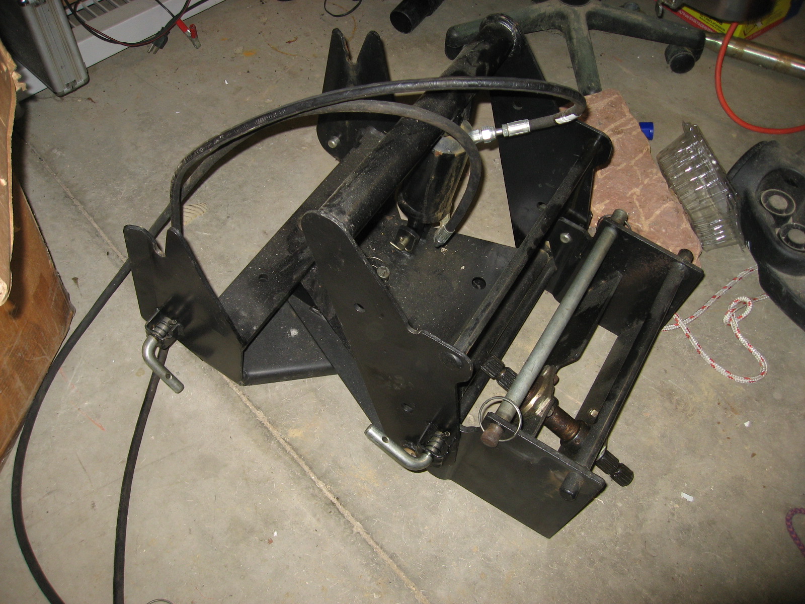

/ 2305 Quick Hitch #6

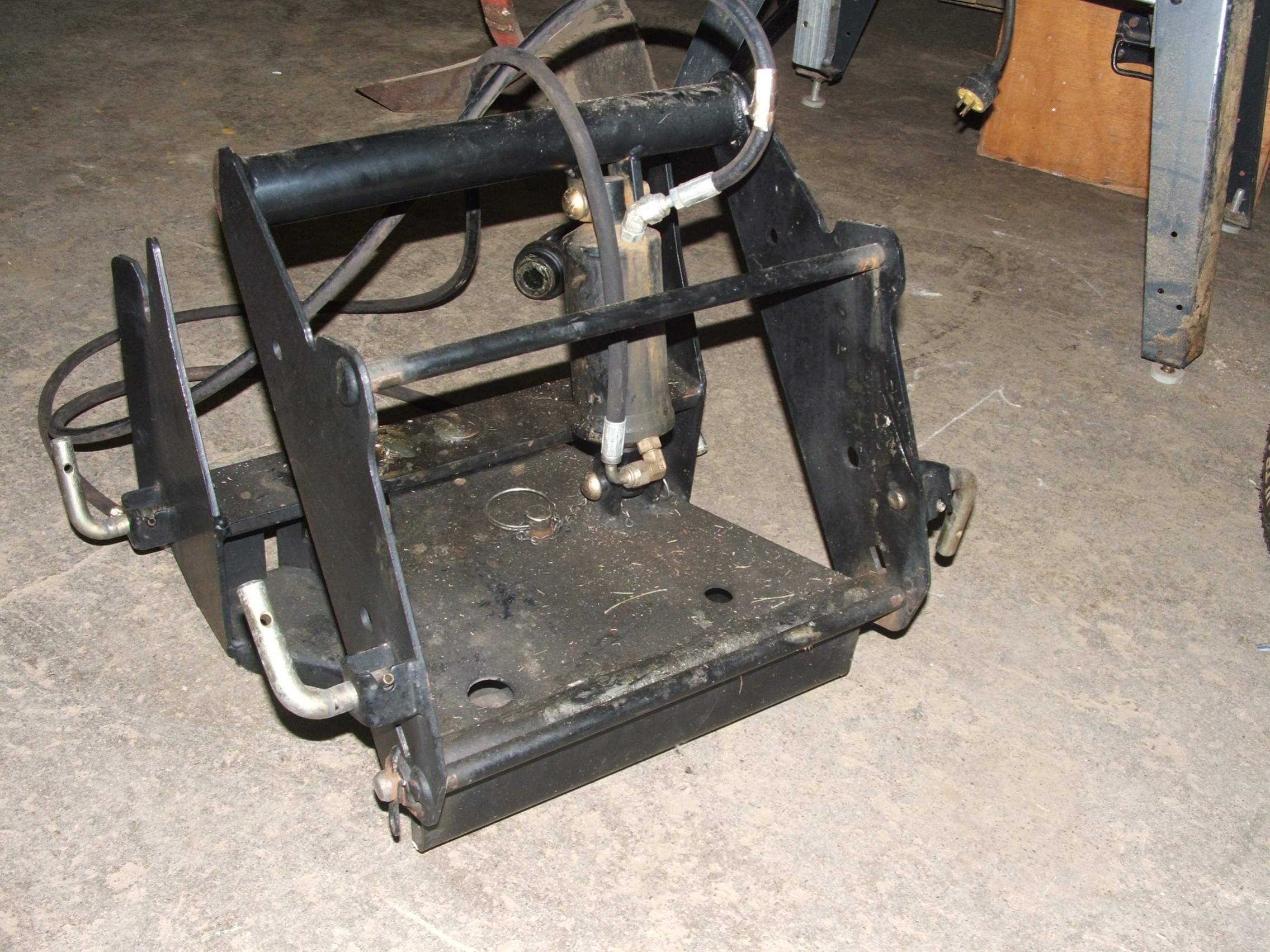

The pictures below show my 2305 quickhitch already pre-mounted to my front PTO adapter. The quickhitch doesn't connect directly to the frame, it connects to (something) that connects to the frame. I'm not sure what it looks like if it's not a PTO adapter (eg, plow only).
