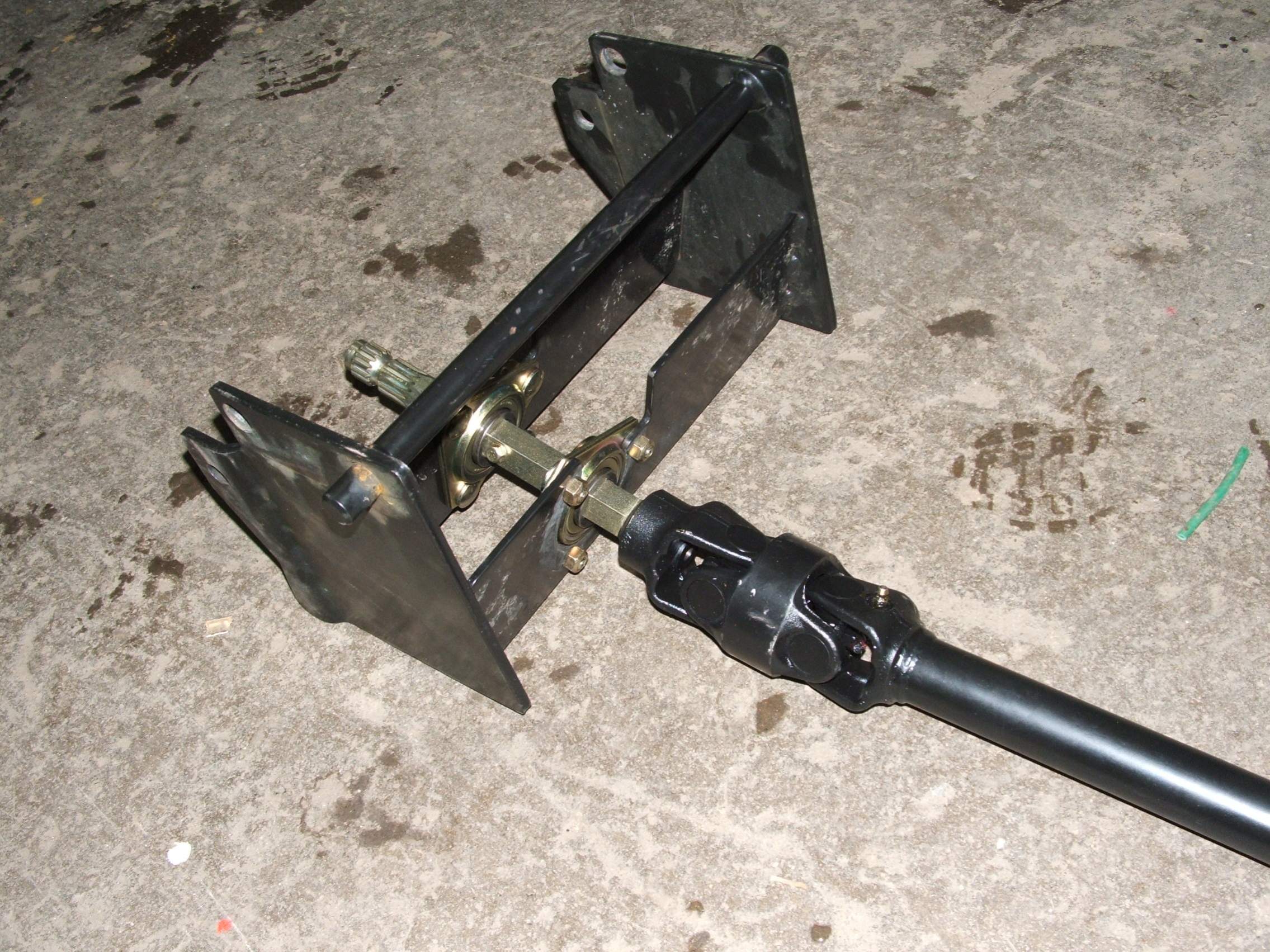

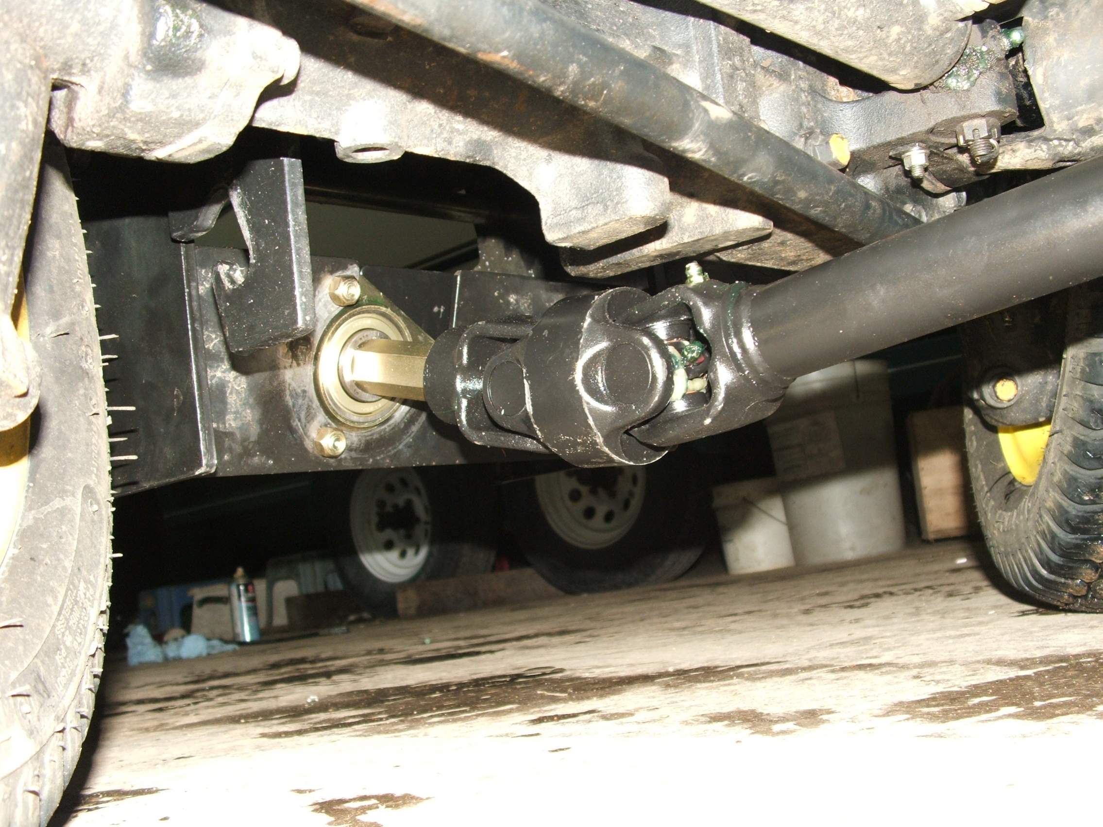

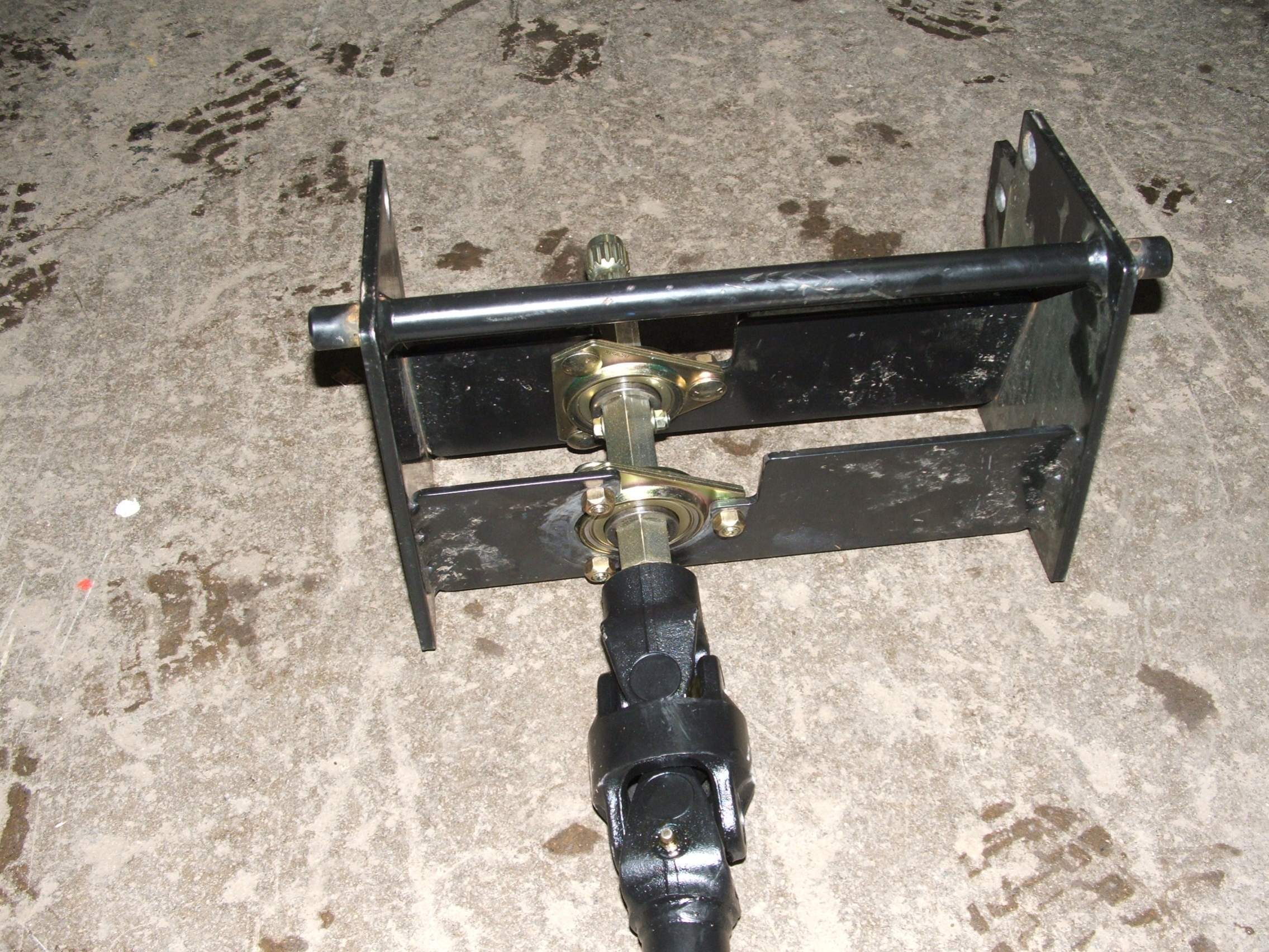

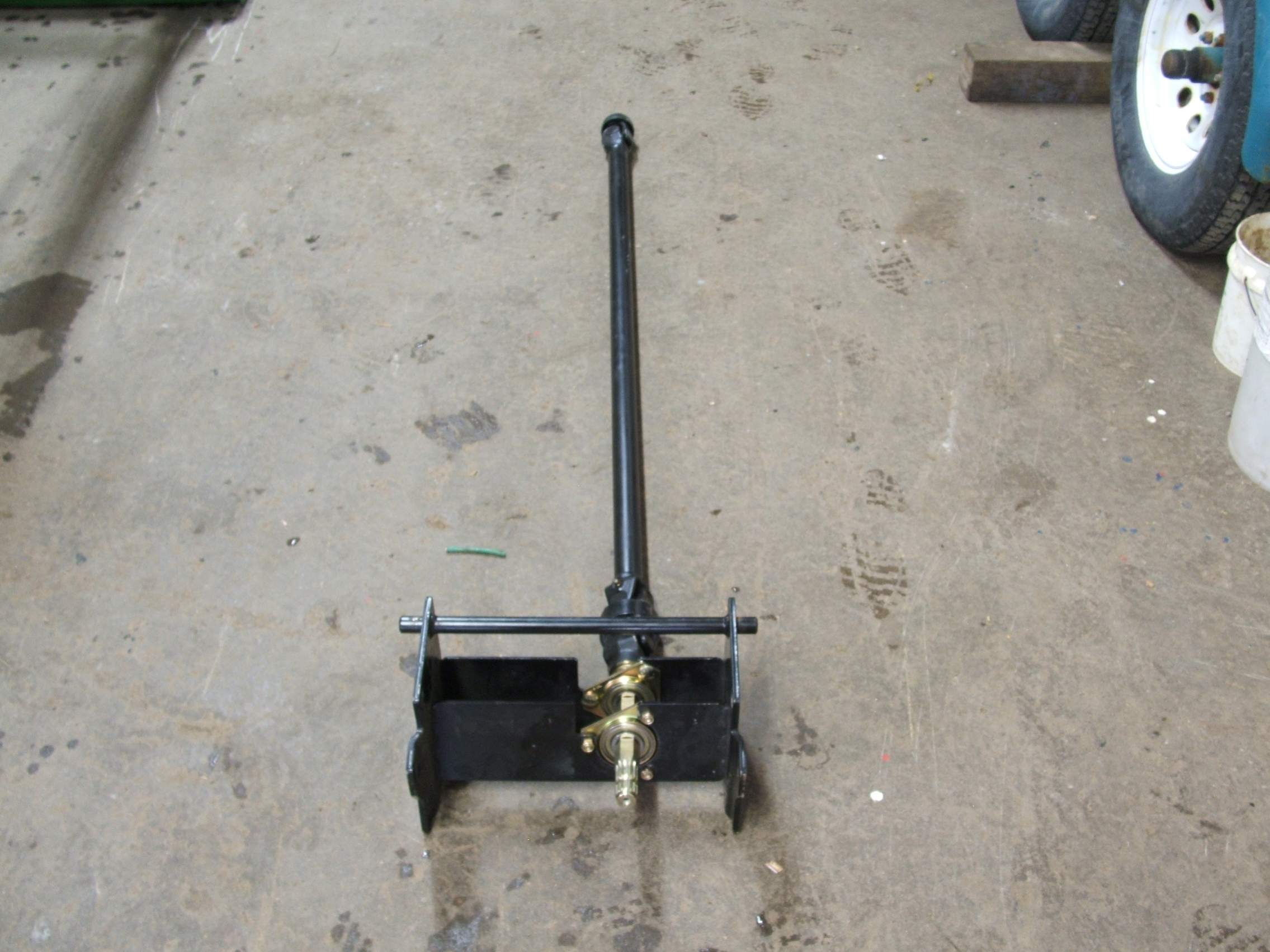

   / 2305 snowblower drive-shaft retrofit #28
where can I buy this system?
Well, here the good news,''if you can see it that way'' for a mere $338.00 can. plus tx you can eliminate pretty much all that knocking noise from your 47'' snowblower. I've just install mine and tried it out, big difference. Here a few pic. of what it looks like. The big difference is the double u-joint at one end, and the fixed shaft.
Attached Thumbnails Attached Thumbnails 2305 snowblower drive-shaft retrofit-dscf5219.jpg 2305 snowblower drive-shaft retrofit-dscf5217.jpg 2305 snowblower drive-shaft retrofit-dscf5211.jpg 2305 snowblower drive-shaft retrofit-dscf5221.jpg 2305 snowblower drive-shaft retrofit-dscf5222.jpg
