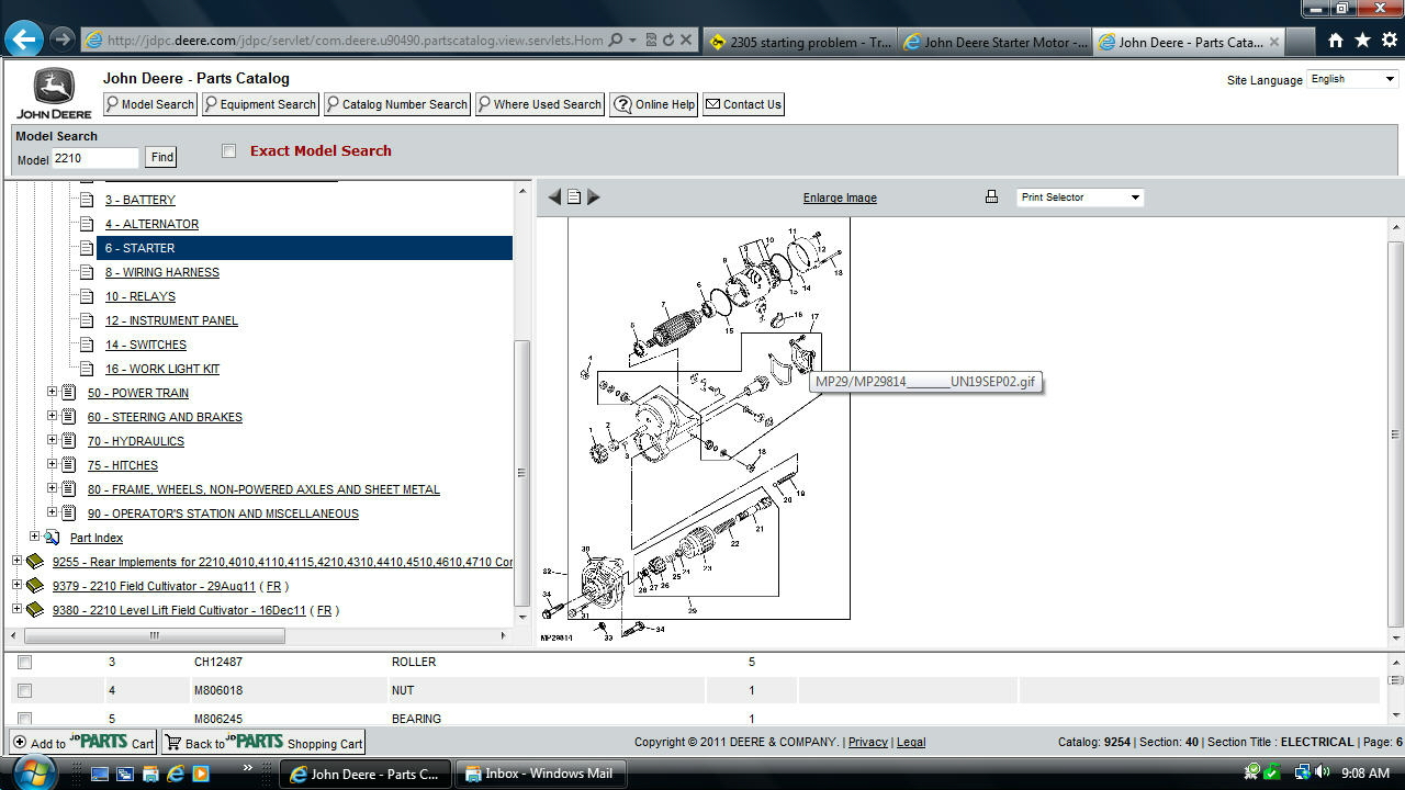

So after a few months I ad to take the tractor in. I have a starter that's going bad. Anyone have a recommendation on where to get one the dealer wants over 750 bucks which I think is steep. I'm also dissappointed this starter is not serviceable.
Thx in advance!
What is not serviceable about this starter? Looks like bearing would be available and easy to replace. check out jdparts.com and look at the diagrams. (screenshot here)
part number for the starter is am881361, greenpartstore.com has it for $702.oo

Anyone know where to get used or OEM starter? 800 bucks seems steep

Any chance you could get it rebuild?

You can't rebuild them according to JD dealer

I would still bring it in a "starter/alternator" repair shop an see what they can do. Worth a try.
