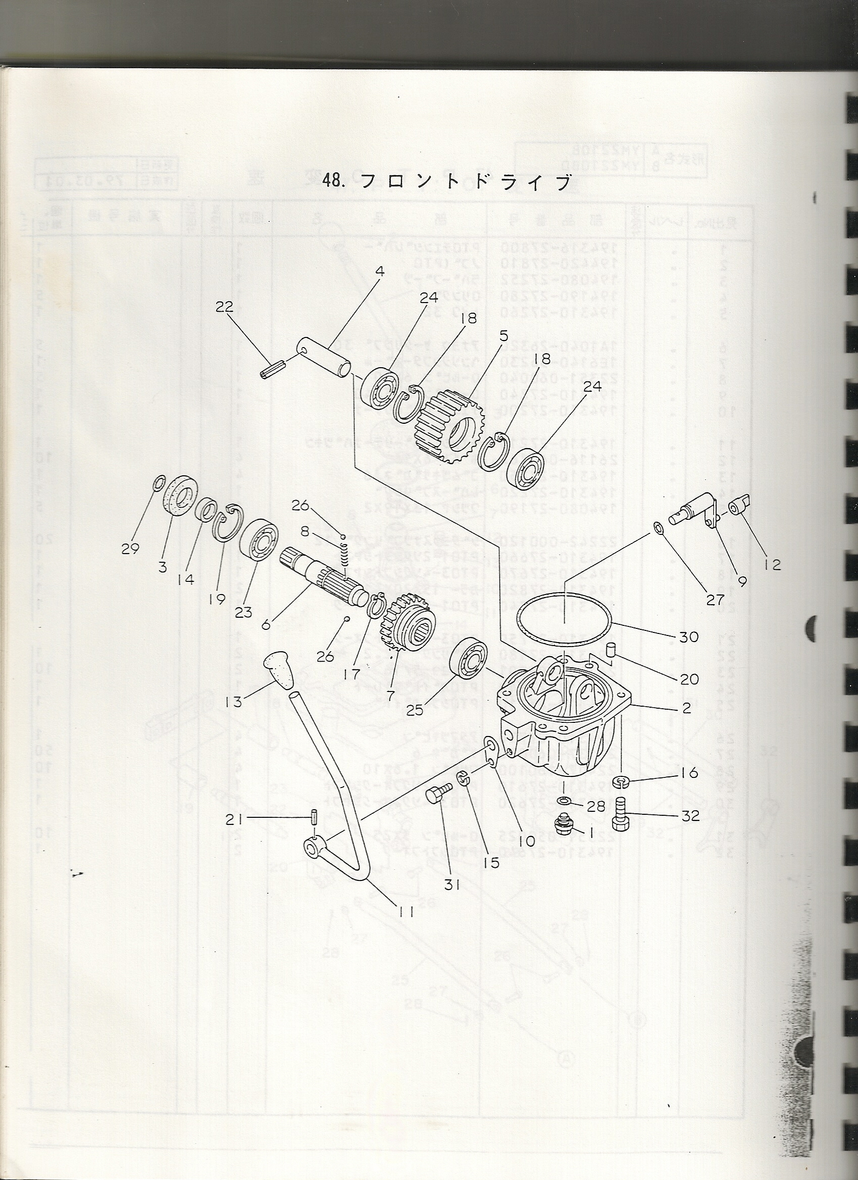

According to pictures that's the factory part. If not readily found I would heat, straighten, re-heat red hot and quench in water to harden, (test with file). If you break it after that shame on you.
/ 2310d 4wd problem #62
In my opinion trying to force one of these in or out of 4 wheel drive when gears are not aligned or in a bind is what caused the bending. If gears are aligned and not in a bind movement should take very little push.
Looks like they are listed from $40 to $100. Not sure which yours uses. Normde is telling you the right way in replacing it but cheap skate me would straighten and if satisfied I would reuse it. Not the correct way, just my way.
After taking a second look at your pictures I am wondering if the the round part the block slides over is in good condition? Picture makes it look sort of flat. Does the block fit on it ok without excess wobble?
good questions
The photo also makes me wonder if the lever was a little long to begin with ,( or shaft was to short),
and it was bent- so as to engage when actuated.
Maybe I am wrong ,but to bend that bar would take a fair amount of force... Bending it straight may make it jam up or possibly align in a way that prohibits smooth shifting or doesn't engage at all.
Can the actuation be seen some way when installed -before (modifying) the lever.

There's absolutely no way that was bent up in the Tractor without breaking something else and not showing prior damage or replaced Parts/Part. It was RIGGED like that to make it fit and work. IMHO. Apparently with no word our US parts suppliers Hoye, Fredricks don't even have a used one.
/ 2310d 4wd problem #64

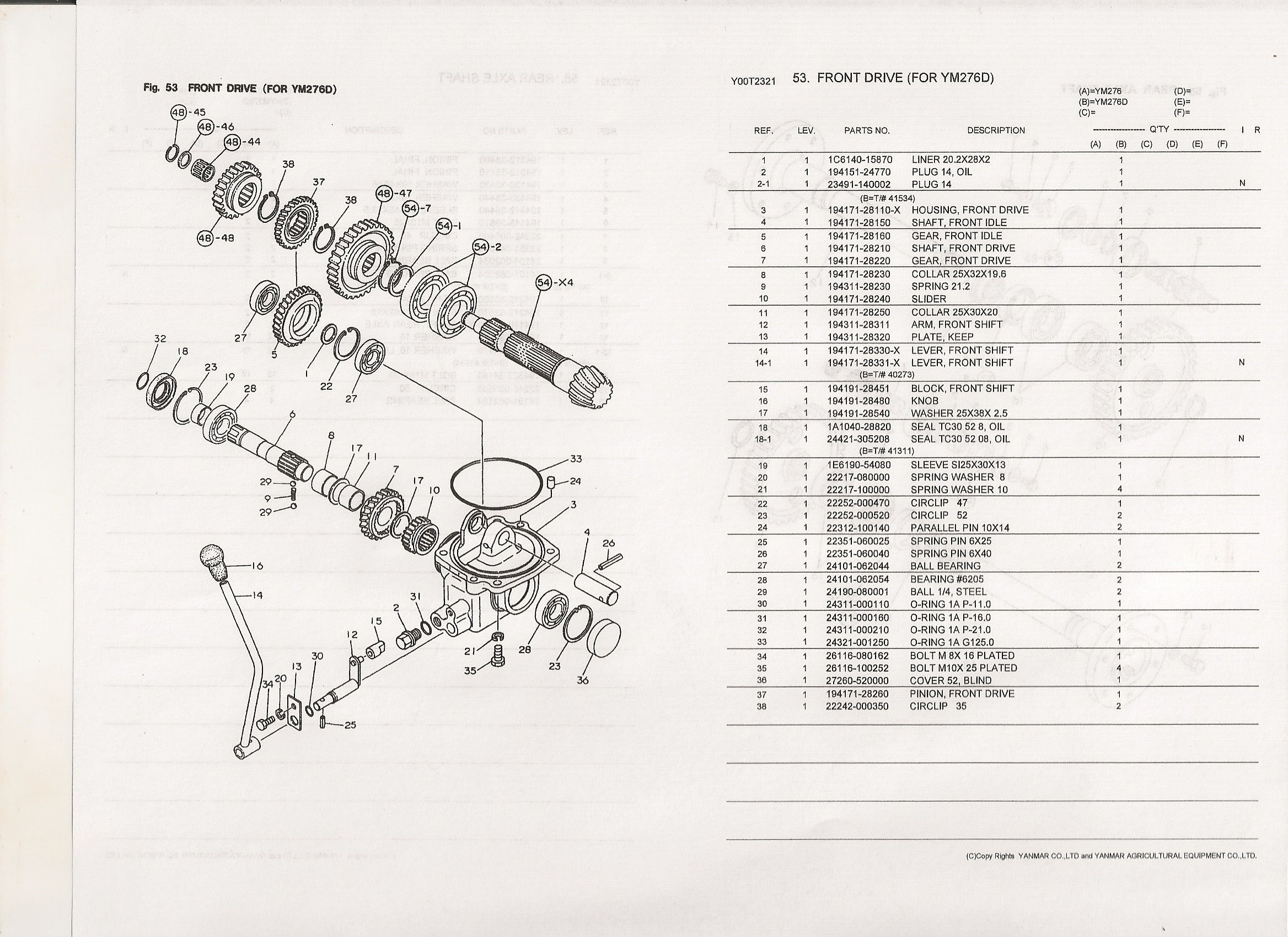

YOU NEED A SHIFT ARM. Carey is right, the wrong arm, (shaft too short), was installed, and the user had to bend it to make the bushing sort of line up with the slot. If you straighten it, it will not work at all. I doubt there is a salvage YM2310D around.
If you have a parts book, I would suggest searching by part # on Google, Ebay, Yanmar Authorized Parts Dealers, JD, and Japanese salvage yards.

If you have the parts manual you can google the part number and might find something. Also, Southern Global might be worth trying. Southern Global
