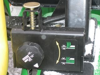

As mentioned, I don't have the independent lift, but I believe they do have a mower height adjustment system available for the 2520 with IL. Here's a picture of the adjustment knob.

I cannot speak for the 2320 or 2520 directly but I have a 2305 with Independent lift (I added it only so I could mow with the BH on, the mechanical lift works fine). The lift cylinders for ALL the decks I know of bleed down quickly so they will not hold a consistent height.
(My 3720 and 2305 are all the same and there are lot's of reports on here). You will need some sort of mechanical stop or use a mechanical rear lift. Even when using the rear mechanical lift you want a stop since you won't be able to really accurately reproduce any given height without it.
In my opinion, I'd never get the IL unless I had to/wanted to for a different reason, I thought the mechanical one worked fine. (In my case as mentioned with the BH on I have no 3pt arms to lift the tang/lever on the mechanical lift so I needed to).
   / 2320/2520 MMM question #16
Actually, the independent lift on my 2520 seems to work opposite compared to what Orlo is saying. I do agree that the bleed down rate is high but that is only when I put the deck in the raised position. So when I put the deck up and park it in the barn, the deck will lower on its own to the cut height that I selected when pressure bleeds off. So when I am cutting, the deck is already down to the selected height and can only up. What am saying is deck height will not change when I am cutting as it is already down to the lowest selected level.
