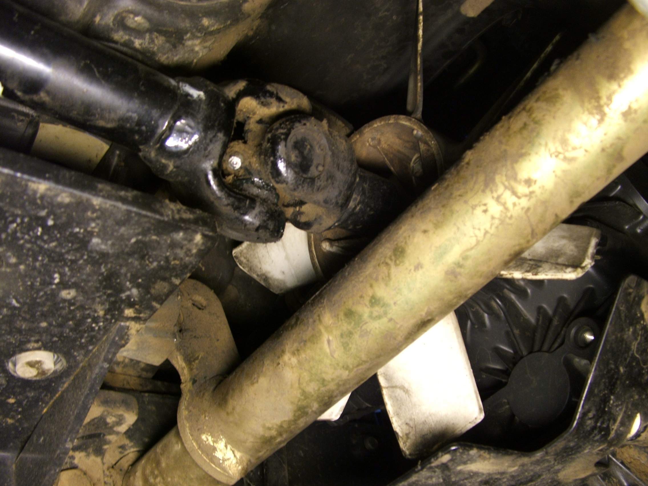

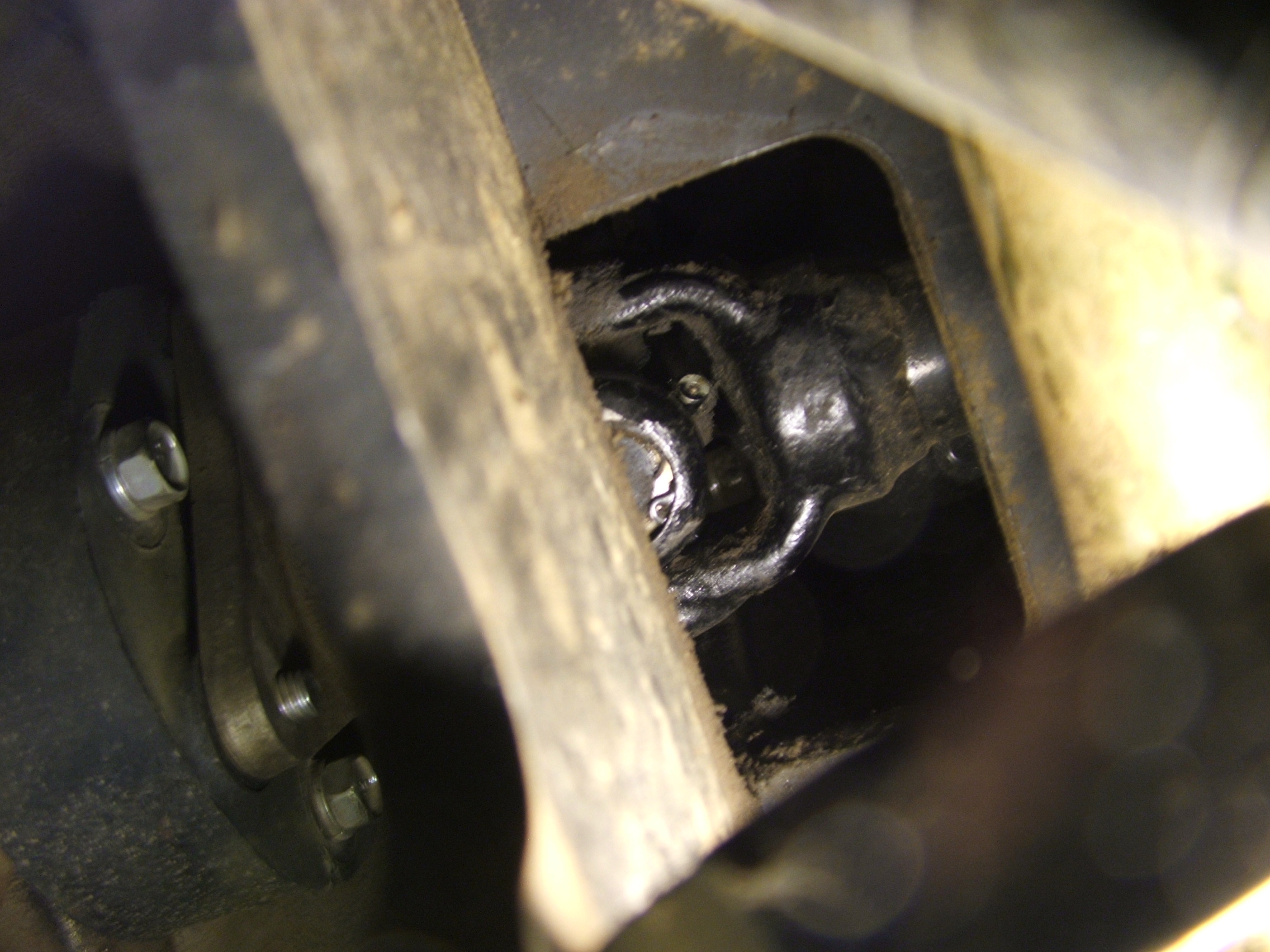

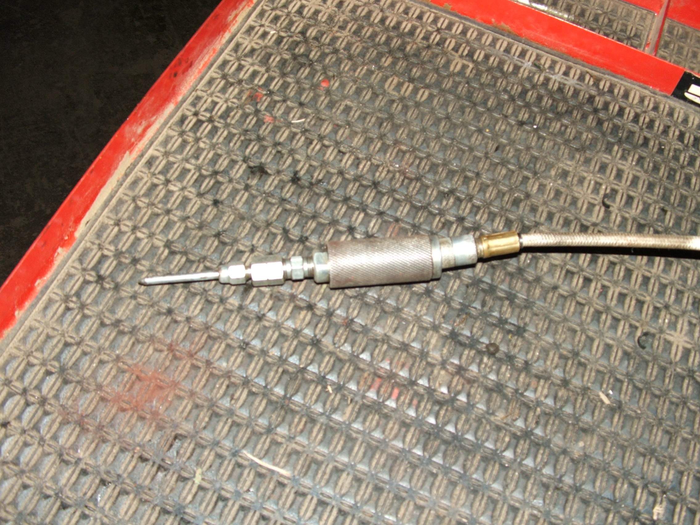

Here are a few pictures of the u-joint with the zerk. The pictures are taken directly from underneath the 2305. The manual makes references to all the other grease nipple except those 2 on the engine-hydro drive-shaft. Pita to grease them but it is possible on the 2305 using the needle adapter. I was just lucky to find them the first time I service the tractor. And you guys are right, there are no zerk on the hydro-front drive axle. :confused:

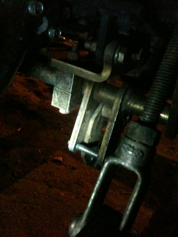

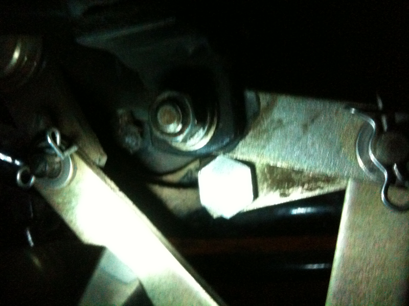

1st pic- 2 fittings on right next to the frame for hydro pedal linkage

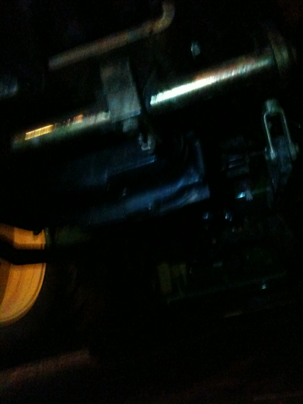

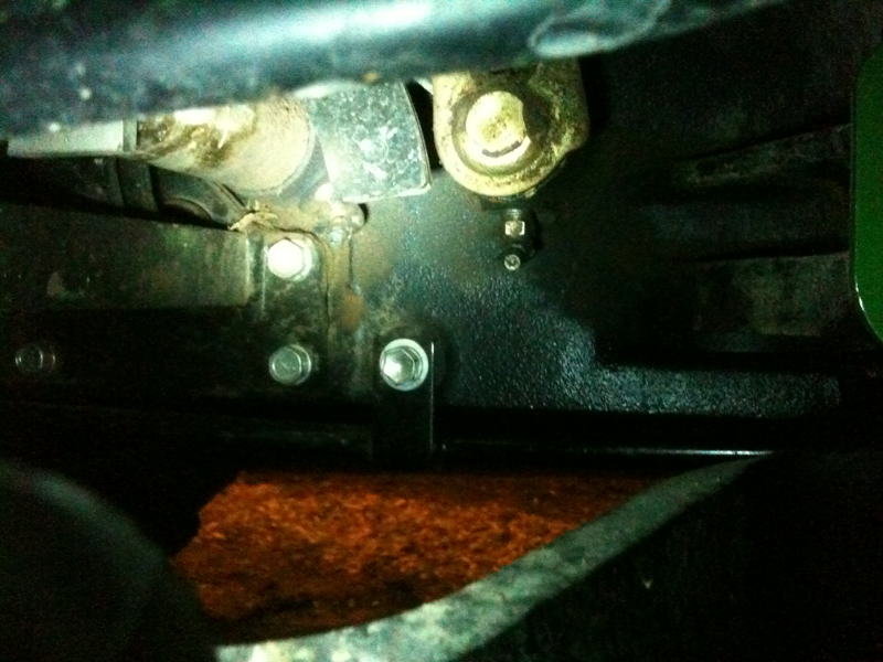

2nd 3rd 4th pic - left side brake linkage

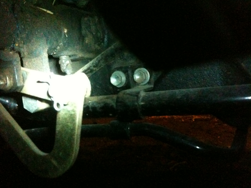

5th pic - right side facing forward, crossbar attaching point on mmm lift linkage
6th pic - left side facing rear ( same description as 5th pic)
Also, each pivot point on each side of loader.
62D-3 spindles, tensioner, 2 ujoints, pto shaft, 4 gauge wheel axles, front 2 gauge wheel pivots
If u can't find them let me know an I can get better pics
While on this subject, does anybody else have trouble getting the front axle pivot to "take"? My battery gun will bypass before it builds the pressure to get it greased, have to keep grease in the old pump gun just for this one.

The 2520 does not have ujoints in the driveline to the rear hydro unit like the 2210,2305 and 2320 have...This is the items in question..
