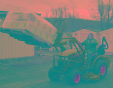

here is a picture of a 2320 with a pallet of
about 900#. it was all she wanted!
