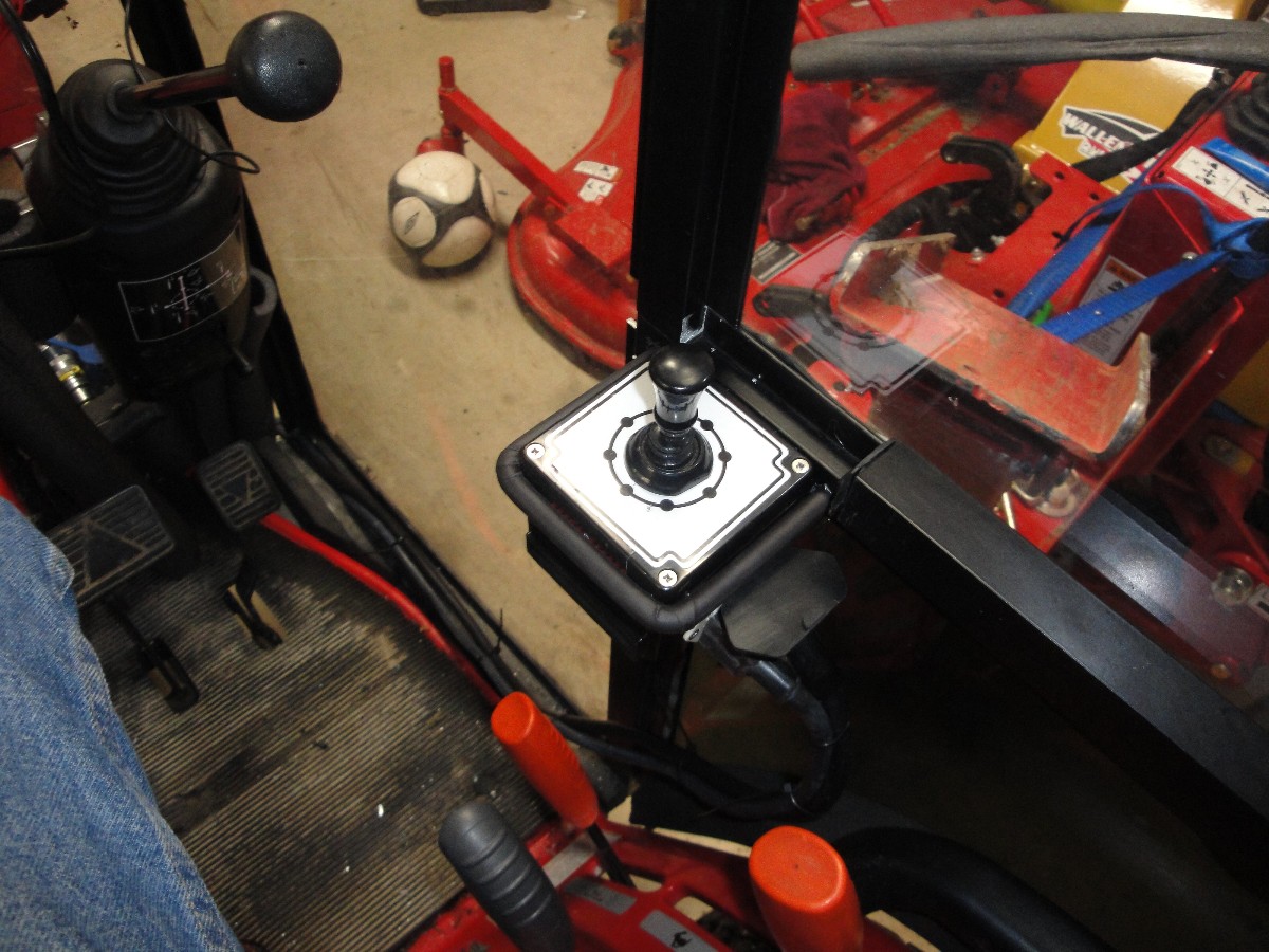

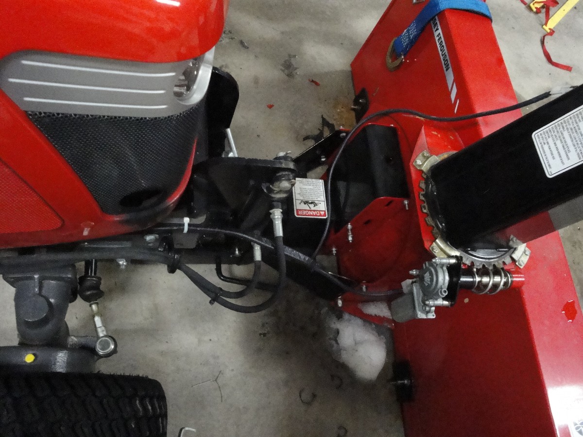

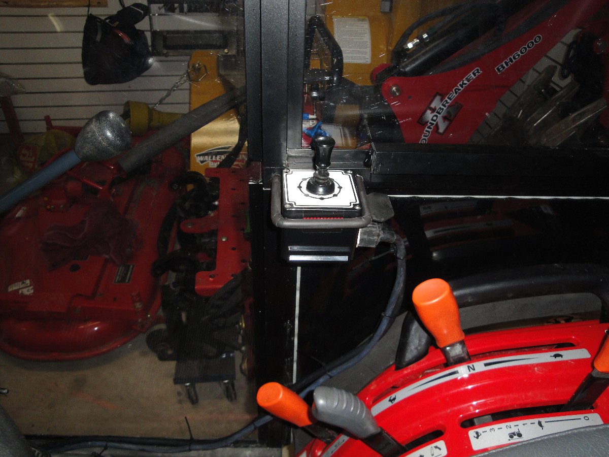

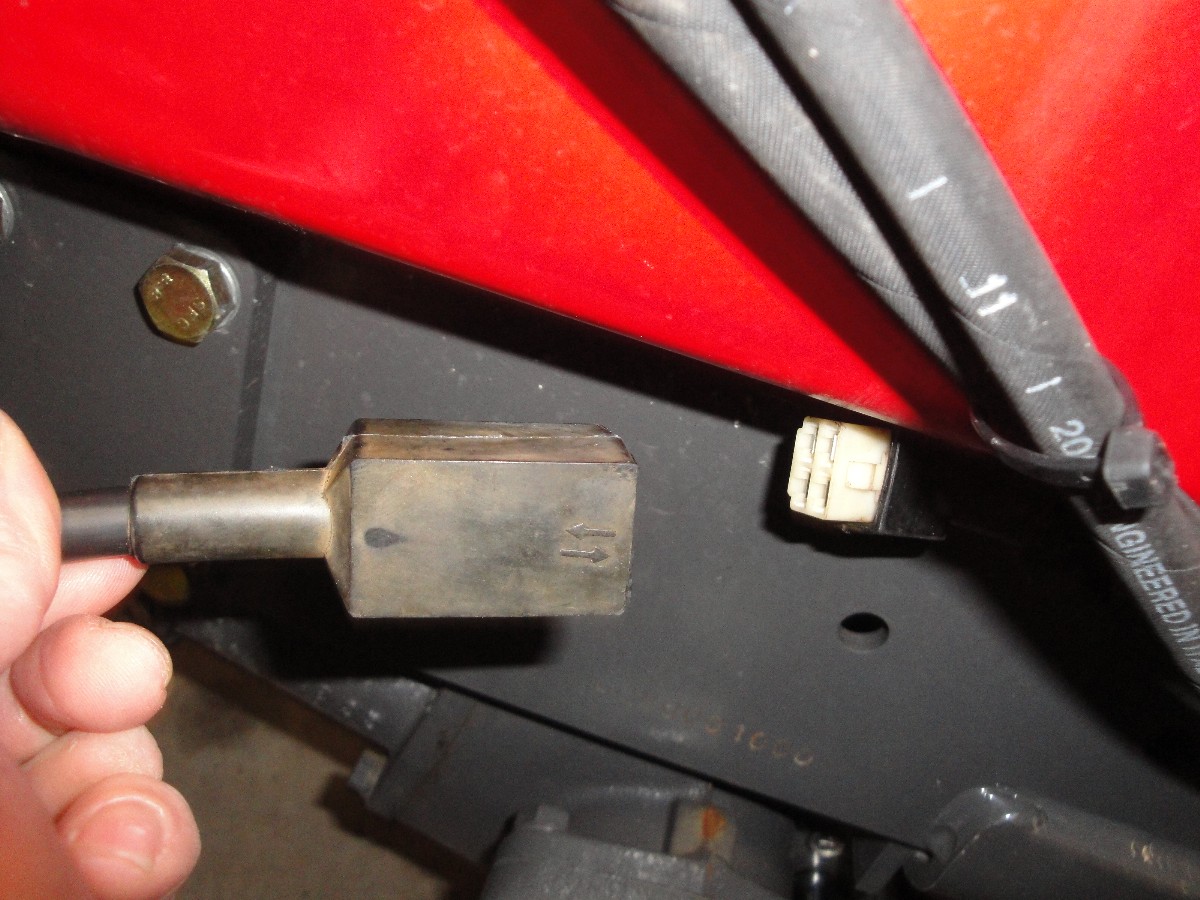

Just to report back about the Bercomac Joystick blower controls I installed today to replace the Massey toggles mounted on the instrument panel. I went looking for a different setup due to it being necessary for me to operate the chute and deflector very often in the course of snowblowing and I never really warm up to the Massey controls as it took two hands to operate while hunched forward somewhat.
The Bercomac connectors are a direct fit for the massey motor connection therefore there's no cutting and splicing required which was a pleasant surprise. Unlike the Massey wiring being protected with a plastic corrugated wire loom the Bercomac wires outside covering appears to be rubber and integral to cable itself. The wire connections (apart from the motor connections) are designed to be water resistant if not water proof with rubber boots which is a nice touch. The joystick mounted control box is solid and wont' be falling apart any time soon. Overall I'm very impressed with the Joystick kit, the joystick itself is an 8 position unit allowing both chute and rotation to operate simultaneously in any direction and the installation was a breeze (removing my old wiring system took more time than the new install due to accessing the toggles switch in behind the instrument panel).
I mounted the joystick to the right side of the cab using a square U-bolt fastened to the cab frame by first covering the U-bolt with heat shrink for a little extra grip. Anyways so far this kit is impressive and an excellent substitute for the Massey kit for those looking for this type of one-handed control. Below is a few pictures of the installed kit.
Man I love that setup-cab and snowblower :)
   / 2360 snowblower electric chute deflector #40
Thanks, all I need is a better heating method since one of two my small 12v auto heaters went out a month ago. After being introduced to the effectiveness of seat heaters in hockey rinks I think I'll just add a heated seat cushion and keep just one electrical auto type heater for defrost purposes if needed.
