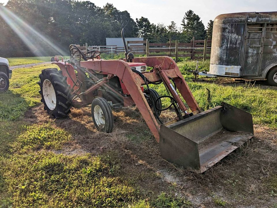

That looks like 2wd. Why isn't it sunk to the frame?

She has lots of stuff to sell since her fellow died about 2 years ago, including this 240D all setting outside and rusting away. I asked about it here to see if it was serviceable and practical for our needs. She did say she had someone interested in it, but now you guys got me somewhat interested. o_O
   / 240D for sale #23
I think that Yanmars that vintage are incredible solid, simple machines. Absent a cracked frame or block, they are, as @California said, simple and easy to fix. They were built to be daily drivers in Japan, doing everything necessary to farm small plots, with very low technology. I think that they are gems. At 400 hours, it is just getting broken in.
I would expect to change filters, fluids, a few hoses, and some of the wiring. If I were closer, I would buy just for the fun of it, and to rip my subsoil up.
No idea what a fair price is. Pricing can be very local. In my own book, "As is, where is", is a lot, lot, less than "running", and that is less than "recently overhauled", and for me, a piece of equipment that I can go get and bring home myself in less than day is worth a lot more than one across the country. I would try to get the attachments and any tools or filters, or parts that her husband had as part of the price. I would buy it "as is, where is" lest tinkering cause any backsliding on price or ownership.
Good luck! (And put a ROPS on, if you getting running.) I think you would have fun with it on trails, too. (Just watch for cross slopes!)
All the best,
Peter
He's surely running a rototlller so its like he has 16 wheel drive, to keep moving.
I wonder if centuries of tillage has left a layer of hardpan beneath 8 inches of permeable soil?
... But in this case he still has to have the respect of the widow neighbor after he has it up and running. Therefor my suggestion to tinker with it, to better appraise a fair price and not lose a friend.
If you have $3,000 cash in hand to offer her, I bet she'll let it go.
The fuel sat for a while, so purge the fuel bowl, drain the tank, add fresh, bleed the lines to the injectors would get the fuel side flowing to start. I would also open the air cleaner box to ensure o critters made a winter home in there for the past few years.
Since you are just north of me on US-41, I would expect the clutch to be stuck. There are tricks to un-stick the clutch. If the tractor was parked in neutral, a stuck clutch isn't too bad to start or to the YM240 onto a trailer. The only problem would be stuck rear brakes.

I'll speak with the owner about its sale. We are heading back there to clear her driveway of brush and I'll ask if she like her "field" mowed which is rapidly growing back to woods. She did say it needs to be mowed but the Yanmar being mixed into the deal is a new thought.

Has broken hour meter. Auctioned for $1050.

The husband might have had a friend who is more familiar with his tractor that could be trying to buy it.
I see older Yanmars listed for sale in Middle Tennessee on a fairly consistent basis every year. They don't sell well here and the prices seem low because most people want larger tractors for their farms. Large tractors are good for farms, but not so easy to haul or turn around on a woods trail.
There was one that was advertised for $1900 with a cutter that sold recently. The ad said there was an issue with the lift which was likely an O ring seal that needed replacing. I've seen others in the $3-4,000 range.
Most of these 40 year old tractors are going to have some issue or another, but they do come up for sale if you watch for them.
