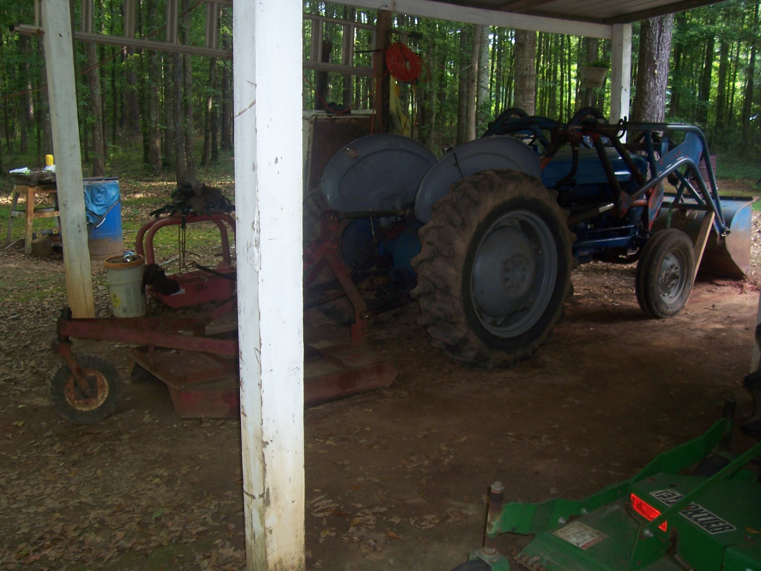

On this property I used a rear scoop on the Yanmar YM2000 for decades. Had a FEL on a JD. that was just a couple miles away. Never had to move it over here though. Seen the Ford tractor on CL. 2500$ with the loader is what I gave for it 63-2000 gas. Loaded rear tires so no need for 4WD.. The weight is has to be huge. No problems with traction even wet!! Just need to replace the front grill and fenders now. Been through everything. 12v new Ing.points, Clutch/P. Plate etc. If I do find and replace the body parts I may paint it. So into it with my time and 1600.00 in repair/Parts. Plan on keeping this one. The cool factor is off the chart!!...

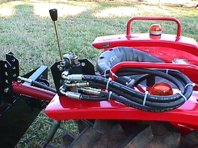

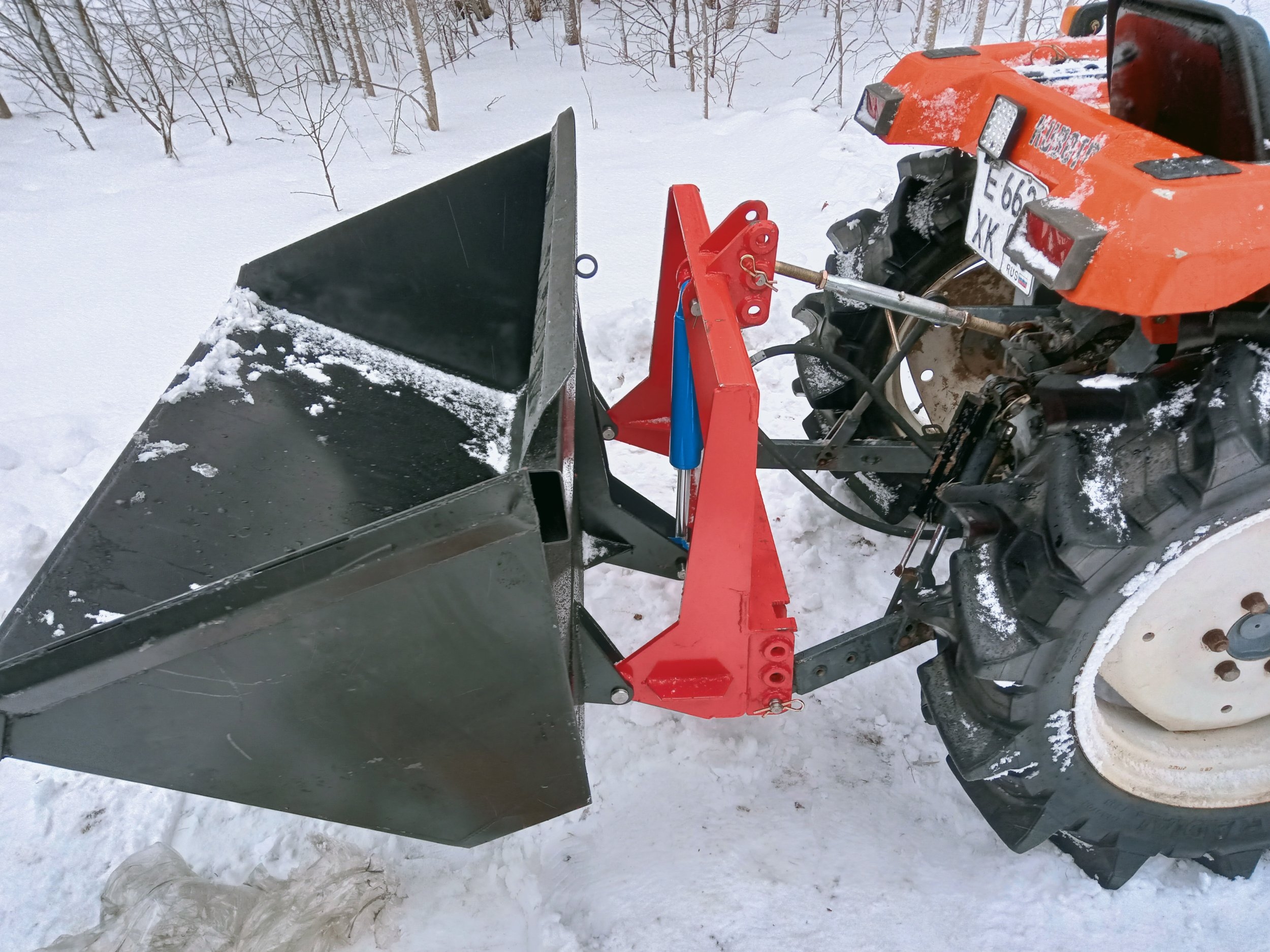

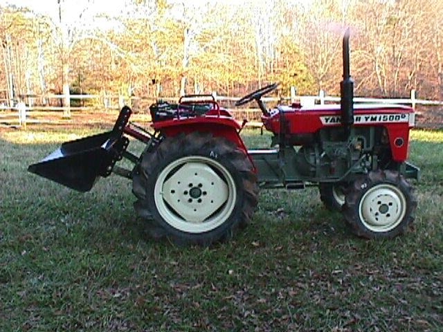

Pond scoops are alright. They do have working limits.
A REL behaves like a FEL, with the exception the vertical height is limited.
A few SCUT Yanmars used them as well, typically less than 1/2 the price of a FEL.
For my use, a FEL is bulky and take time for removal off the tractor. There isn't much need for the FEL on my farm to be lifted very high. A REL or pond scoop would satisfy my needs overall and quickly change out.
As the OP is living in winters of feet of snow vs us at inches of snow, a REL or FEL is to be considered.
