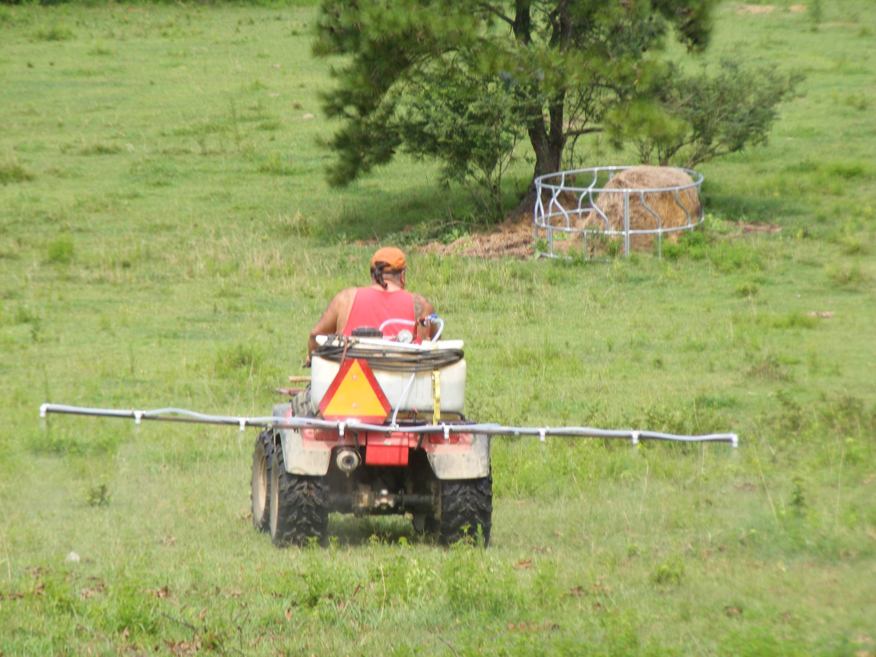

I have one that came from Northern tool. It has a Northstar pump and came on a 15 gal tank. I bought it about 12 or 15 years ago. I had trouble with the first tank and replaced it with a 25 gal. Still using the same pump.
My dad bought a 15 gal Fimco sprayer. First one lasted a couple of years, pump died. replaced the pump and it lasted one summer and the next spring it was dead. They didn't have just a pump so he bought another entire Fimco tank. It was the only brand they had at the time. It lasted the summer and was dead again the next spring.
Maybe I just got lucky but my Northstar has been great and I would definately buy another one. I even built a small boom sprayer for my 4 wheeler and run it with the same pump. I have 50' of hose for my spot sprayer which is handy when you need to walk around. I came off the main line with a "T" and plumbed the boom. It's nice in the pasture to have both. Spot spray small areas and flip the boom on for big places.
