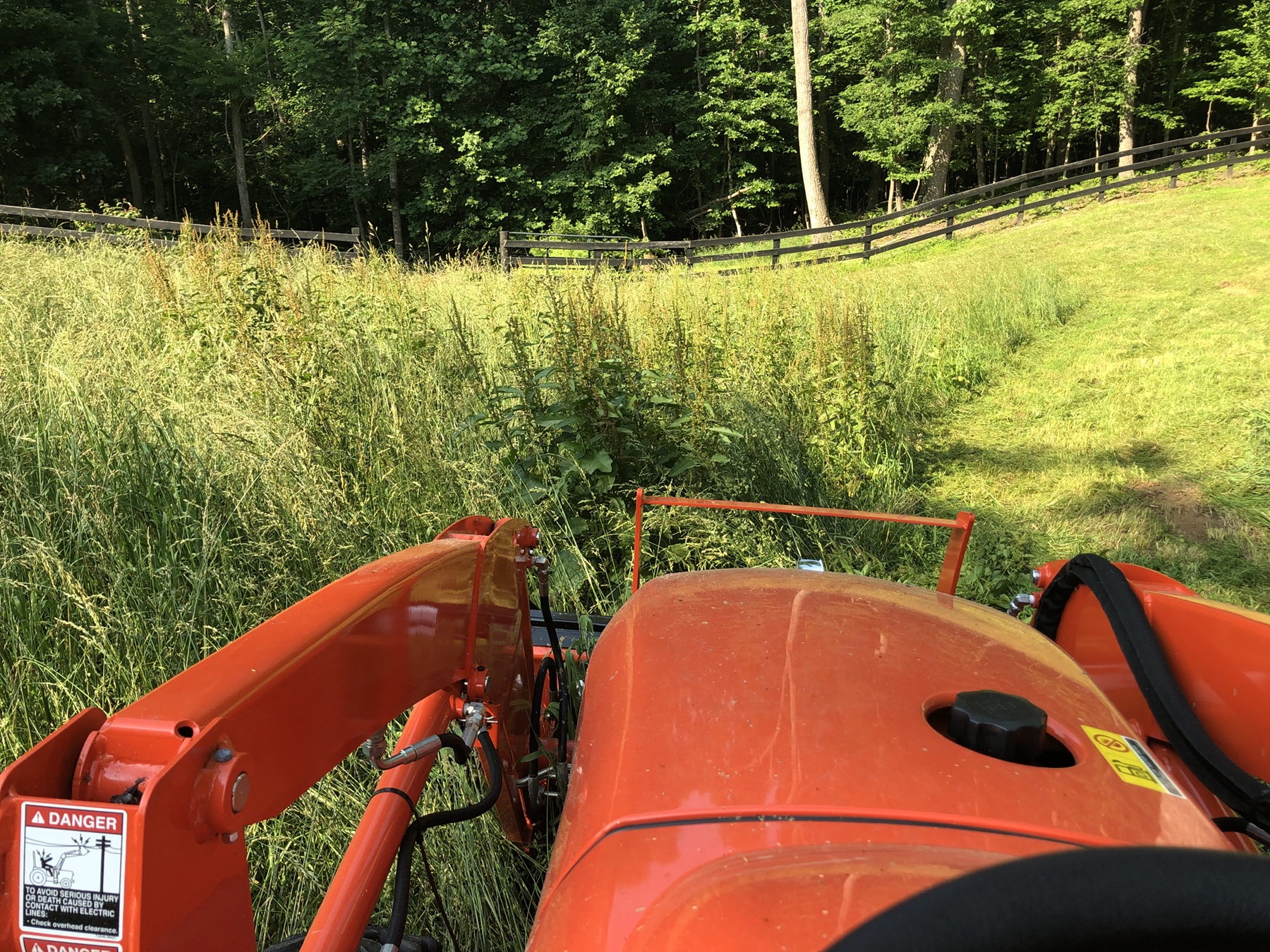

I mowed this with a L2501 and 5ft bush hog. It did great.
That looks to be mostly weeds and grass stems which are relatively easy to cut compared to shredding small trees and brush. No doubt you can do it with a 25 HP or less tractor but how slow do you go. Cutting 1.5+" saplings is hard on the PTO shaft. I would want the biggest tractor that is practical for the job.

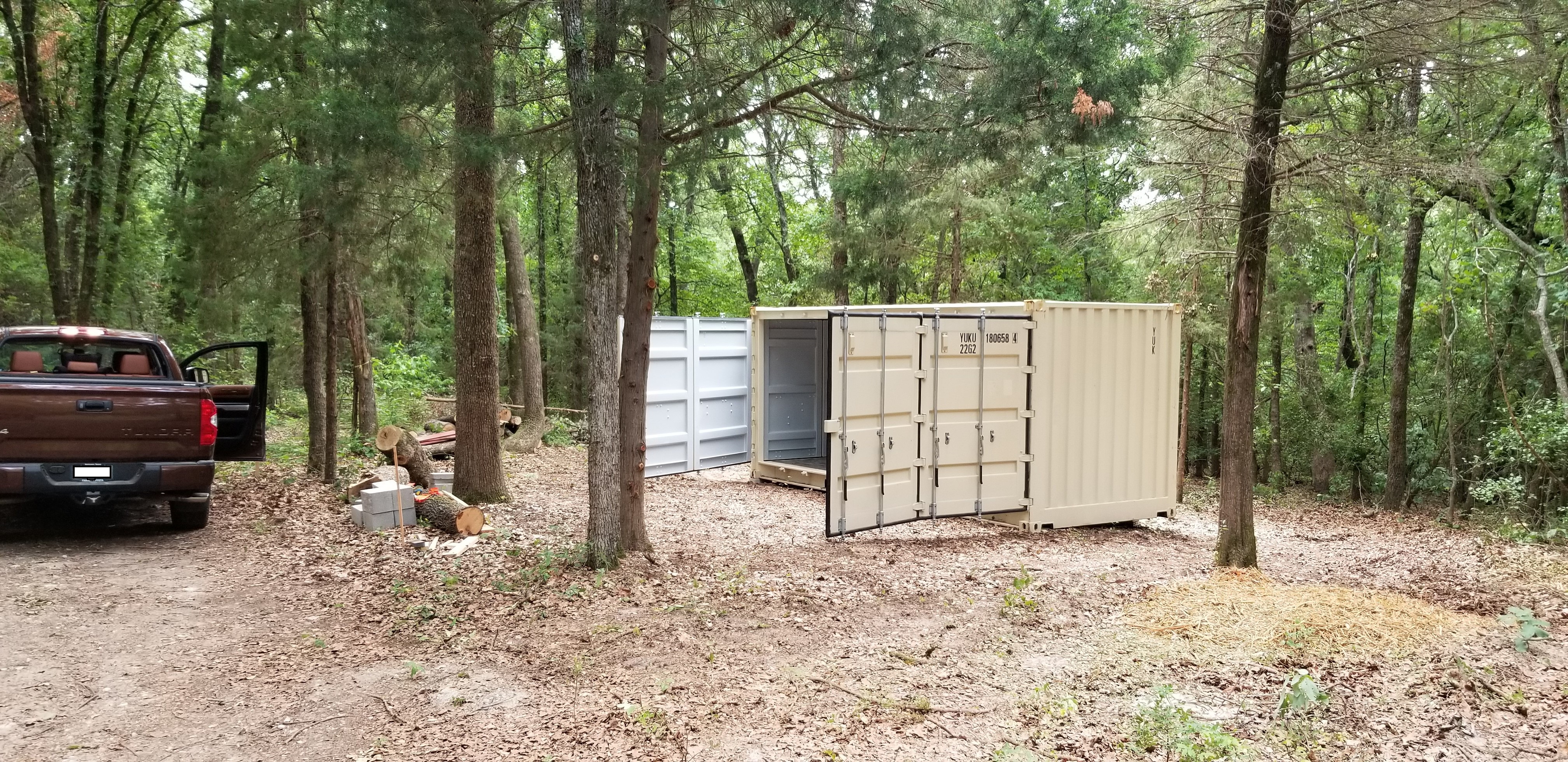

I moved 40 foot empty shipping containers with my 75HP New Holland and it took all it had. I'm not sure how a 25HP tractor of any brand will handle a container.
Just my thoughts
Andy
   / 25 HP vs 35 HP #80
Just my thoughts
Andy
Where did that idea come in? I agree it’s not happening with a 25 hp tractor.
