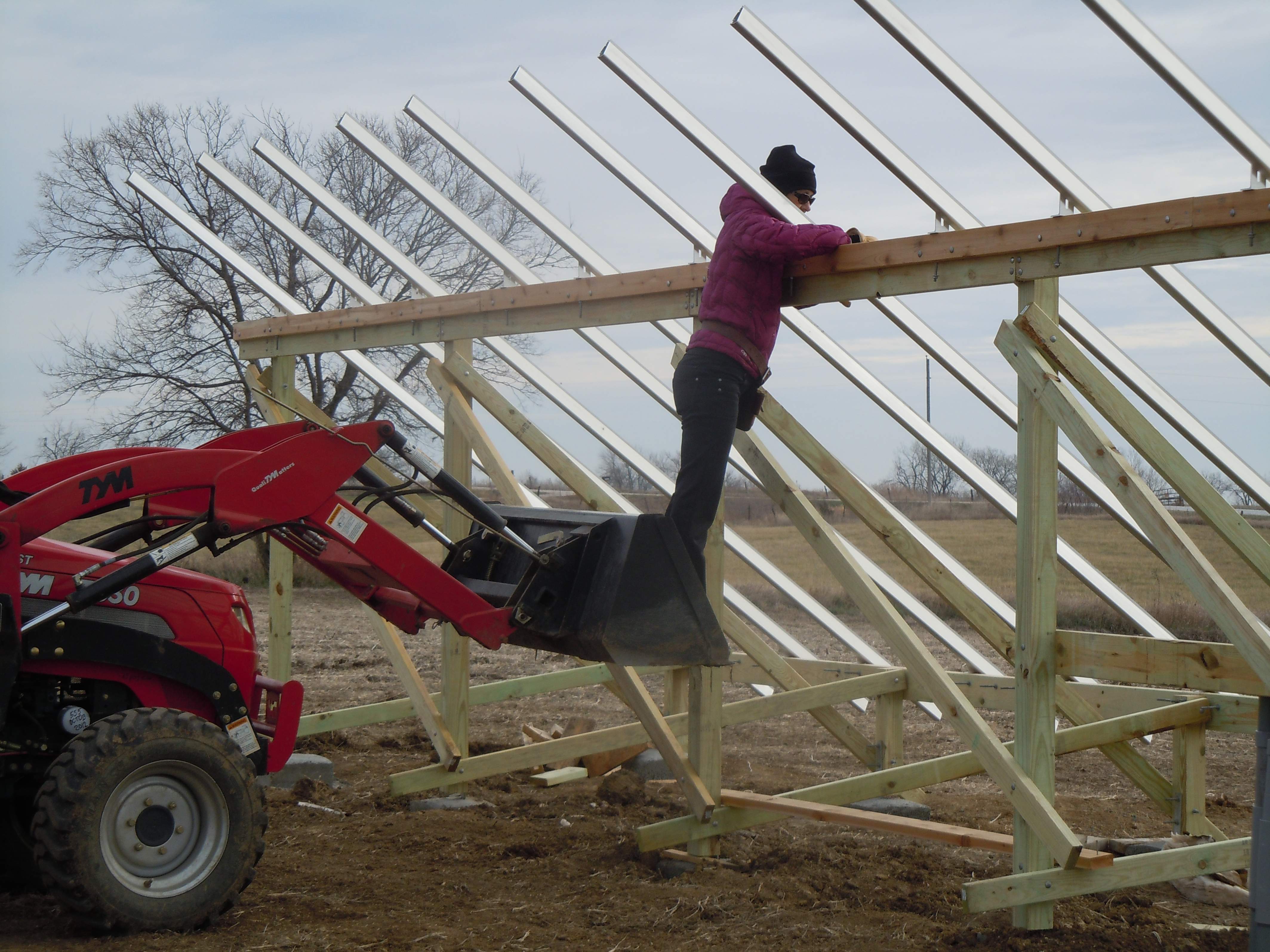

Yes, wind loading is an issue here. The footings are 5ft deep poured concrete about 80" apart. The wooden structure is all braced and bolted together. I went to Unirack web site and designed the racking on their program and then made it out of wood. There is room for four landscape rows but I will install only three lower rows on each bank.

It's virtually identical to yours, except that I just sank the posts 52" down and poured one bag of quickcrete as a collar, then backfilled the holes. We have very sandy soil though, so the risk of rot is minimal. I have pulled 40 year old fence posts out of the ground that are still 80% intact. Pretty sure I posted a picture of it in this thread somewhere. The panels themselves contribute a huge amount of strength and rigidity to the structure.

Our soils is clay so frost heaving and shrinkage during drought is an issue here. When we have a dry spell like this year the smooth posts could be pulled out of ground by little force. Therefore I decided to use poured footings thinking they would be much harder to pull out of ground due to large area of contact with soil and also larger mass (each footing is estimated 400-500kg), bolt the racking to it and brace it in EW and NS direction.

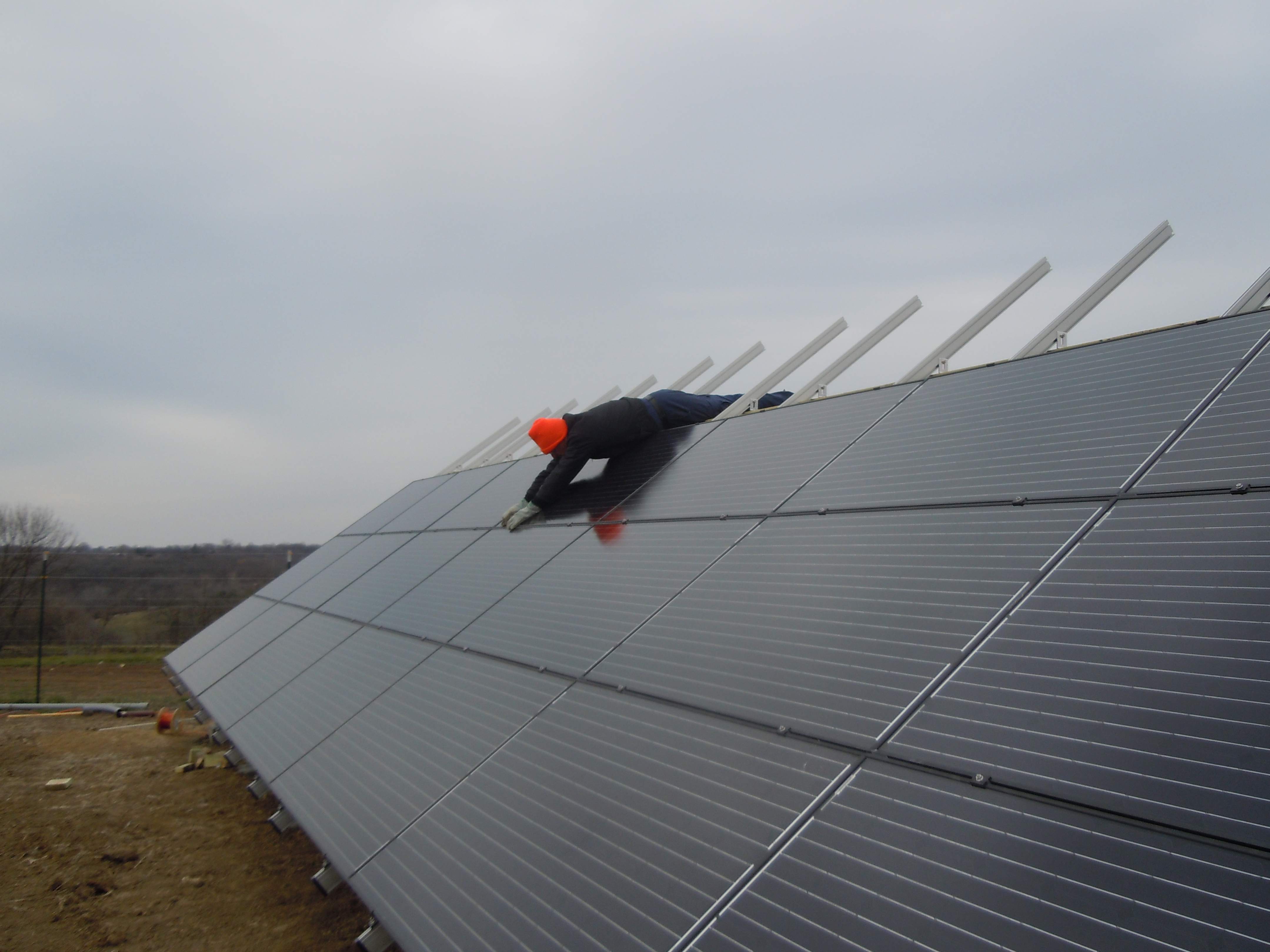

Attaching "solar rails" to the supporting structure.
Tightening clamps.

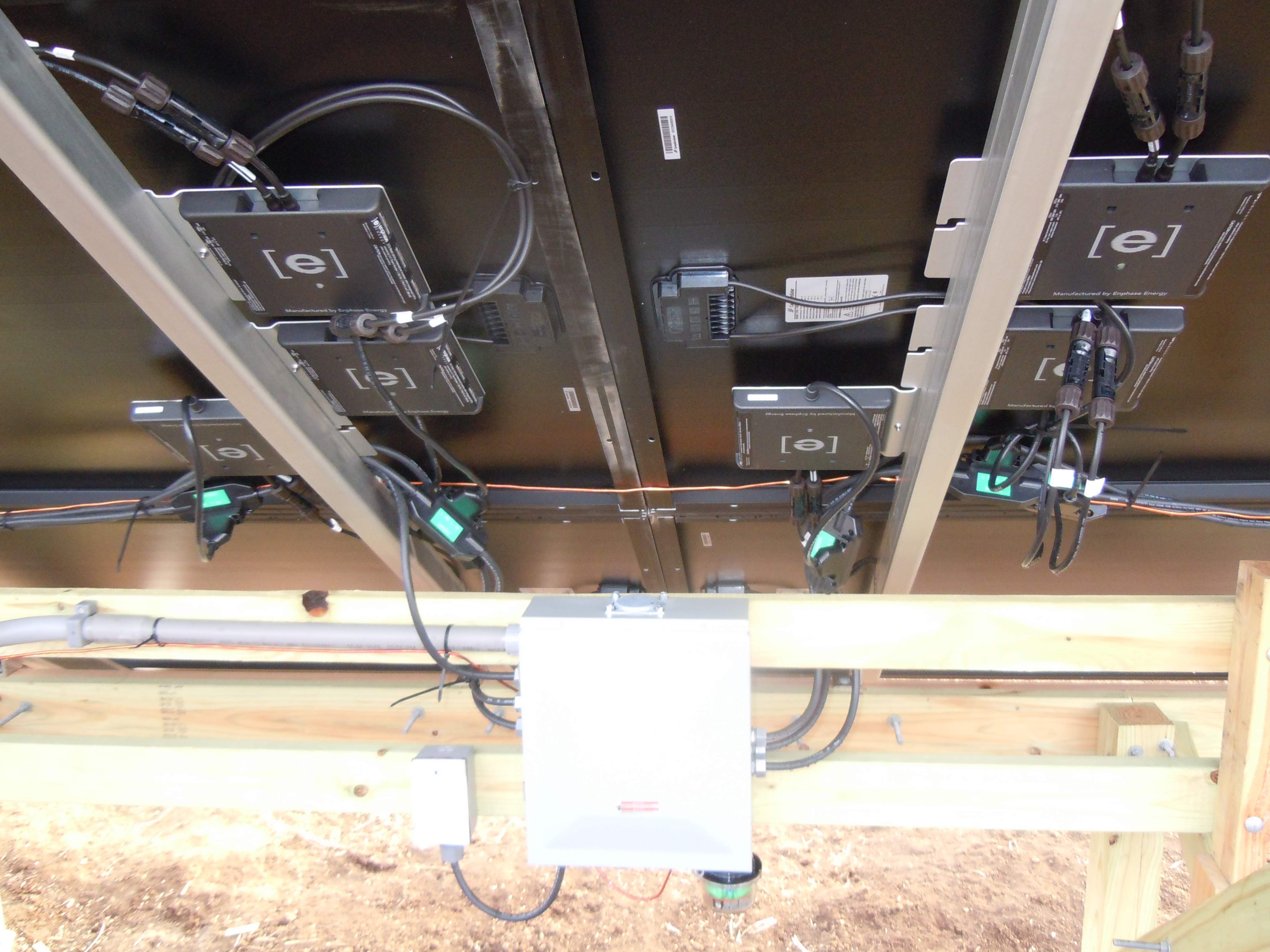

Inverters and cabling.

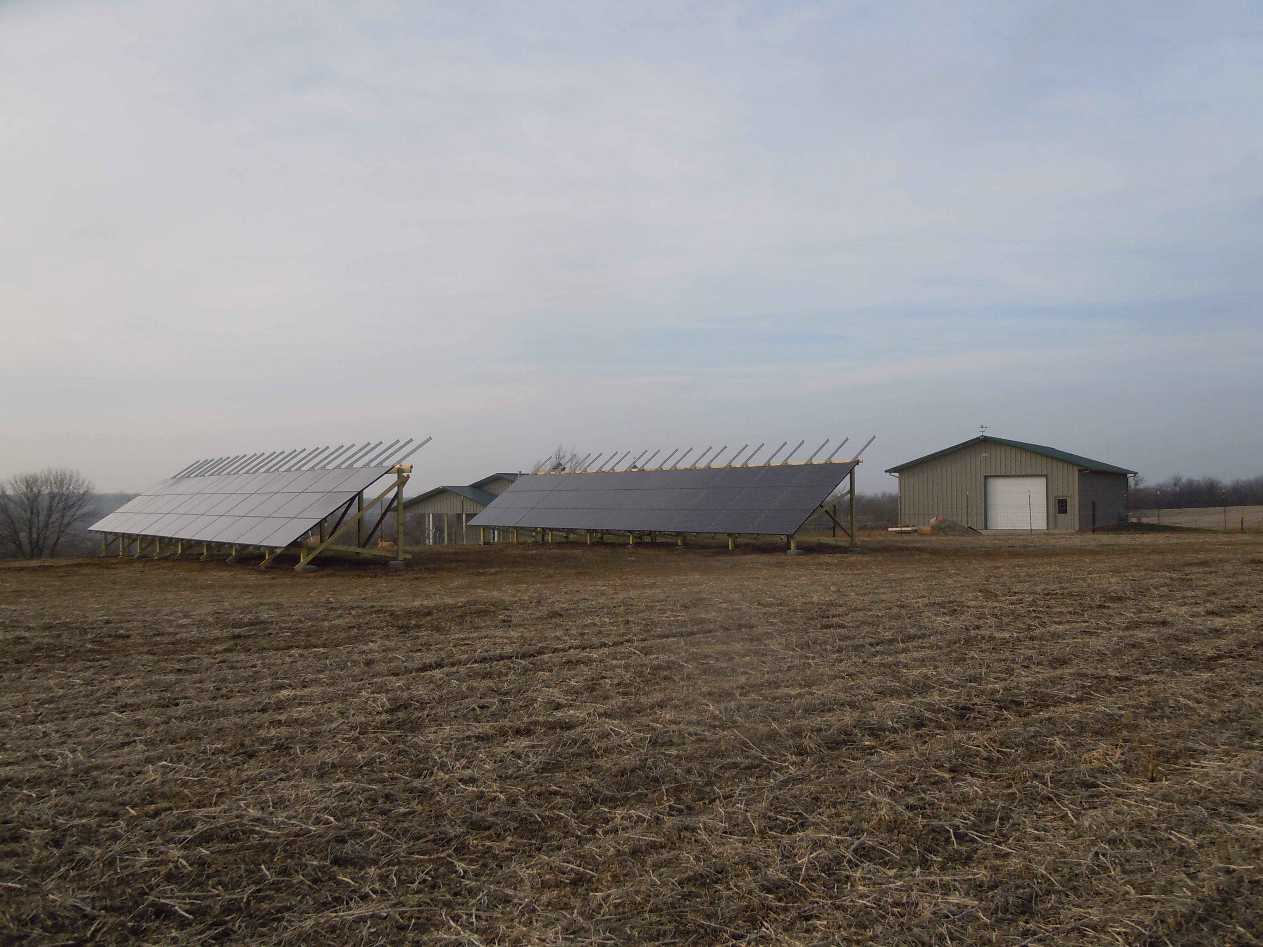

Two arrays completed. The rails have room for one more row I might add later on. At this point there will be three arrays with three rows only. I will wait and see how it will hold up after some strong winds and snow load before I add fourth row.
