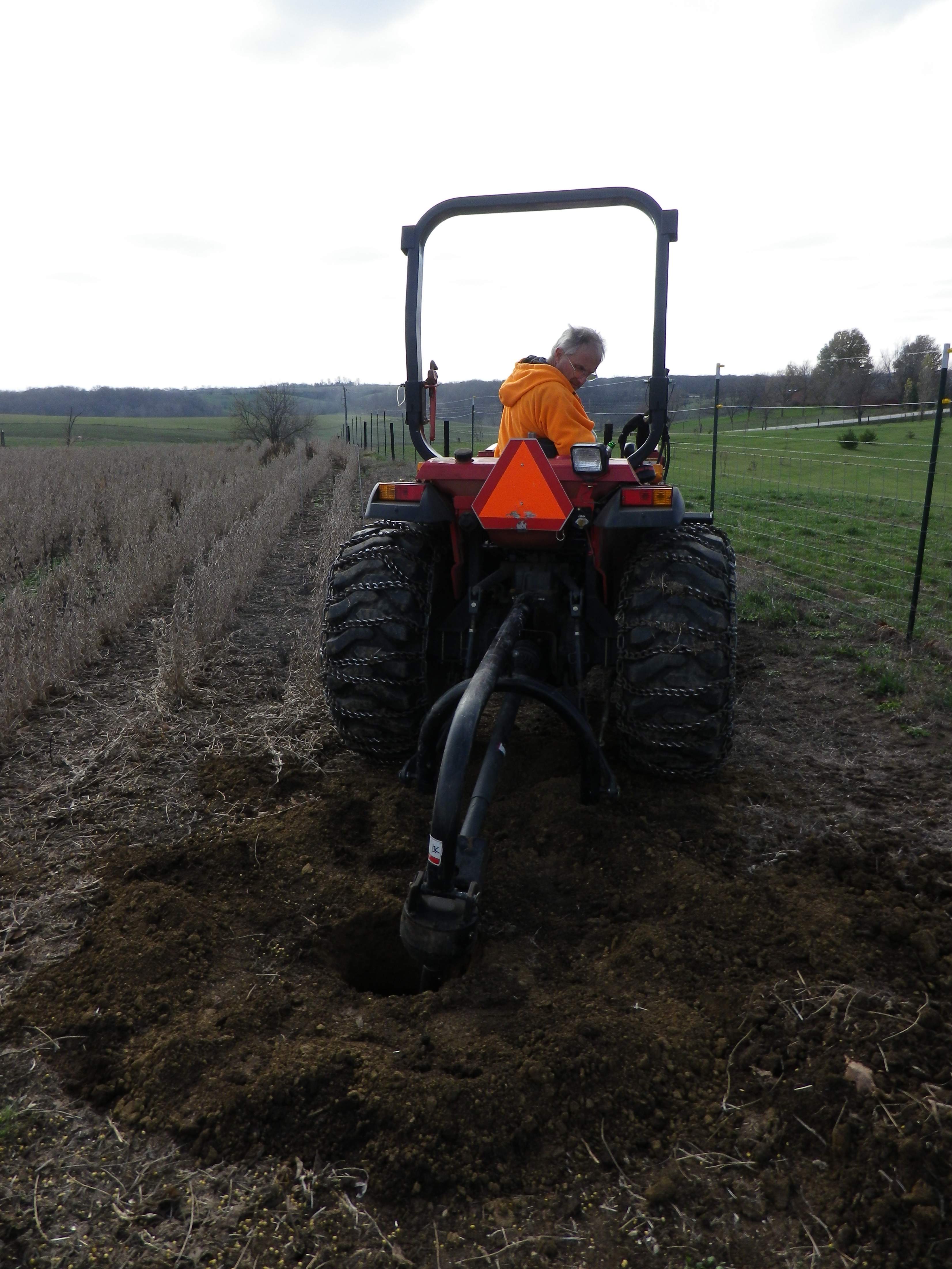

Drilling holes for concrete footing. Week one.

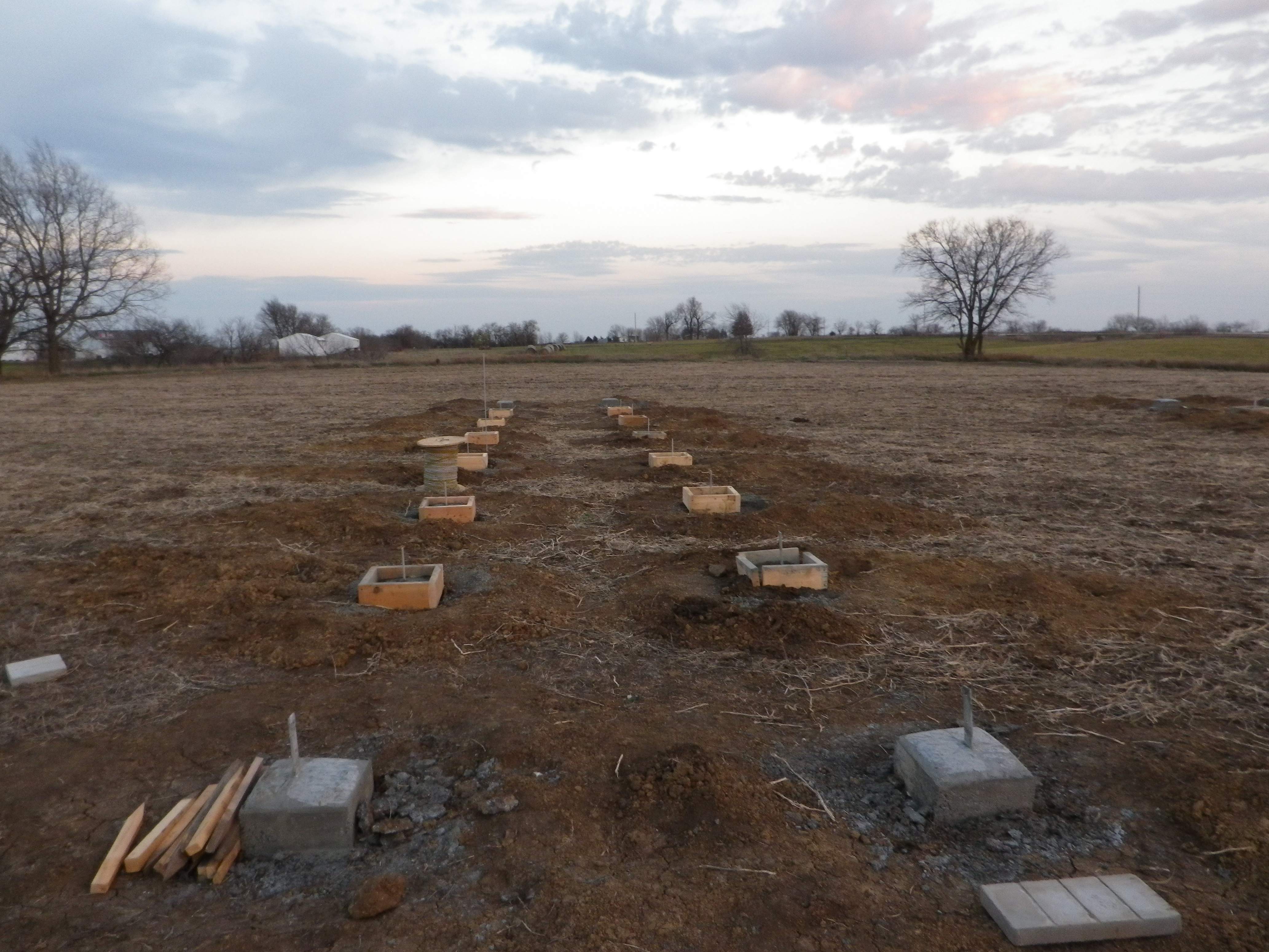

Making footings. Week one and two.
Footings for one array. End of week two

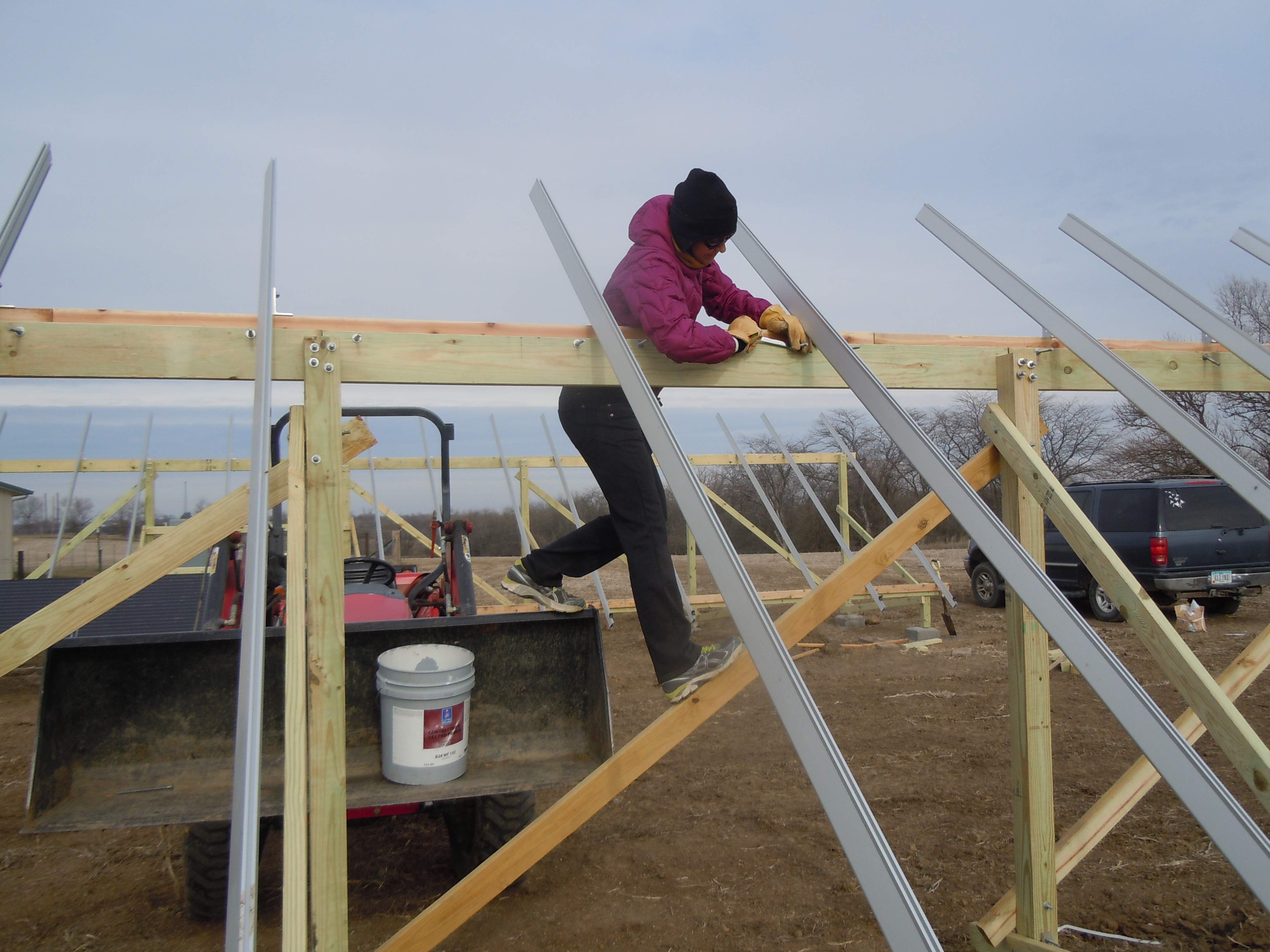

Building first array. Week three.

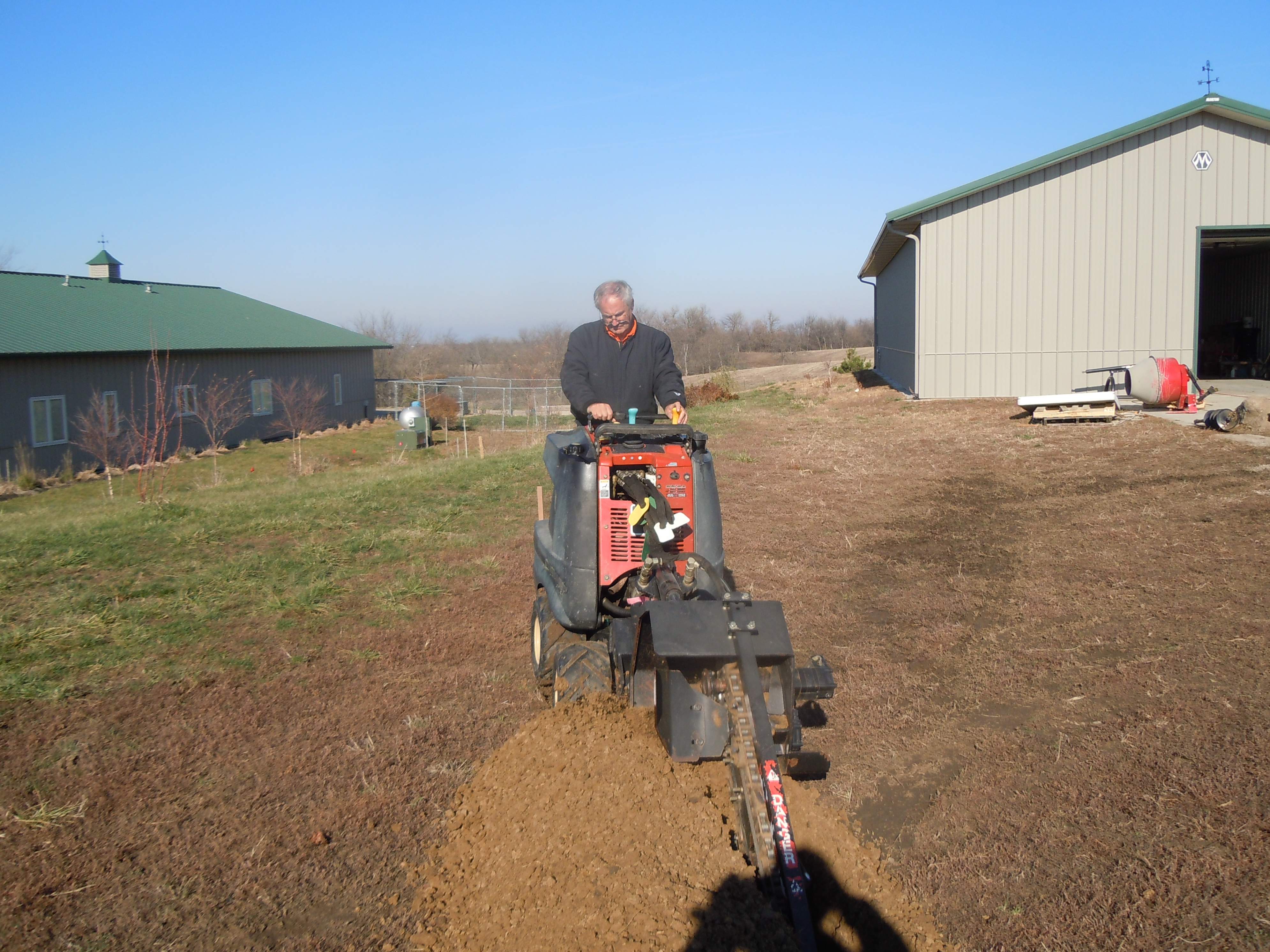

Ditching for the main cable. Week three.

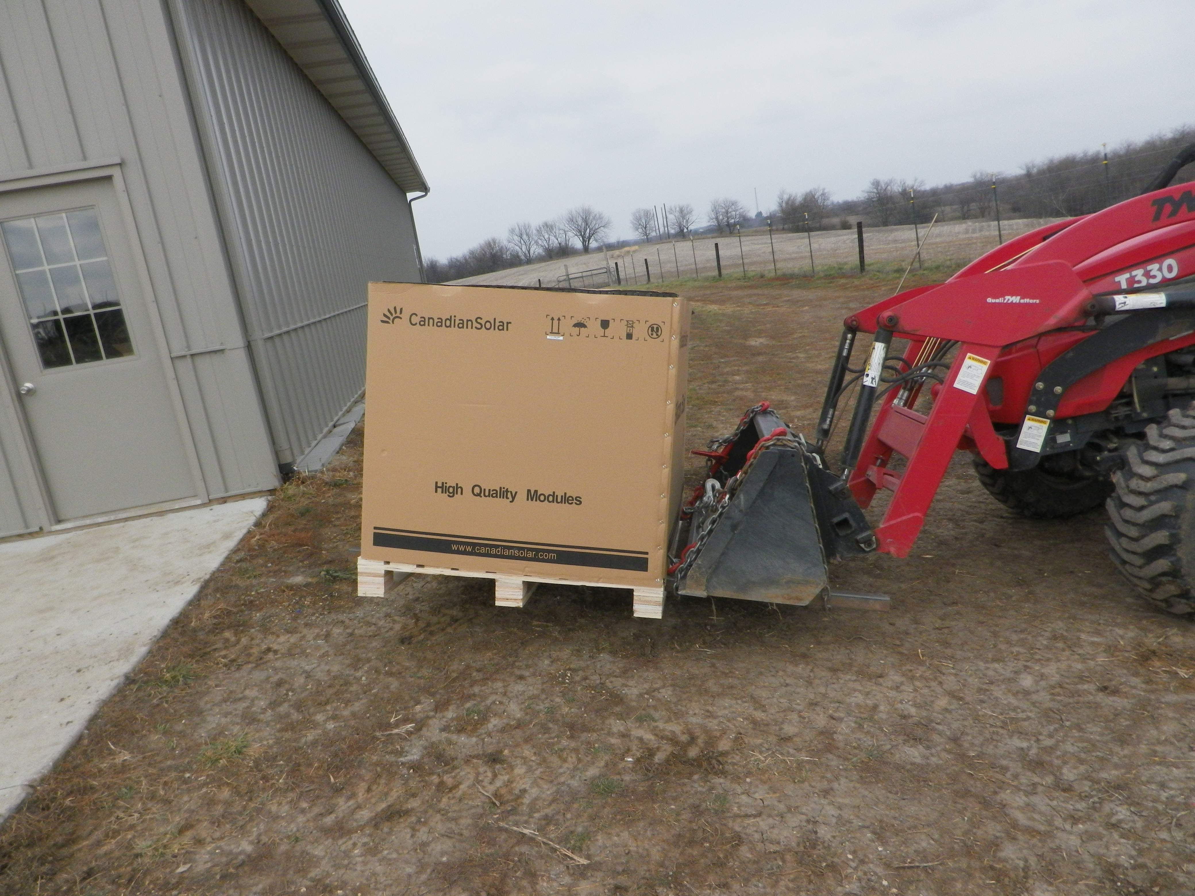

Last batch of panels on improvised forklift.

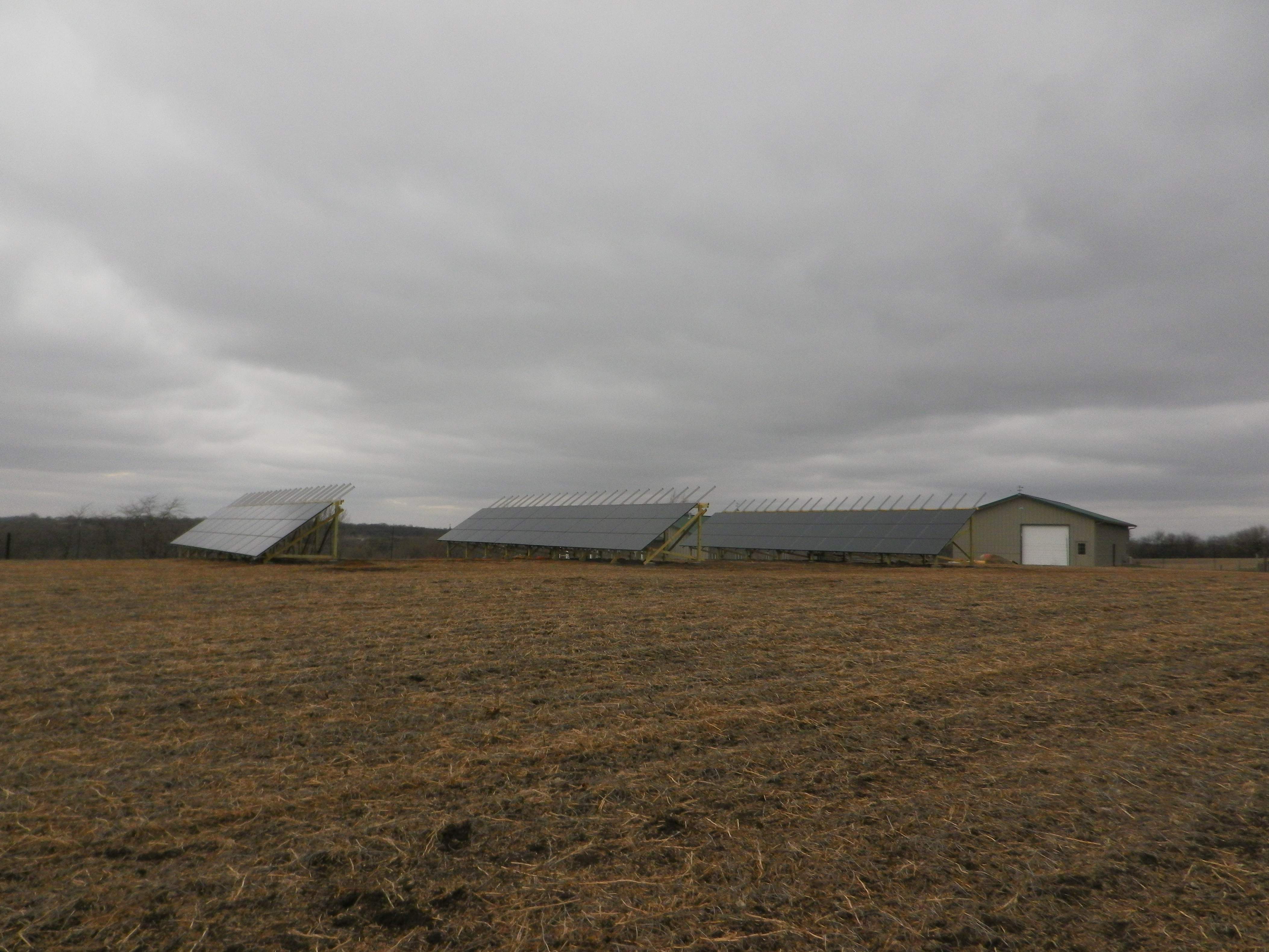

All done. Week four.
