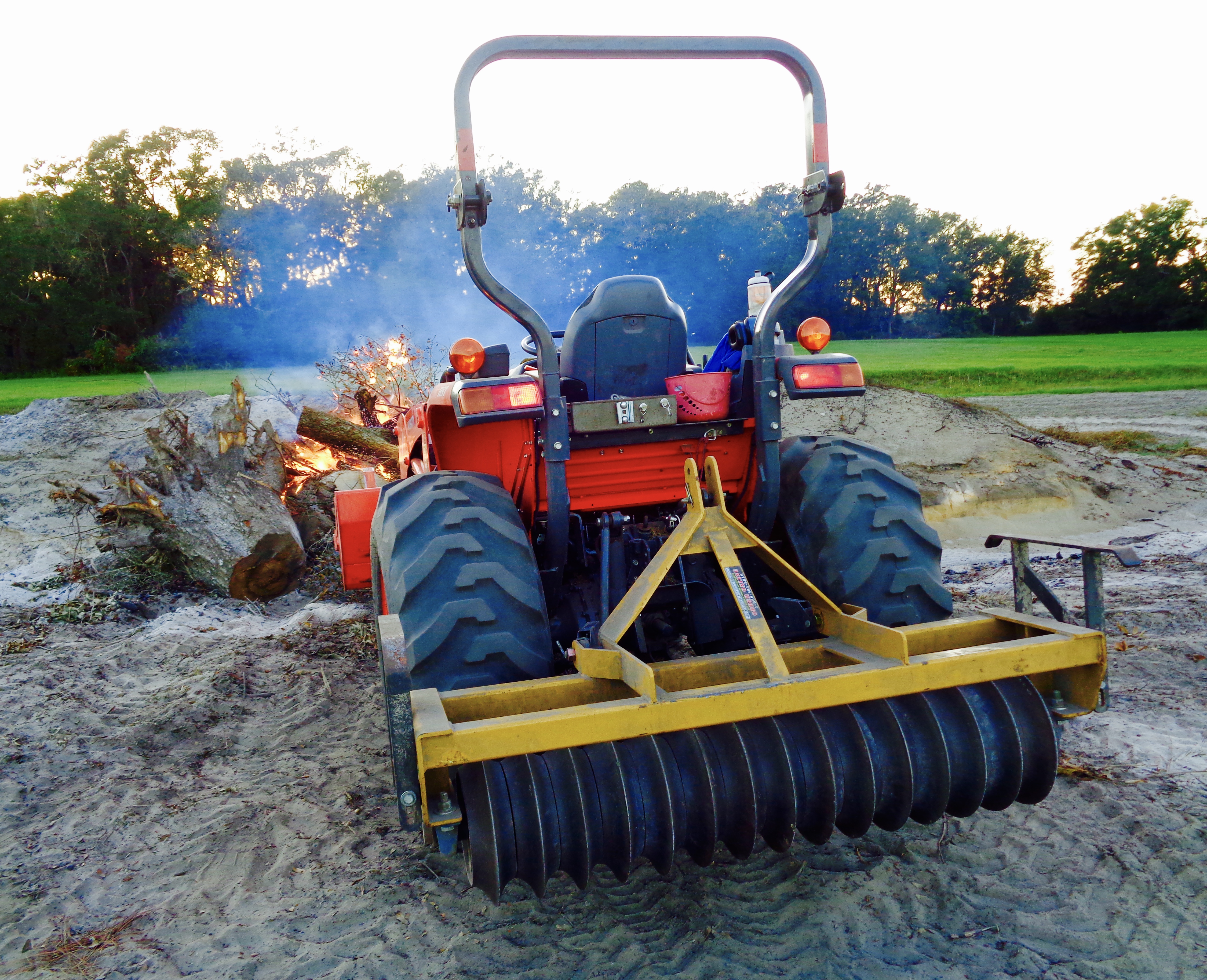

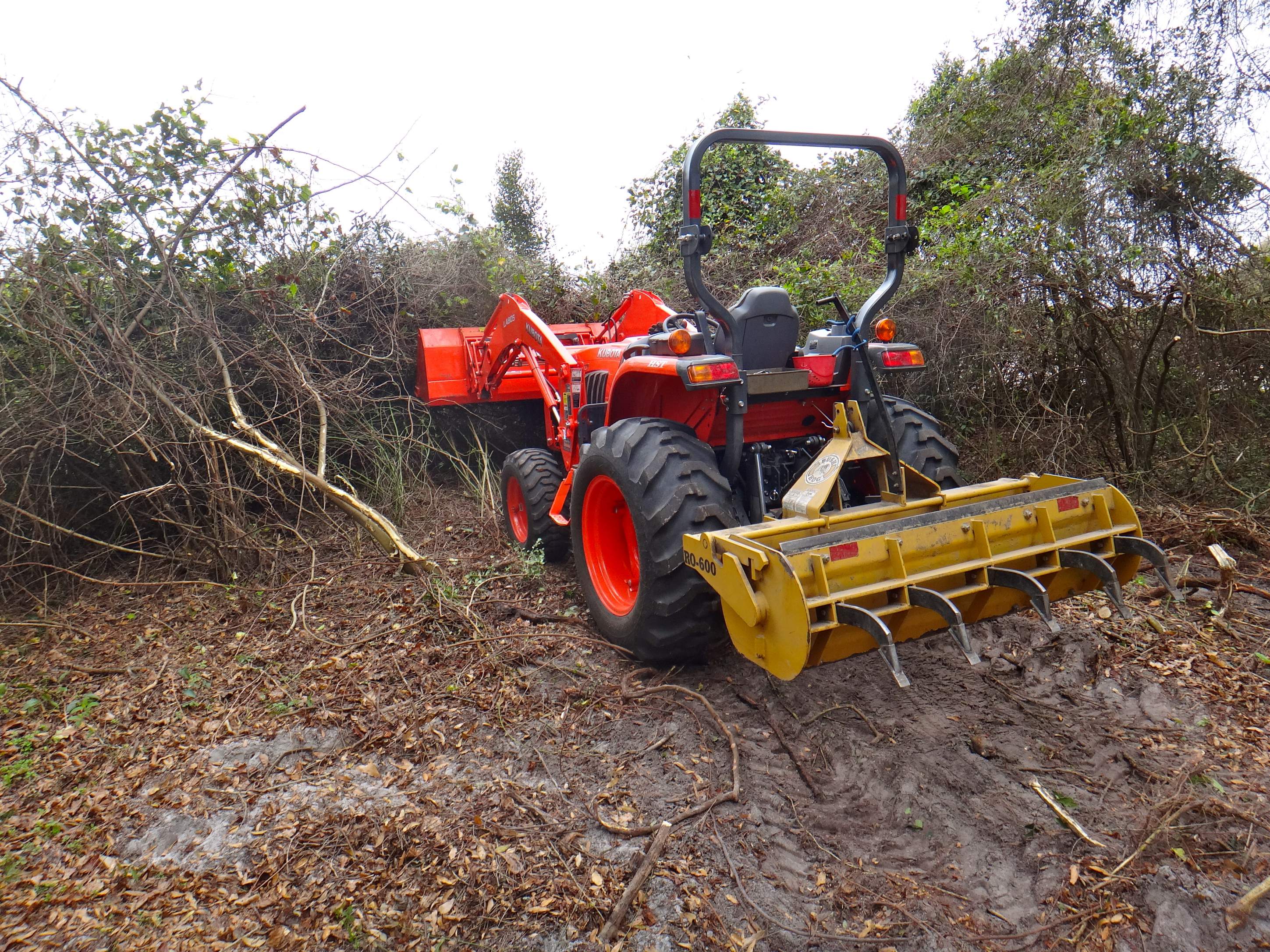

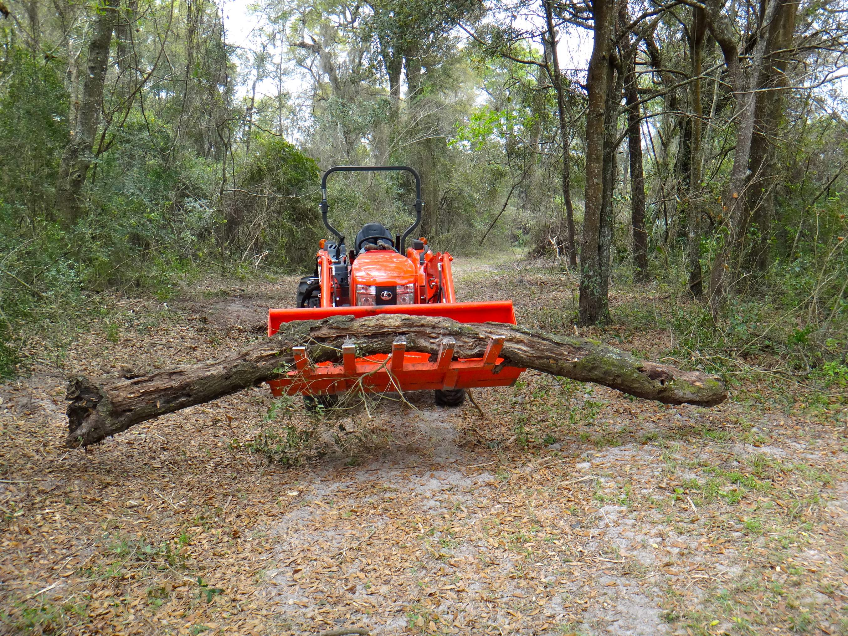

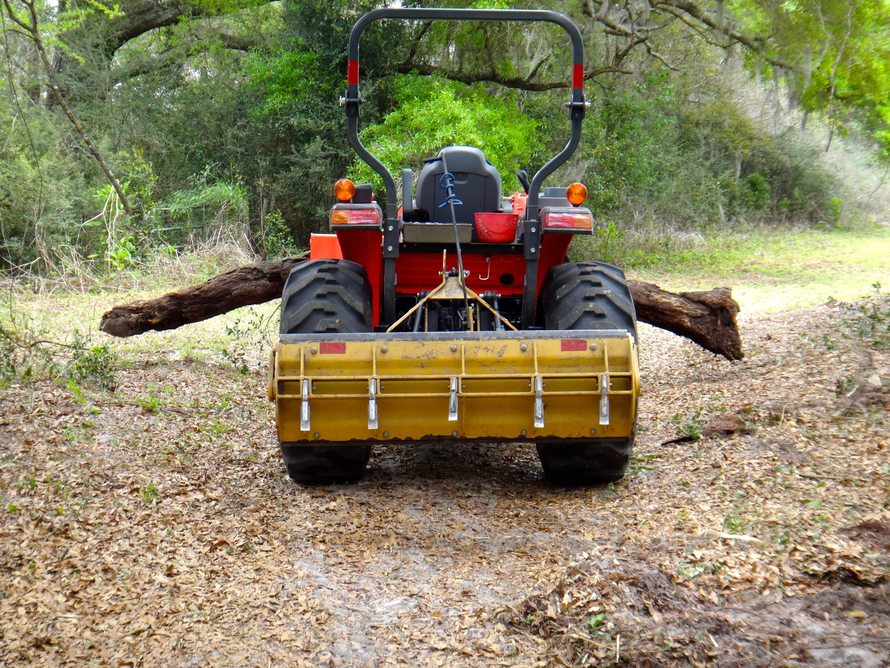

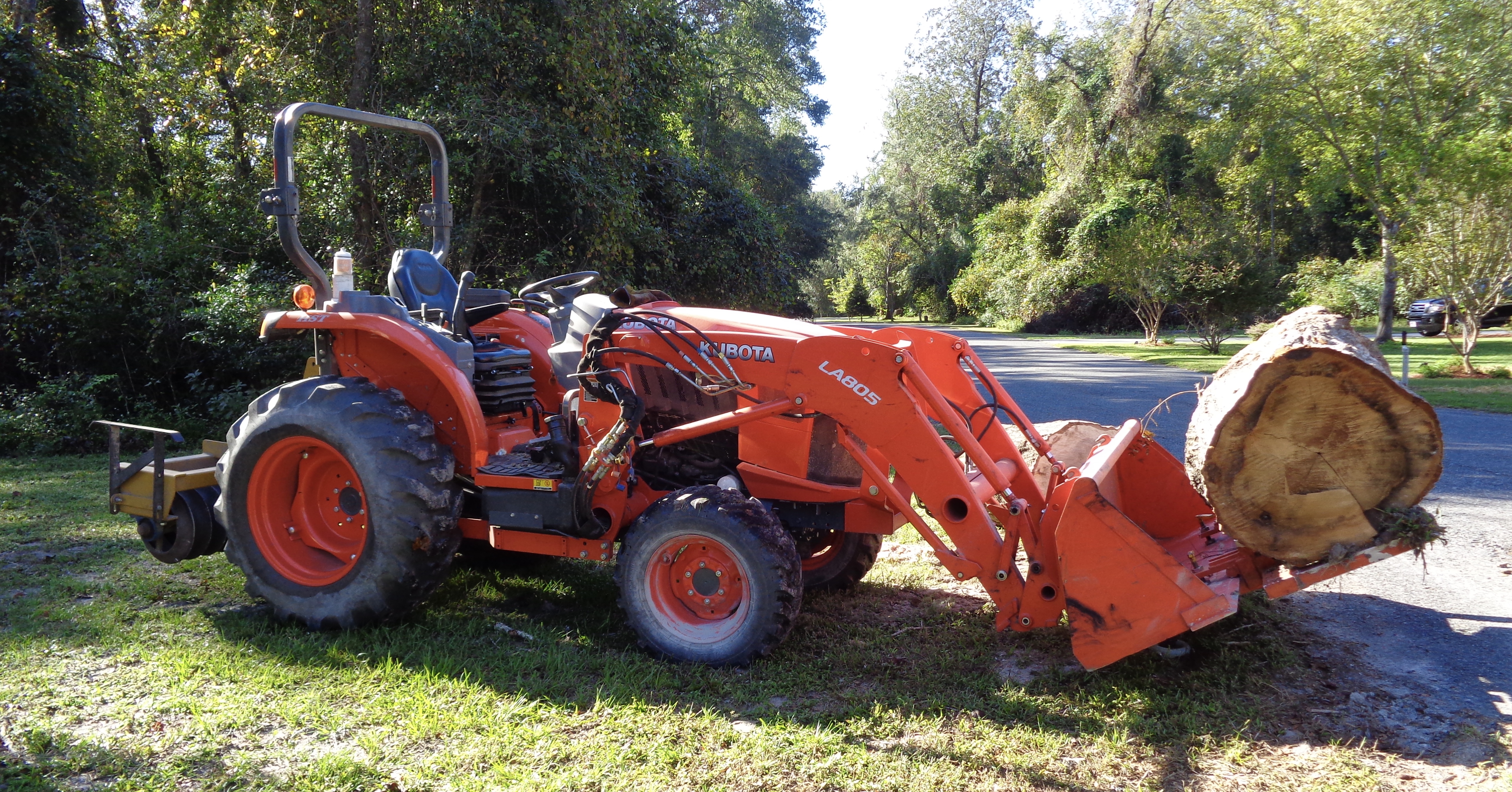

People often buy SUBCOMPACT tractors, like Kubota BX, primarily for lawn mowing, plus a little landscaping work with the FEL in the suburbs. Garage space is often tight. In this scenario where no additional Three Point Hitch implements are likely a ultra compact ballast box, slotted for garden tools, makes sense.
For an L2501/3301 or L3560 order an implement for Three Point Hitch counterbalance. Box Blade is most frequent choice. I often moont a Cultipacker, which is very compact in size, yet heavy.
LEVERAGE makes a 600 pound counterbalance implement protruding 48" to the rear of tractor more effective counterbalance than 600 pound implement protruding 30".
