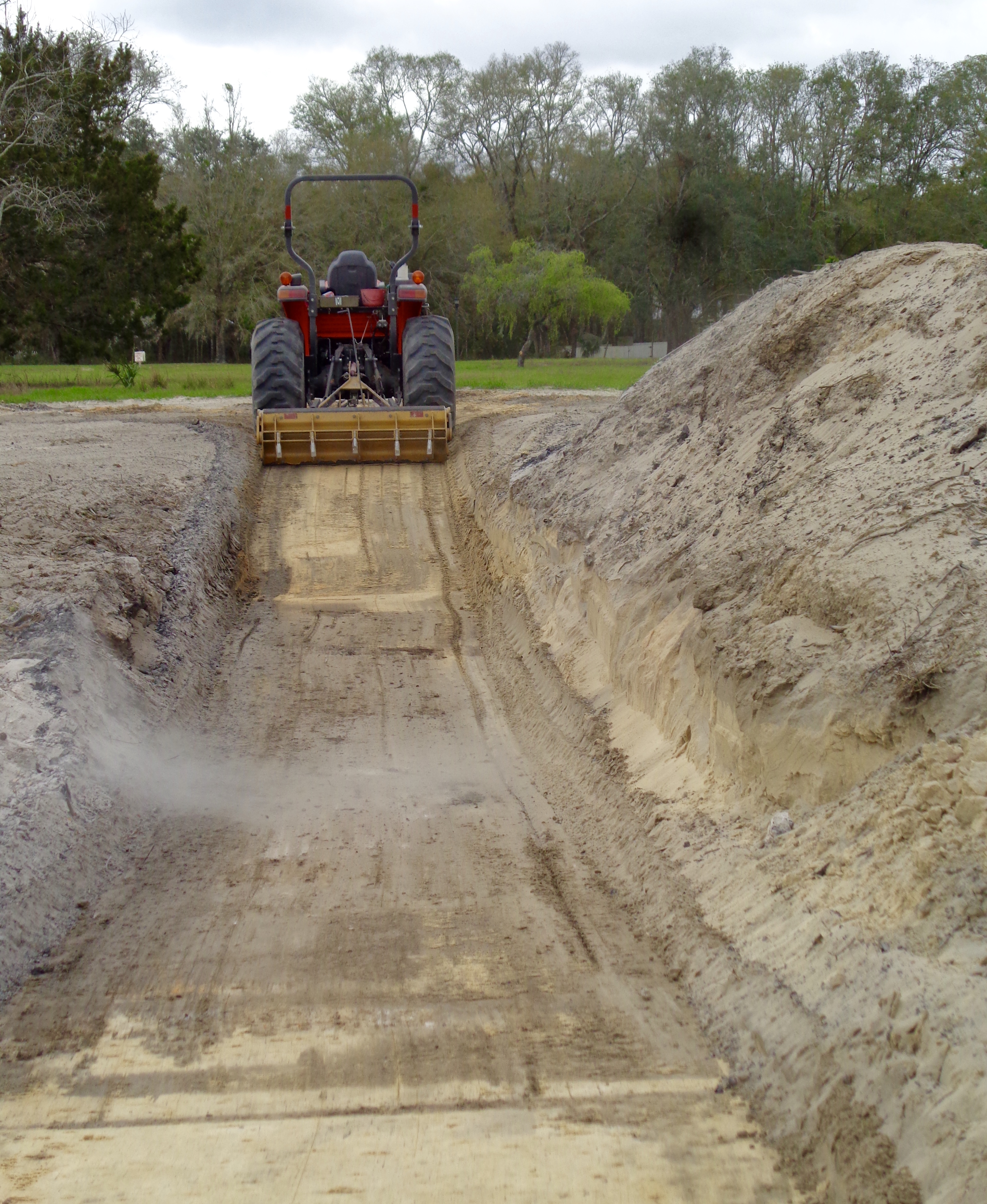

I buy heavy implements. My last two Kubotas have been kitted with air filled R4/industrial tires. I seldom want for traction.Today I was using my 60"/630 pound Rollover Box Blade to clear ashes and dirt from our community burn pit. Full Box Blade draws of wet sand were up a 25' long, steep pit exit. I was in HST/PLUS, LOW/LOW with differential locked, yielding continuous traction with some tire slip.
Tractor "packages" are notorious for being composed of light, marginally effective, ground contact implements.
Photo is not from today. My new Catahoola puppy chewed up my digital camera last week. It is the same burn pit, tractor and Rollover Box Blade during a prior clean out.
