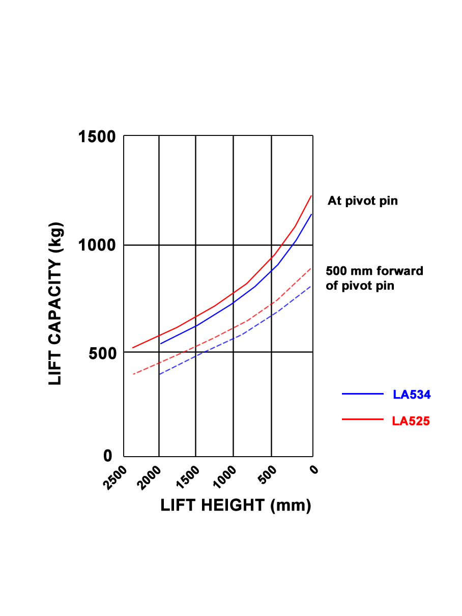

I might be misreading tractordata info but it looks like my B2650 should lift slightly more than the 2501/3301--can that be right?
Difficult for me to find direct weight numbers but maybe I'm not looking in the right place.
Need to factor in lift height -- the L lifts 8-10" higher than the B and ratings are given at each loader's max height. At 8-10" lower, the L will have more capacity than the B. You need to study the lift curves to make a fair comparison. Here's a comparison of the two loaders based on the curves in the owner's manual. The L lifts marginally more throughout the range, but only about 90kg more (200 lb).
