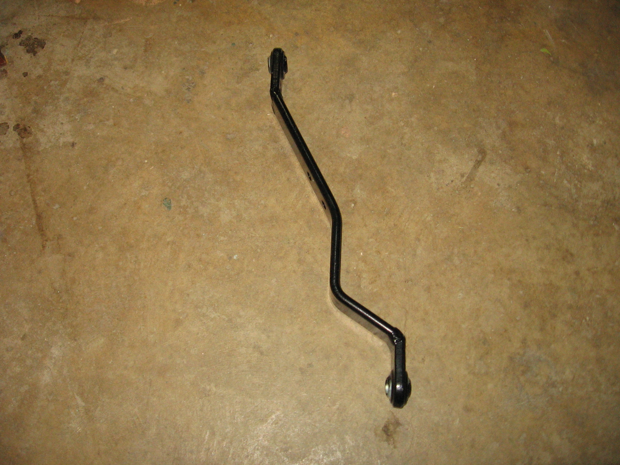

I have the same problem when I have my snow blower attached. It is a generic blower and I ended up putting 5 or 6 flat washers on the pins that attach to the draft arms. This keeps the arms from hitting the tires when I back up. It isn't perfect as they still rub at times but not as bad without the washers. I thought I read somewhere that JD had a new design for the draft arms for the 2520 that was available, is this true. I don't know who is worse my dealer who knows nothing or JD customer service who gives you the run around and just tells you to contact the dealer as they have " technical knowledge " to help you....You pay a big buck for a tractor and you expect it to operate properly without having to do this or that to remedy an obvious design fault. If someone knows if there are new arms available I would be interested in knowing.

Hi lowechj and welcome to TBN:)
This is the new style arm. I just picked them up today:)
Is your machine still under warranty?
That is the only way you can get them without any cost to you,at least that is what most owners have been told:(
Greg
