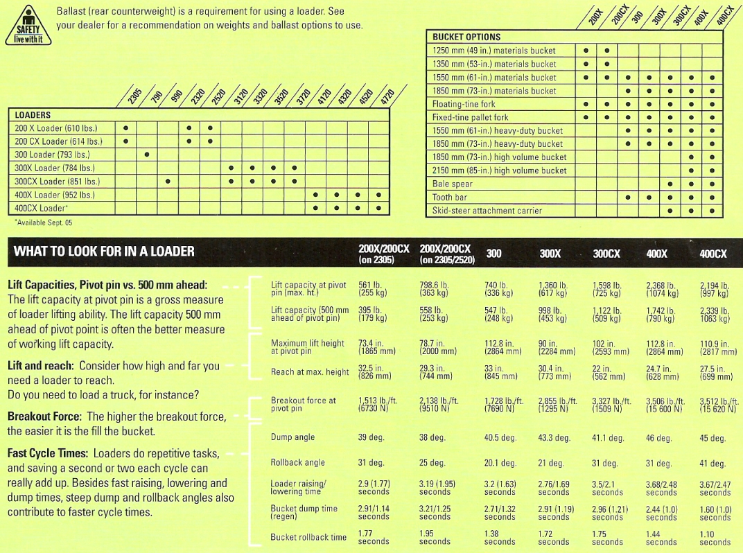

Lifting capacity chart.

According to that chart, the lift capacity for the 400CX is higher 500mm ahead of the pivot pin than at the pivot pin. That can't be right...
   / 2520 liftiting capacity #13
Ya, I think they crossed those numbers up, it came from a pamphlet I picked up at the dealer.
I've noticed that also.. All of Deere's documentation on the 400 cx has been like that since the beginning. I think the 500mm one is right, and it should be higher at the pivot.... Or maybe that's wishful thinking:laughing:
It would make sense, since the 400cx is supposed to have 20 or 25% more lift than the 400x

Interesting information Artillian. Thanks. According to that utility, when you have a loader installed you are to refer to the loader manual for proper ballast. Interestingly, the manual says that if you're operating a loader you should have ALL of the following:
1600 mm (63 in.) or greater rear tread setting.
Rear tires filled with liquid ballast.
Four rear wheel weights. (400X)
Six rear wheel weights. (400CX)
500 kg (1102 lb) minimum 3-point hitch ballast.
My backhoe, weighing in at about 1425 lbs., meets the 3-point hitch ballast requirement, but without the ballast in the tires and on the wheels, I'm going to have problems.
