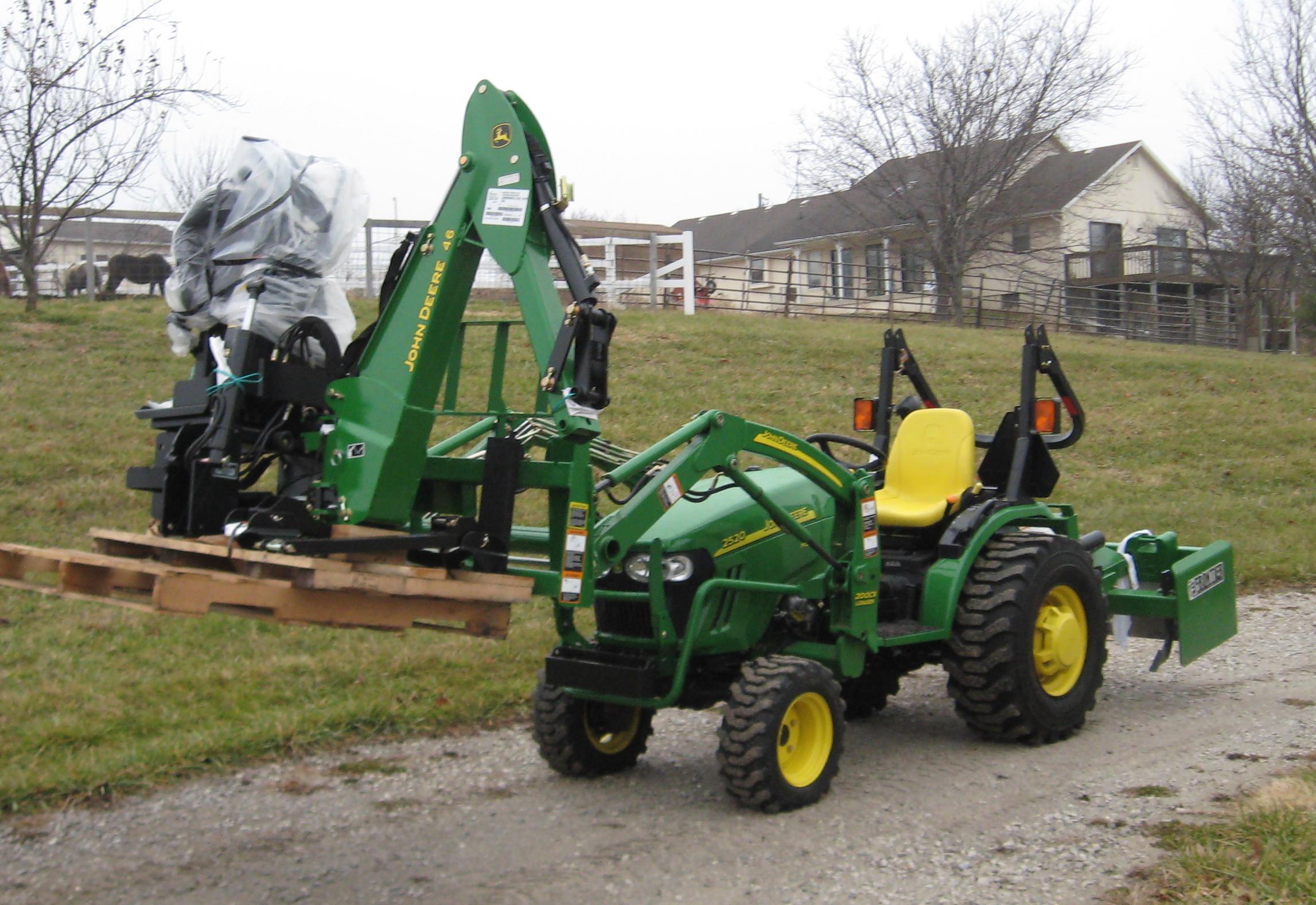

I have the Frontier 42 inch forks which weigh something like 385 lbs (on the heavy side for this tractor, but whatever) and I have lifted my 46 backhoe (minus the subframe and bucket) out of the back of my truck with it. I think the backhoe without the subframe or bucket is probably around 800 lbs. I have also lifted the entire backhoe, including the subframe, but just barely enough to move it, maybe a foot off the ground.
So, based on my experience, I would say around 800 lbs on a pallet would be pretty close to the limit. The "book" says 1027 lbs "at the pivot point". 46 Backhoe 005 B.JPG

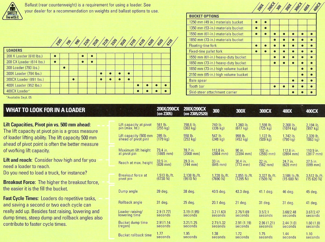

Lifting capacity chart.

According to that chart, the lift capacity for the 400CX is higher 500mm ahead of the pivot pin than at the pivot pin. That can't be right...
/ 2520 liftiting capacity #13
Ya, I think they crossed those numbers up, it came from a pamphlet I picked up at the dealer.

I've noticed that also.. All of Deere's documentation on the 400 cx has been like that since the beginning. I think the 500mm one is right, and it should be higher at the pivot.... Or maybe that's wishful thinking:laughing:
It would make sense, since the 400cx is supposed to have 20 or 25% more lift than the 400x
