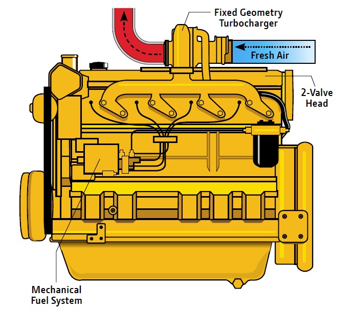

I agree with the others stating that you should go with the 3520 Cab; that is your best bet. Also, with the additional weight of the Cab on the tractor, the tractor will perform better with a turbo charger. In case you have any hesitation about having a turbo charger on the tractor's engine, below is what JD states about turbo chargers:
Fixed geometry turbocharger
Fixed geometry turbochargers are sized for a specific power range and optimized to provide excellent performance across the entire torque curve. They are also designed to maximize fuel economy between the engine's rated speed and peak torque.
Turbocharged
In turbocharged engines, the air is precompressed. Due to the higher pressure, more air is supplied into the combustion chamber allowing a corresponding increase in fuel injection, which results in greater engine output.

There's been a lot of talk on TBN about this subject. A turbo will give you more HP BUT you will also use more fuel. If you look at the specs for the turbo and normally aspired engines the turbo shows higher fuel consumption. Probably not much but you don't gain efficiency with a turbo and efficiency is the fuel usage determining factor.
Also,while the Deere turbos seem to be bullet proof they still have more parts and the more parts the bigger chance for parts break down. A turbo spins a fan from the exhaust very fast and with more HP in a smaller block you get more heat too.

Don't worry about this talk about the turbo on the engine. The turbos have been on this model tractor from the start and they work well. JD wouldn't have put them on if they did not work and wouldn't have kept them on the Yanmar engines if they had a lot of problems. If you do have any concern whatsoever about the model tractor, I always find it best to go into the shop and speak to the mechanics; they can tell you what problems they have seen, if there is any thing major, how hard the problems (if any) are to fix and if the problems have or have not been fixed on model tractor you are looking to buy.

Agreed. As long as you let a turbo warm up and cool down a little longer than a regular diesel, you should be doing good.
