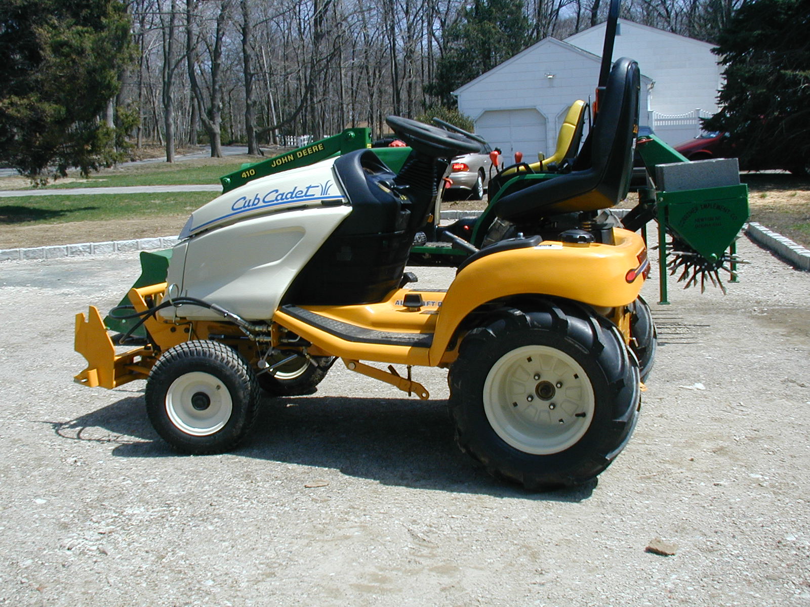

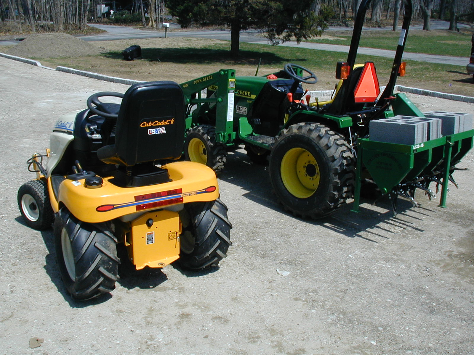

Guys, those of you who have lug tires for your 2500 series help me out. I cannot find on the Carlisle website where there are any 23x9.5x12 lug tires. Everything I see is 23x10.5x12. Would those fit?
Where did you get yours? I have checked Northern Tool, TSC, and ASC. No dice...:(
We have the same rear rim 7.5" wide, and the 23 x 10 - 12 asks for a 8.5" wide. But long story short is yes they will fit and operate perfectly fine (see pictures). Never had an issue with the turf being ruined either, of course I dont go on the grass when it is really wet, and im towing something. Go with at least a 4ply tire, you might be able to find a 6 ply as well. helps with weight load and reduces flats the more plys you have.
www.carlisletire.com
www.tiresunlimited.com
CR Tire - ATV tires Lawn tires Trailer tires
