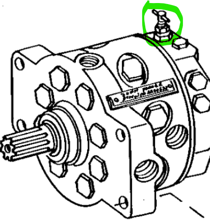

With engine operating at idle speed in order to de-stroke pump turn DS screw clockwise until it stops then turn DS counter-clockwise until it stops turning. Be sure to check pump shaft to be sure it rotates when engine crankshaft rotates. De-stroking screw is encircled in green. HTH's, Jim

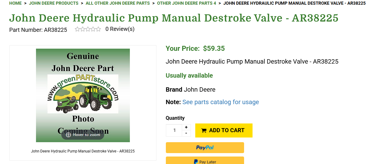

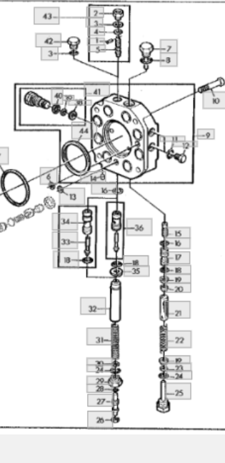

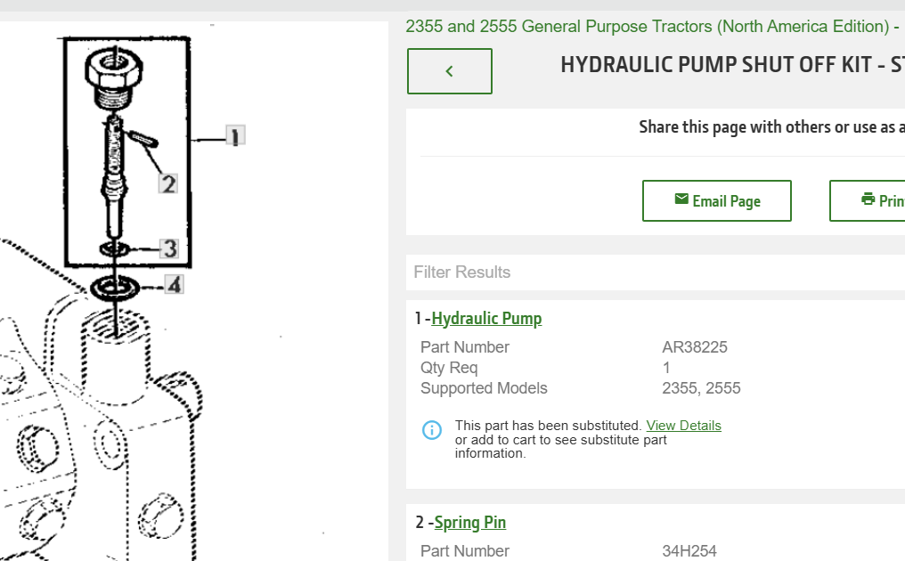

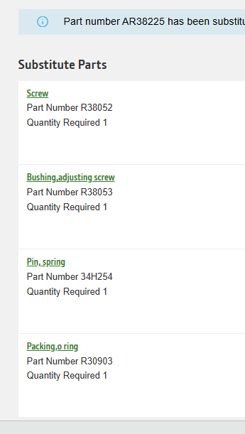

Does anyone here know where I can get the De-stroking screw/kit mentioned above? I called the dealer who put me through to service, and the technician hadn't heard of one. He did get back to me with a diagram and some part numbers, but he said the kit was no longer available. I don't see in the parts the number for the hollow nut that reeplaces the cap nut at top, which is internally threaded to recieve the actual DS screw. If I knew the dimensions and length of the parts I could just acquire the parts individually. Though that would be a real pain.
/ 2550 hydraulic problem #30
If JD dealer parts personal that can't locate info on 2355 hyd pump destroking screw & parts on that part # he needs to get a different profession/job. Last photo lists the part #s that AR38225 could sub to. John Deere AR38225 Kit | eBay
To his credit, he did later explain the kit was, or should be, available after market, thus the "A" prefix on the part number. The fact that it seems many earlier models of John Deere actually came with this part installed did cause some confusion on my part. I now realize that this part is not a tool but more of an accessory, that can installed to the pump and left there for future convenience. I see by researching earlier threads that Tx Jim has been helping us folks and recommending this procedure for quite some time. Even the photos I've seen posted look very familiar to mine. I guess you've experienced a bit of deja-vouz from time to time Jim.
from searches for this part number (AR38225) I've seen prices all over the place from $38 to over $120. But half of them report out of stock when proceeding to purchase. The best priced ones also add about 20 bucks for shipping, which is ludicrous considering they could put in an envelope and drop in the mail.
I did stumble upon a good resource it seems. At AVS.parts you can enter the part number you request and they will send it out to bid, so to speak. They will then relay the fulfillment offers to you, so you can pick the deal you want. Within 6 hours I was returned 4 offers, and I am waiting on the shipping details from one before I purchase. Hopefully a helpful resource and not a scam.
