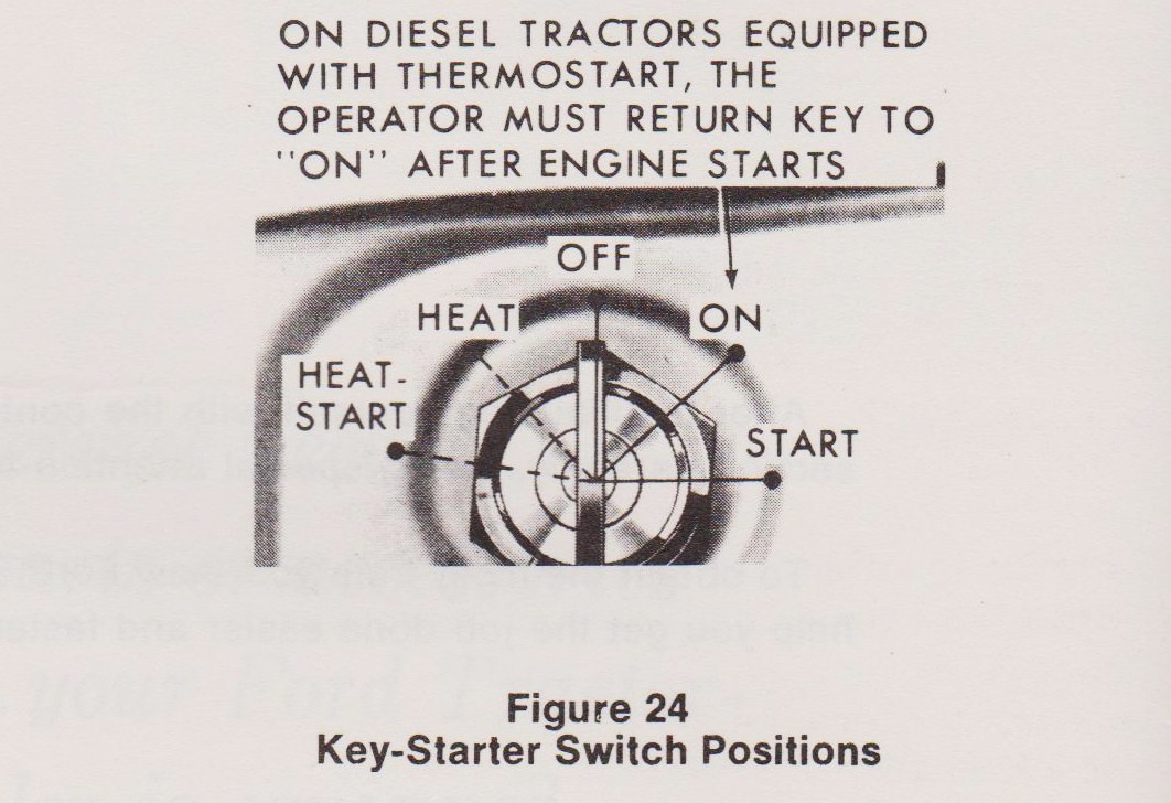

I own and have several Ford diesel tractors and have never seen one that one turns the ign switch to the "left for starting" as you described. On my Fords one needs to turn key clockwise(right) to energize starter I also seriously doubt at -25C that if any water is present in filter will drip out if bleed screw is opened but I could be wrong. Fuel enrichment and Thermo-start that you referred to actually increase compression with the extra fuel added.
It sounds like Ford changed the key switch designs, at some point but all the earlier 2000- 5000 Fords came with this style , Ford 2000-5000 key switch 001.jpg I now am curious as to which style that 545c has ?
As far as draining the water I thought that it would be obvious to use the block heater with the engine covered for a few hours before attempting to drain any water- after a few hours (under a tarp) my 3000's engine block is above room temperature- which I just tested this theory this morning , -it was -4* F here this morning and mine drained fine...
The other thing my manual suggested was using ether -in addition to the block heater for temps to -20 but I don't like to advise anyone to use Ether- although on the on mid to late 60s Ford did offer a factory installed option for the 3 cylinder tractors 2-3000 models.
My factory owners manual Does suggest the block heater , thermostart AND excess fuel button in concert to start the tractor down to -20* .

I guess in my old age my reading comprehension is failing as I see no mention of covering tractor under a tarp with a heater blowing in your post I was referring to. I'll quote you[/quote]4) To check for water - most Fords have drain screws at the bottom of the metal fuel filter housings and IIRC turning them clockwise will drain the water first and once diesel flows clear just tighten back up[/quote] On the subject of the ign switch I'll bet the tractor will start by turning ign switch CW after Thermo-start is activated.

The inline coolant heater is what was referred to -I don't remember anything about a heater blowing on anything other than a hair dryer but I would only do that if it isn't starting with the coolant heater on a covered tractor. Also as far as turning the key right to start if his key switch is like mine turning right- will shut off the thermo-start just when you want the diesel vapor hot
