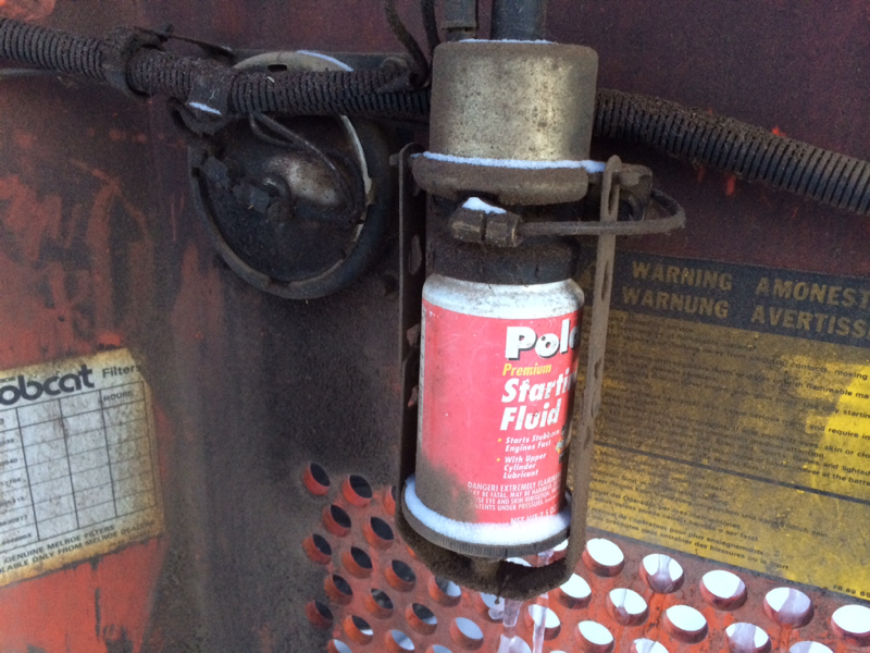

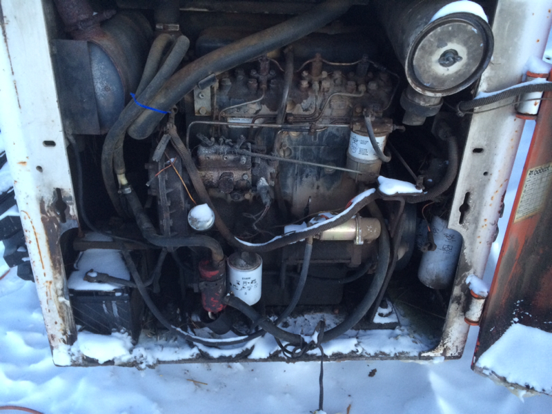

Was at my nephew's dairy farm today. He has this Bobcat with a Perkins 4.236 engine. Instead of the thermostart intake manifold heating system factory starting aid is ether. It has the ether spray can mounted on the door with a tube leading to the intake manifold. I know this thread started with a Ford construction engine but I remember someone said the 3 cylinder was either Zperkins based or Perkins built. This skid steer is now 33 years old, has always been used in Northern MN for feeding livestock so it runs every day during the winter. Many of those days it's fed ether and it's still going strong. In this case there are no glow plugs or intake manifold heater to prematurely ignite the ether. Not that it extends engine life but sometimes you need to do what it takes to keep your operation running.

IMHO the ether starting aid kit such as pictured above are far superior to spraying ether into the air cleaner because the kit has an orifice that limits how much ether enters the engine in a given amount of time
