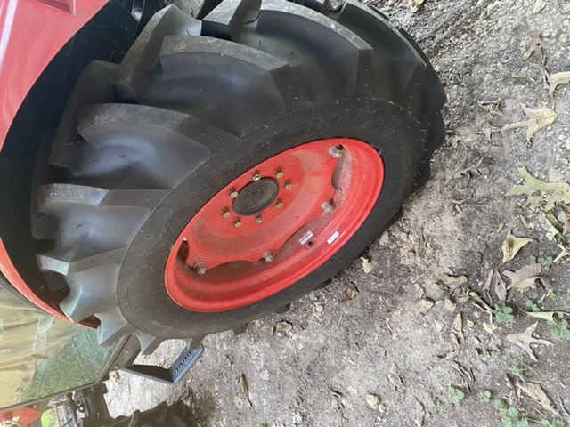

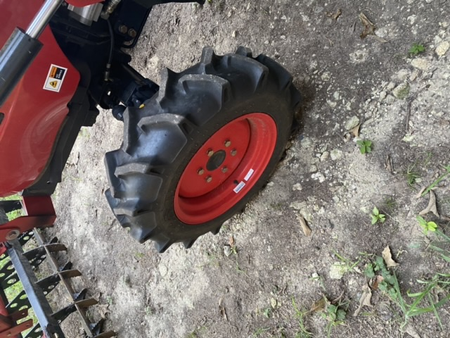

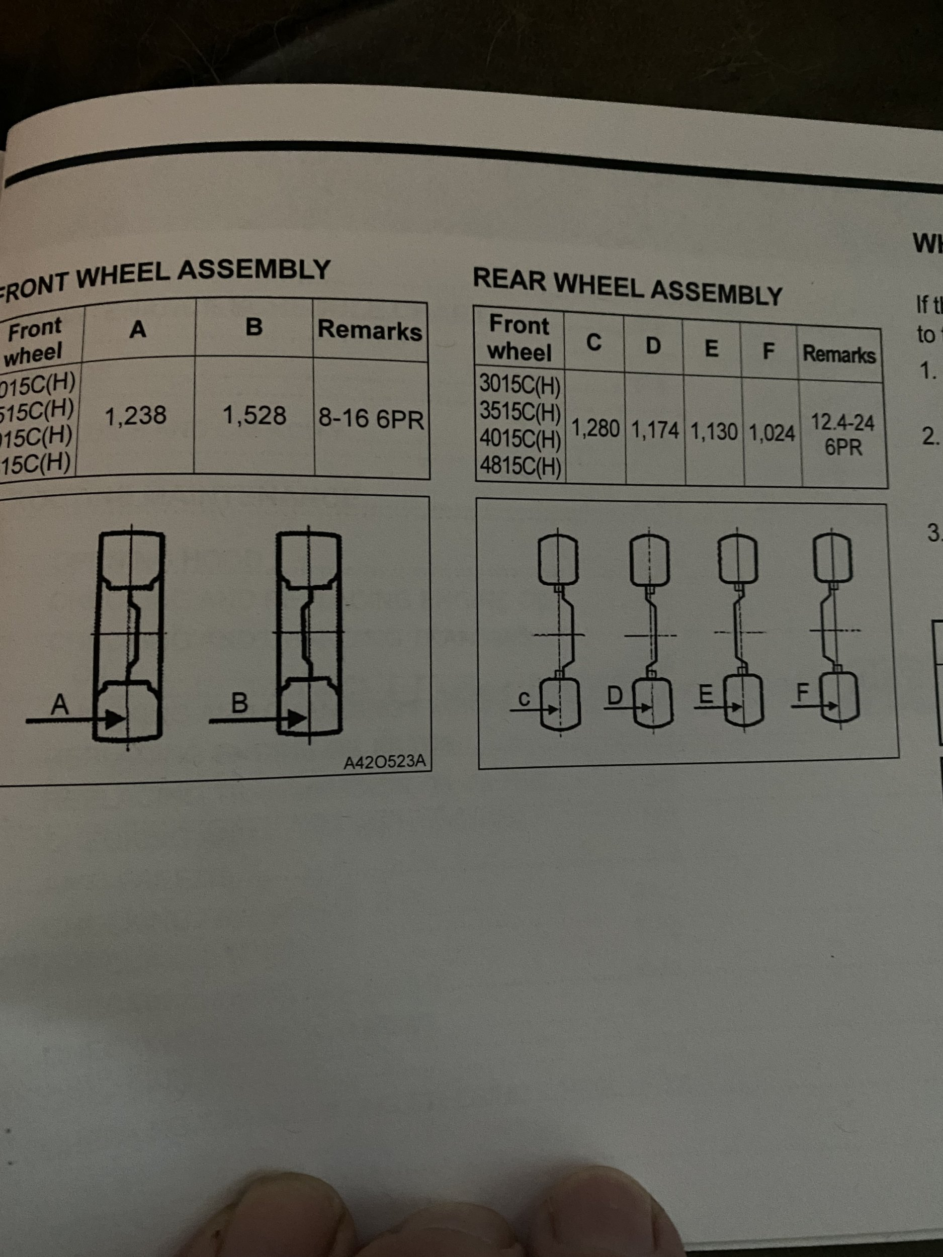

Here is a couple photos of the rims. For the front you just swap sides.
   / 25hp Tractors for Vegetable Farming
#12
Some 2-WD tractors have adjustable wheel widths in front.
I've got a couple of larger tractors that are like that, but my ground is real up and down for the most part. I feel more comfortable with the MFWD for this application for the extra braking traction and stability as much as anything.
