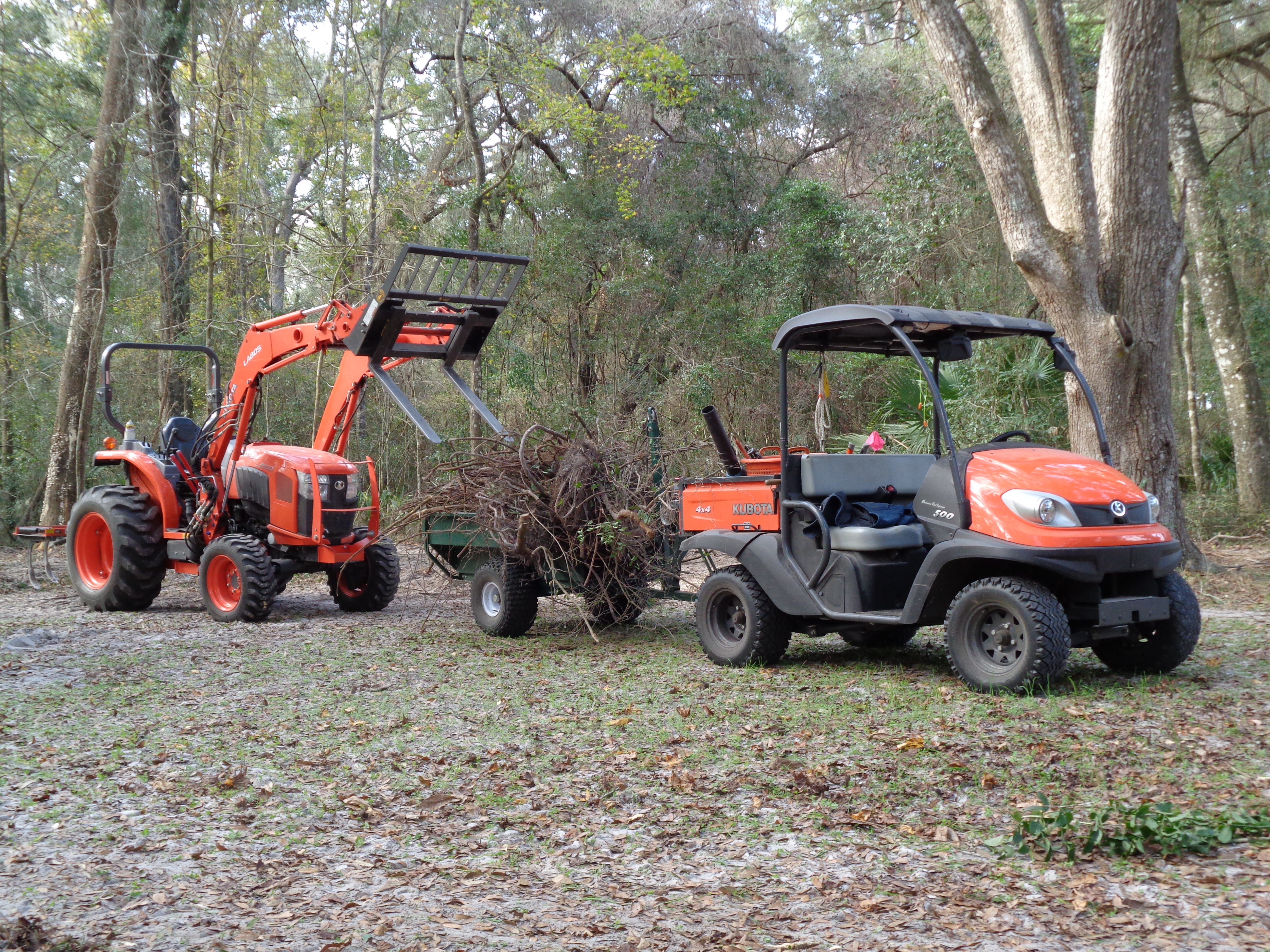

A utility vehicle paired with a dumping trailer may be more efficient and cheaper for these tasks than a second tractor. Kubota utility vehicles have HST transmissions, the same transmissions on Kubota BX tractors, therefore are real work horses. MUTS from Canada is the Gold Standard in dumping compact trailers.
I really like the Kubota UTVs. I'd definitely like to get one, but I don't see it as a tractor replacement. I'm planning on putting 1000-1200 hours a year on the tractors. I don't know how well the independent suspension and smaller engine would handle that. Maybe it would do well, but I'm afraid it would be pretty worn out in 3-4 years. Do you have experience putting a lot of hours on one? I could be underestimating their reliability and longevity.

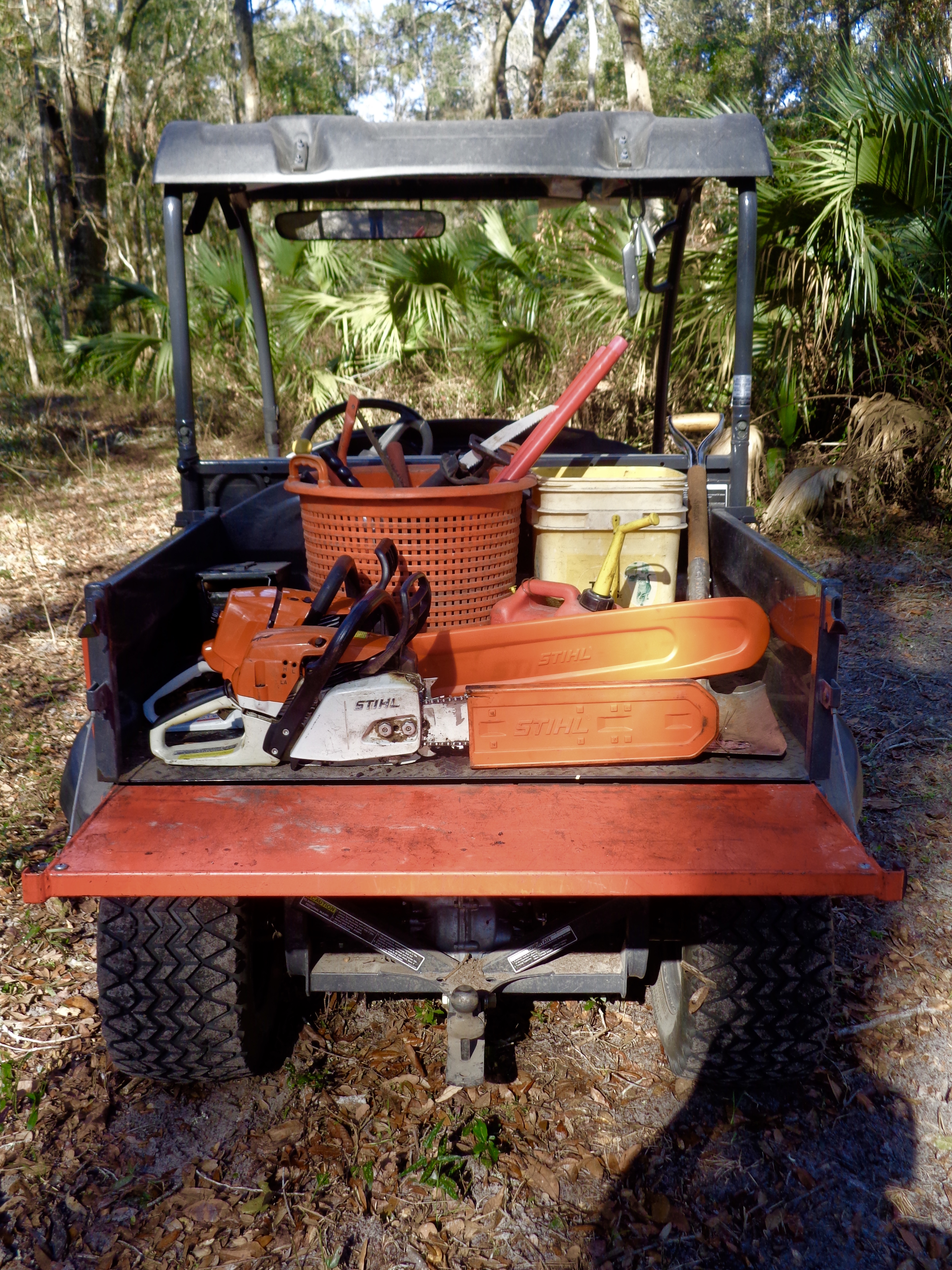

I really like the Kubota UTVs. I'd definitely like to get one, but I don't see it as a tractor replacement. I don't know how well the independent suspension and smaller engine would handle that. Maybe it would do well, but I'm afraid it would be pretty worn out in 3-4 years. Do you have experience putting a lot of hours on one? I could be underestimating their reliability and longevity.
I have 2,000 engine hours on my 2010 Kubota RTV500 gas. ($10,000)
Except for one fuel contamination problem, unrelated to Kubota, faultless.
Pictures indicate my RTV500 gets plenty of use.
