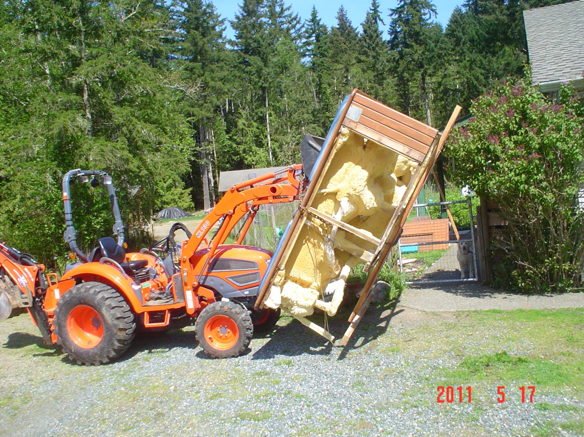

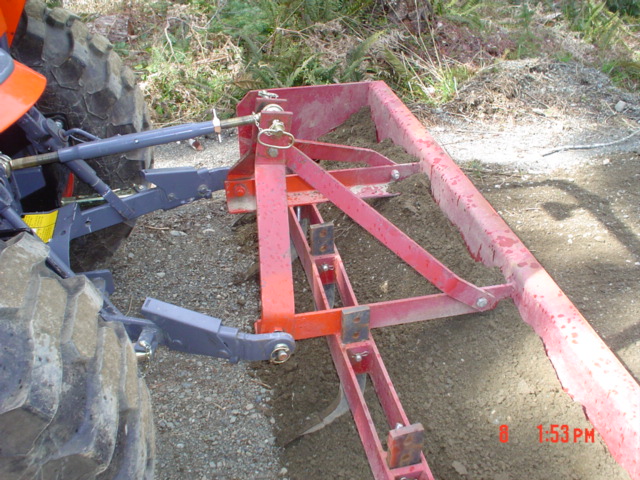

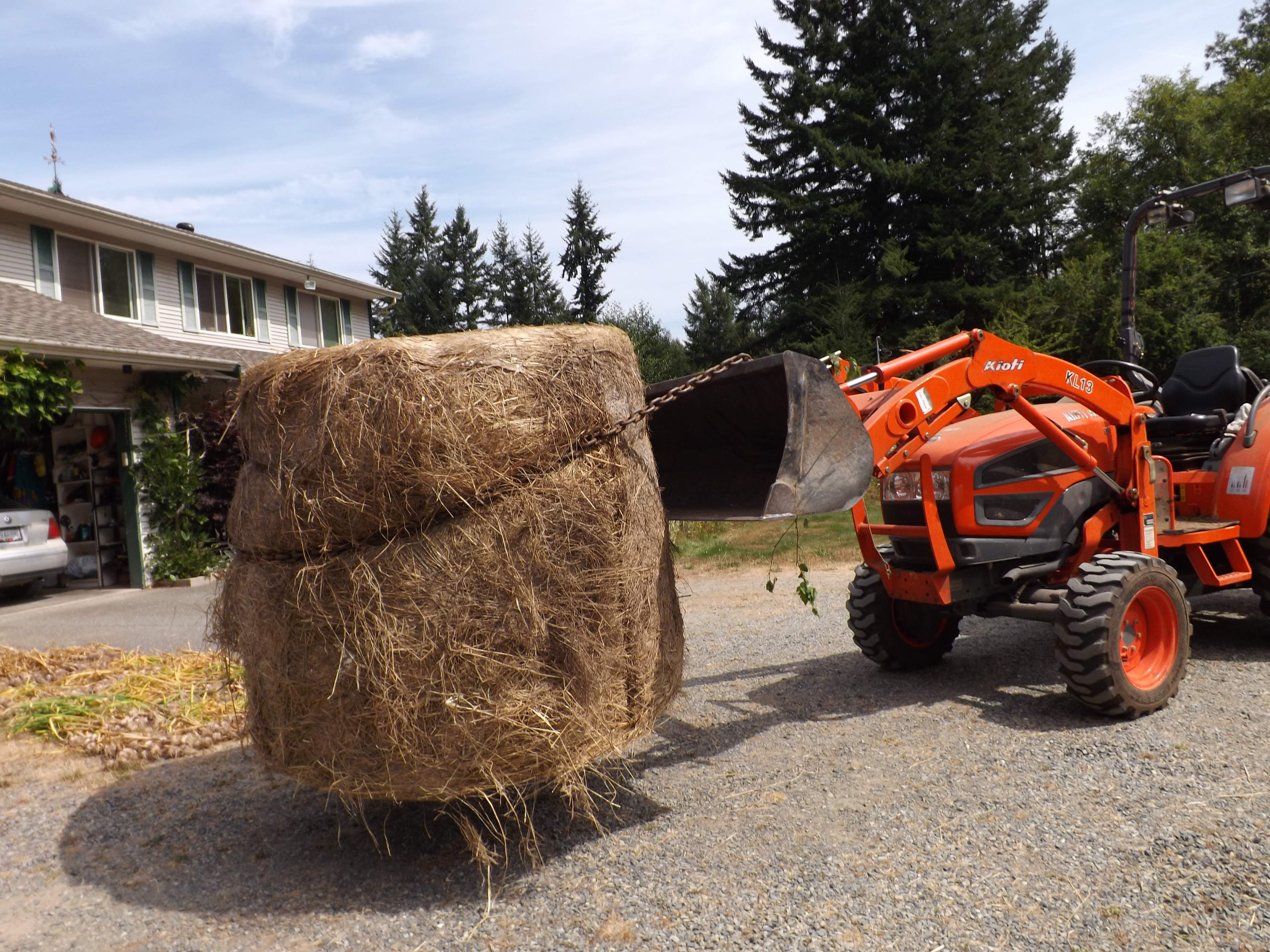

Bought my CK35 HST complete with a Woods 7ft backhoe just over 4 years ago.
Have 423 hours on it. Other than several minor issues that got resolved quickly this has been a great tractor. Both my wife and I just love it and would certainly buy another one. :tractor: :cool2: :number1:
