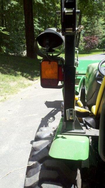

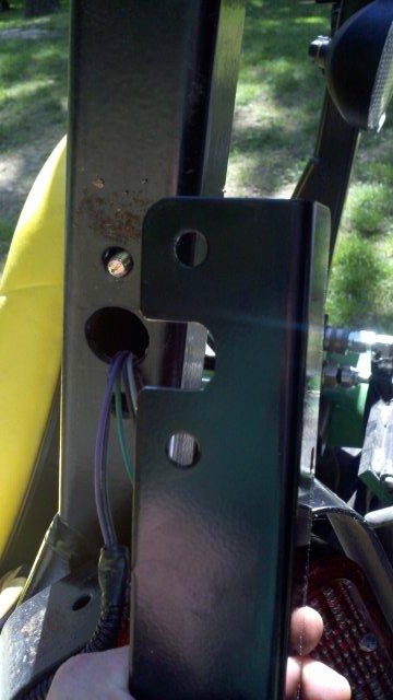

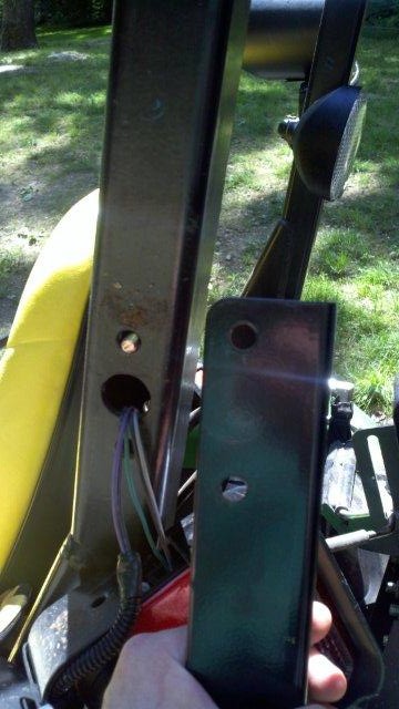

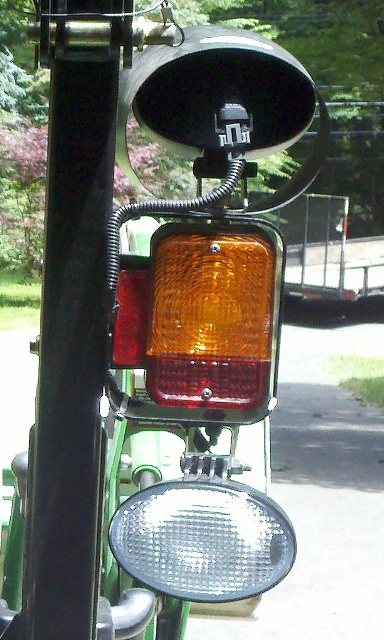

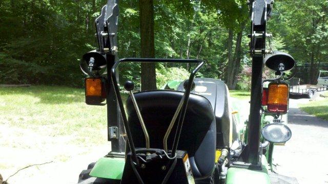

Just a recommendation for those with the 46 hoe, do your elbows a favor and move the SMV (slow moving vehicle) sign bracket to the OUTSIDE of the ROPS bar. You will have to drill/cut the SMV bracket a little bit to allow the work light wiring to pass through (first-to-second photos; third photo is completed). This assumes you have the Deere work lights and brush guards, otherwise it is a simple swap.
Also, if you have the Deere work lights and brush guards, move the rear facing work light to the OUTSIDE of the ROPS bar on the underside of the brush guard, as shown in the fourth image. This will require drilling a 5/16" hole in the brush guard and a ~1" long 5/16 hex head screw and a lock nut. You are also most likely going to have to pull out the wiring for the rear facing light and feed it back in on the other side of the ROPS. A snake makes it much easier.
The operator's station on the 46 hoe is already tight enough as it is without having to endure a smashed elbow (which always seems to happen just at the wrong time). I had taken a "before" photo but when I sent the roll of film out for developing :laughing:, the picture didn't come out for some reason.
