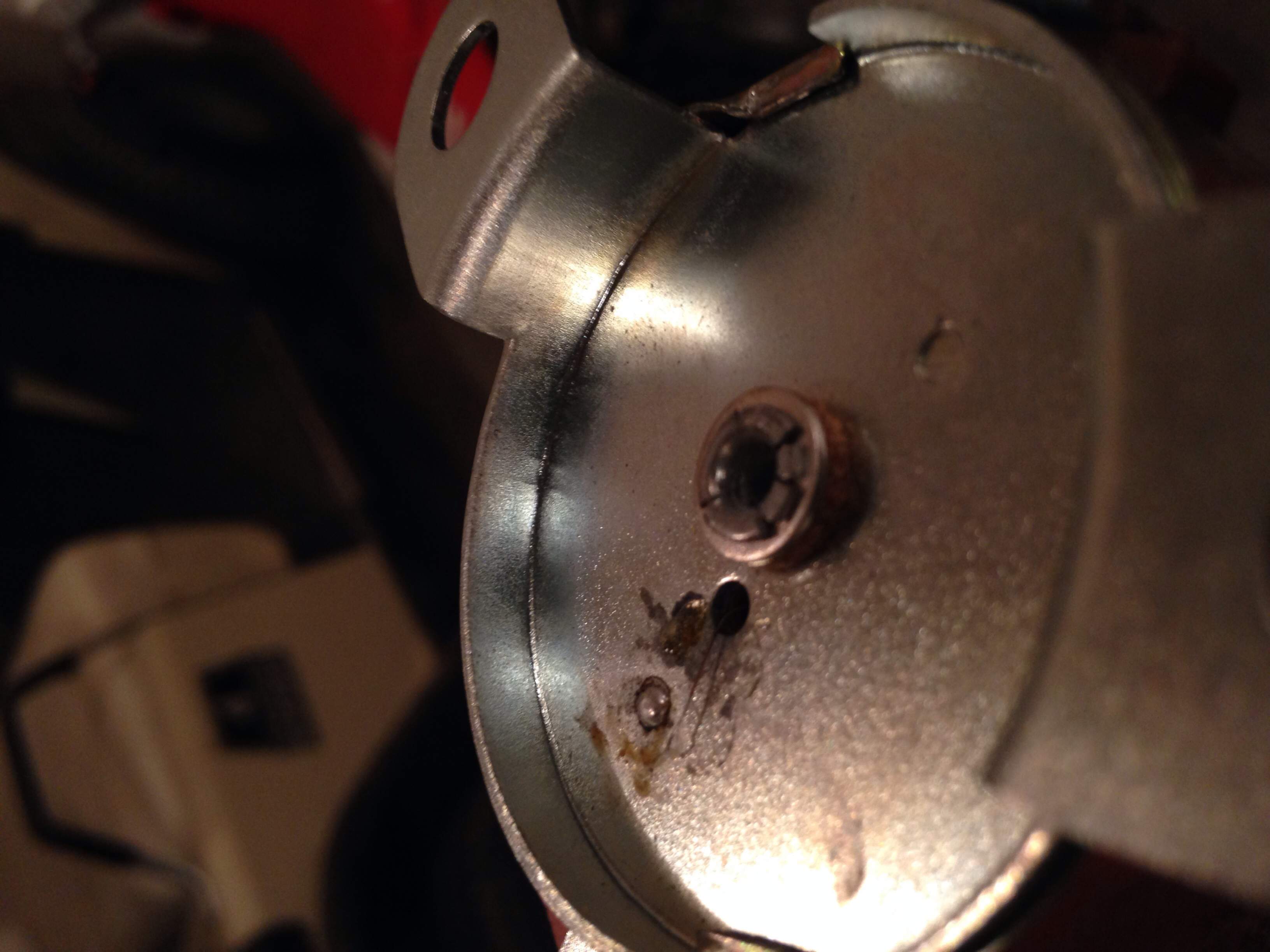

hi all I purchased a new generator and cutout relay for my 2n. I have a question about the relay when I got it today I looked it over and on the back is a small hole with a tiny half inch long bare copper wire sticking out and there is a dab of solder nearby the hole. I think the wire should be attached there but I am not sure. Anyone know if I should solder it on if it does go there.
I would take it back but it came via mail from Washington today as my local tractor supply does not stock these cut outs.
I am not sure my original cutout is bad but given my generator armature is cooked I suspect the cutout is bad.
Tried to attach a picture hope it works.

run it as is.

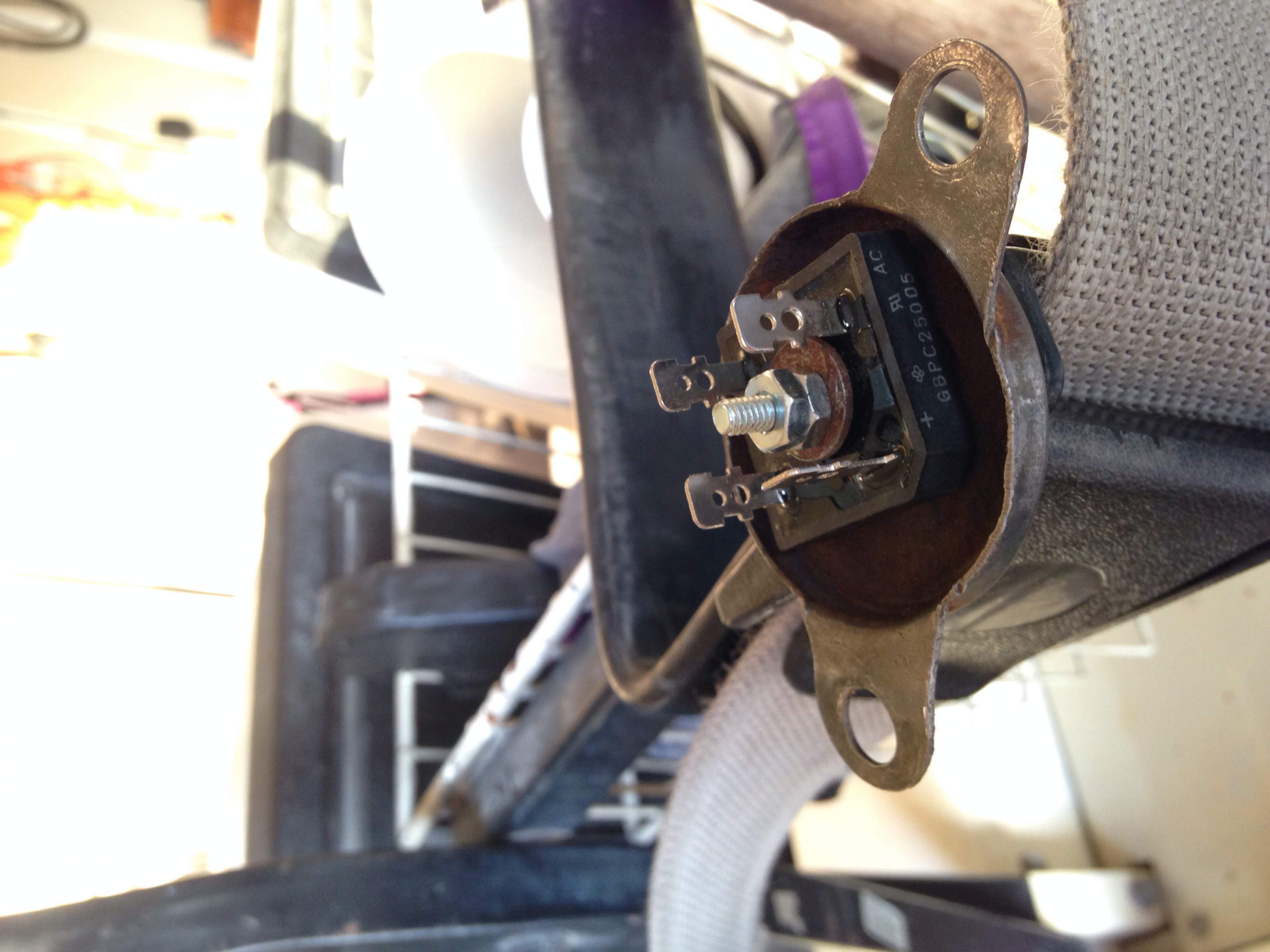

Had some time tonight the old can was rusted together pretty good but I got it removed without destroying it.
Even with that picture I am a little confused on the wiring. The terminal closest to the + goes to the armature?
I took a picture of the gizmo I mounted in there. My wife threw the package away..... In my pic the bottom terminal is the + then left right and top terminal.

Oh good grief I see I mounted it on the bottom if the can.:confused3: I will fix that now.
/ 2N cutout relay #18
the one marked + goes to the armature.
then you have 2 marked AC, wire those together, and run that to your battery connection ( start switch hot.. etc... )
wired like that you have multiple times the capacity of the generator.
once connected up. put a meter on the battery and adjust for a charge voltage at normal operating rpm of about 7.2v or looking at your ammeter.. about a 3a charge when running.
this assumes you are still 6v positive ground.

Yep still 6 volt ground I had time today to fiddle with it. Got it all done and it is working you would never know it is not original by looking at it. Thanks again for the help.
