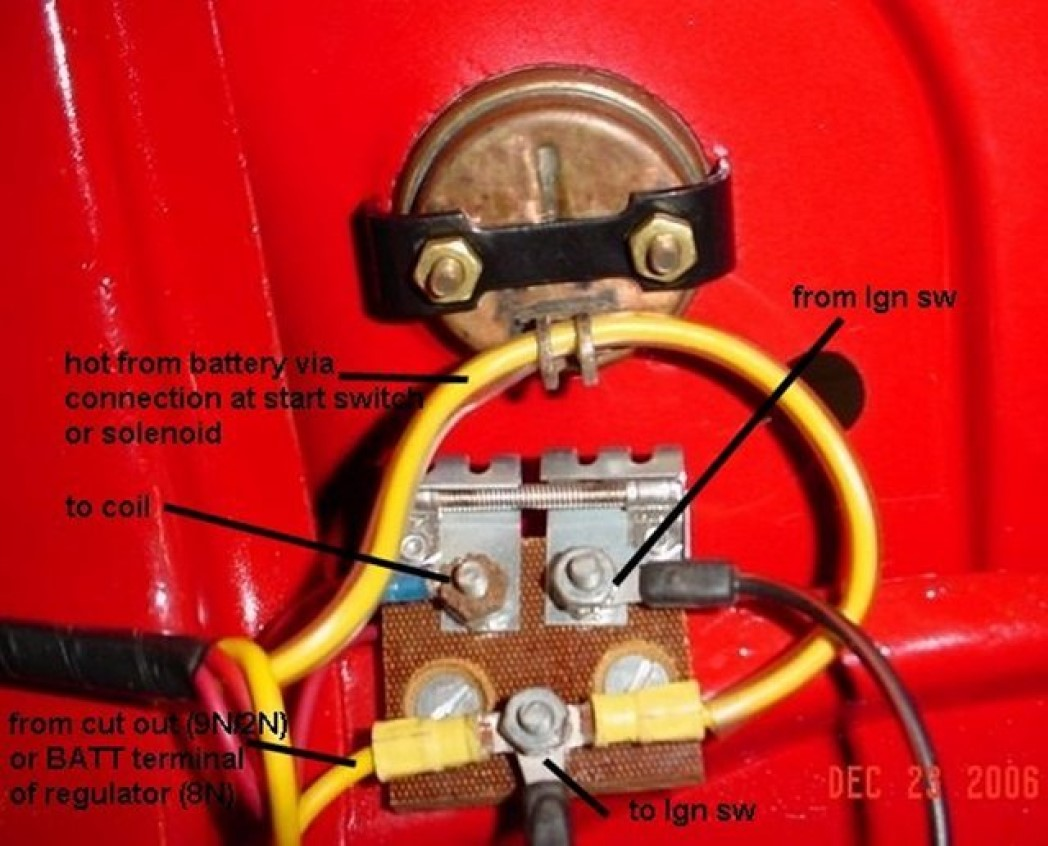

Your symptoms would typically indicate a bad coil. I have a TSC near me but I buy my ignition parts from my local Napa auto parts place and have had good luck with them. Does your wiring look like this:

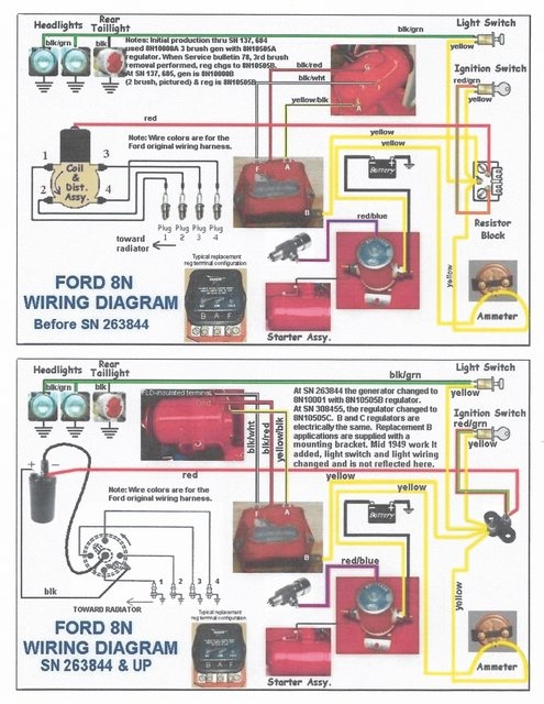

Have you checked your firing order (1,2,4,3), plug wires, cap and rotor, points and condenser?
More times than I can count. And that diagram is not what I have now that it has a generator /cutout installed. Although its pretty close, there is no wire to the VR tab since there is no VR, and the ammeter is electrical vice induction? so it has 2 wires. Haven't had a chance to do anything yet this weekend. Skydiving today and a coin collecting show tomorrow. But I'll have a labeled photo Monday. Wiring looks correct, still leaning towards a weak coil.

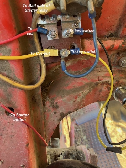

Back at again. Installed the new coil. Started good, sounded good. After about 20 minutes, I could here it occasionally missing and another 5 minutes it was definitely missing and starting to run a bit rough. Shut it off, checked spark and it barely had spark. I jumped the resistor so as to get more spark and it started. I disconnected the jumper since I didn't want to damage the points or the coil and limped it back. It was still running rough when I parked it. I started it after about 30 minutes of cooling and it ran better but was still missing a bit. Checked voltage at the coil, 6V with the key off, 2.5-3 with the key on and points closed. Checked voltage (while running) across the cut-out and it was 6.5-6.7? Verified the wiring is exactly like E Goodings pic above. Resistor reads .9? Totally confused.

Do you have another resistor (maybe white, ceramic, rectangle in shape) in the coil wire from your ballast resistor attached to your dash panel to your coil?

No, not that I've seen. Isn't that for a 12V system? Unless its in the cutout box itself.

Yes, you would only need the extra resistor if you converted to 12v and kept your 6v coil installed. It would not be in your cutout, only the wire to your coil. Your cutout is irrelevant here. It is part of your charging circuit and your problem is in your ignition circuit. If your battery is being charged with the engine running, then you can discount the cutout and generator as part of your issue.
Do you know how old the ballast resistor is on your 8N? Perhaps that is malfunctioning and messing the voltage up enough to impact your coil? You could take a voltage reading on it with your engine fully warmed up but running right, and then do it again when the engine starts running badly. Should answer the question about your ballast resistor being bad. If you need a new resistor, it is $8 from Just 8Ns: 9N12250-9N12250 Years:1939-50 Resistor Only (No Mounting Blo or you can get the full unit with the mounting block for $22.
